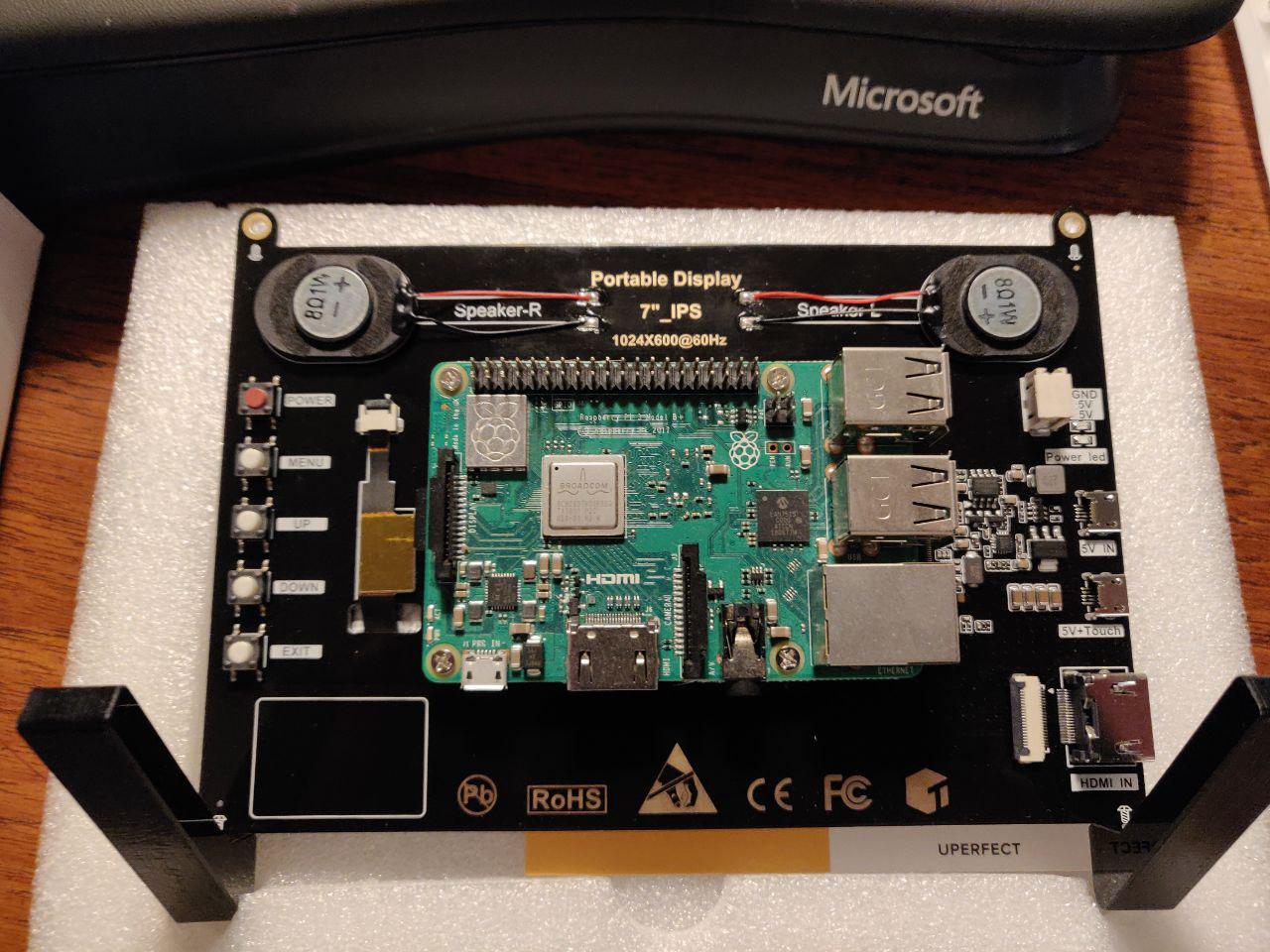

    First step: a Raspberry Pi 3 screwed on to a 7" touchscreen. Using a version 3 here rather than the new version 4 because the 4 has micro-HDMI output, and I don't have a micro-HDMI cable to hand.

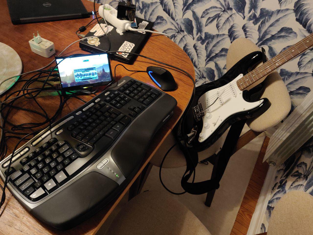

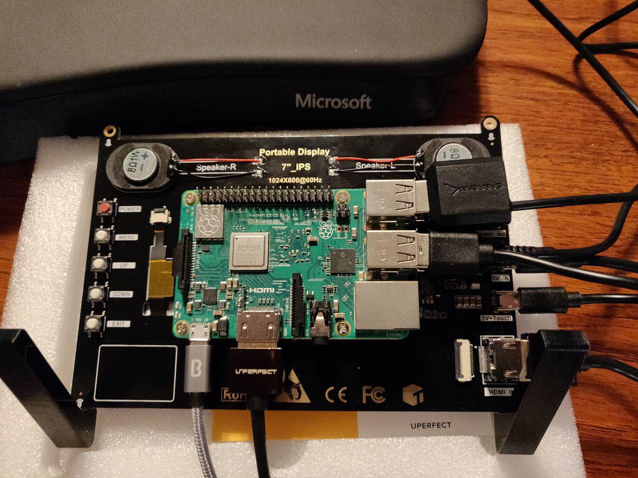

    Next, plug everything together. A total rat's nest. Note that the sound card (top right) is at a bit of a funny angle. It works fine despite that, but it's not an acceptable long-term solution:

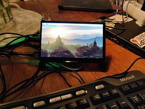

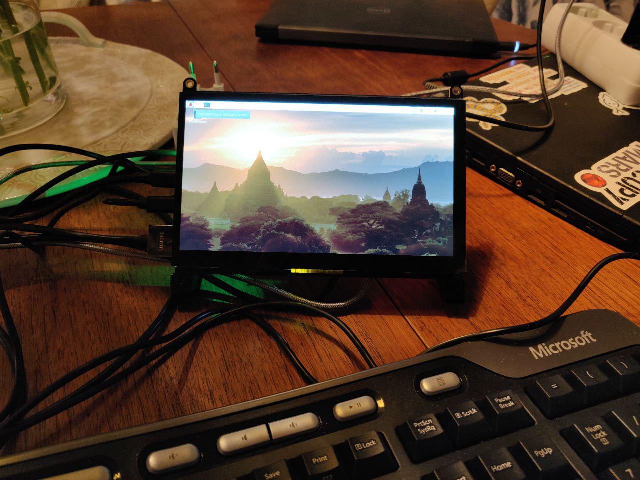

    Power on and boot test. Works fine, no magic smoke escaping from the hardware... touch screen works out of the box, so I can unplug the mouse (which means that the jammed-together USB stuff will no longer be an issue):
