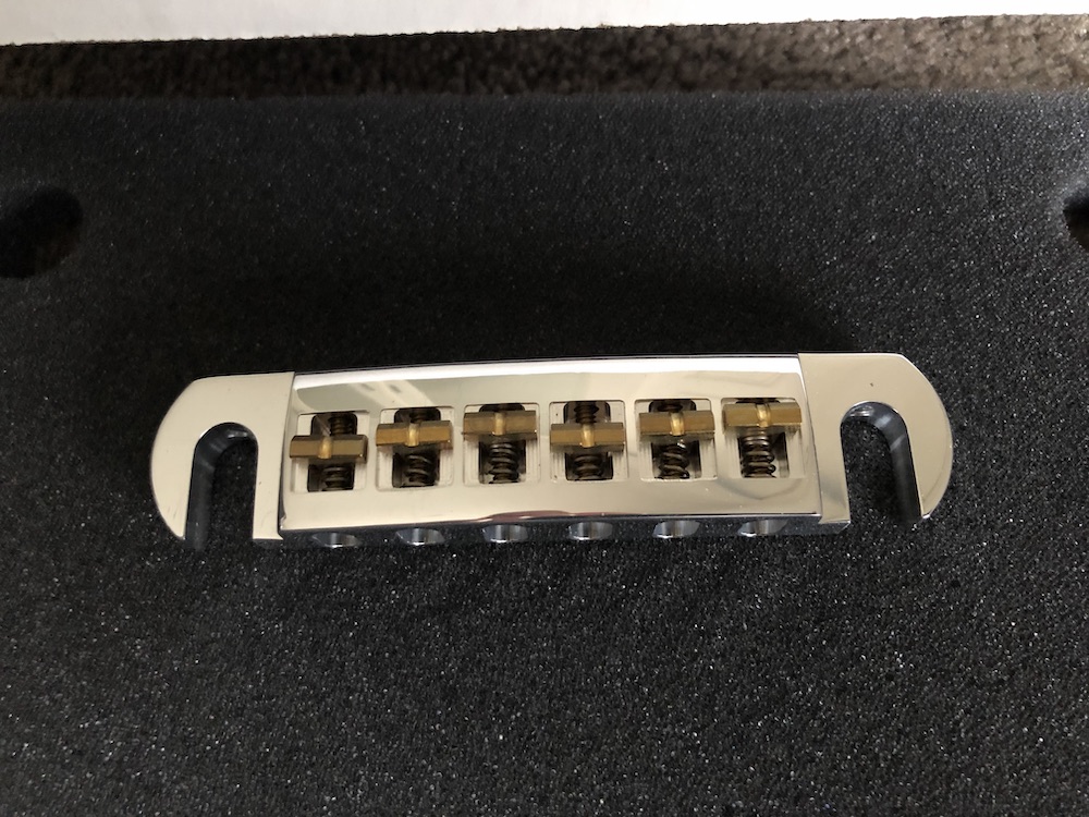

    Cool, thanks McCreed. I actually like the look of being on an angle but it has to make sense of course. I've added a pic of the bridge, there is 10mm of saddle movement but 2mm thickness so 7mm of adjustment room (plus the grub screws).
