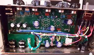

    Hi all, been a while since I've posted here, but always looking at the many builds and threads.
    I have a small 15watt tube amp which has been great until it stopped working. No sound
    the tubes are 2 - 12ax7 and 2 - EL84's - amp =(Stauss SV TNTB chinese make)
    The amp powers up and the tubes all glow ( I have noticed that one of the 12ax7's glows on one side only. I belive there are 2 filiments in each tube and this is possibly the problem)
    I have checked the fuses which appear good.
    I have some mesa boogie tubes on the way both the 12ax7 and el84.
    Now I have learned a little about the need to 'bias; the tubes correctly.
    It's probable that this amp is cathode biased meaning i can change tubes easily.. I think
    My main question is can any of the amp gurus establish if my amp is actually cathode biased from the photo below?
    If both of the cathode pins of the two EL84 power tubes are tied to ground via a 5W resistor (of at least a couple of hundred ohms in value), then it's highly likely that the amp uses cathode-biased power tubes, it's even more likely if there's a single HT winding on the power transformer with no 50V -V Grid Bias tap for the power tubes.
    See if you can find a schematic for the amp on the internet.
  3. Liked by: Guvna19
    Member Guvna19's Avatar
    Mar 2017
    Adelaide
    343
    Thanks for the rply Doc !
    I must admit to having no real knowlege of what Im looking for.
    I was at least wise enough to drain all the power and took great care when taking some photos of the internals
    I may need to find a local tech even if it turns out to be an easy job.
    Im unsure if i can just drop news tubes in or not.. me thinks probally not
    Regards Gavin
    Mentor Marcel's Avatar
    Apr 2017
    Bouldercombe Qld.
    1,168
    On amps of that size it is typical that you can just pop the tubes in and be done with it..If the designers were concerned they will usually install a pot so the bias can be adjusted, or have relatively easy access to the cathode bias resistor or grid bias resistors. With a pot you just need a multimeter and a adjustment tool, but changing cathode or grid bias resistors should be done by a trained tech. Swapping the 12AX7's will always be fine, and swapping out the EL84's should not pose an issue however if you are concerned then do it anyway and at some stage down the track take it to a tech and have him check it over.
    What concerns me is that it is not producing sound, and you describe one of the filaments in one 12AX7 not glowing. Before doing too much else I'd be replacing that 12AX7 and see what happens. In near all current day uses of 12AX7's they employ cathode bias and can be swapped out as required with nil re-biasing needed.
  6. Liked by: Guvna19

    Looking at the configuration of the amp, I'd guess that it's a direct copy of the original Vox Night Train NT15 head (though with their own circuit board layout). Do a web search and you will be able to download a copy of the circuit diagram for it e.g. https://elektrotanya.com/vox_night_t...wnload.html#dl
    No adjustable bias as far as I can see on the power valves.
