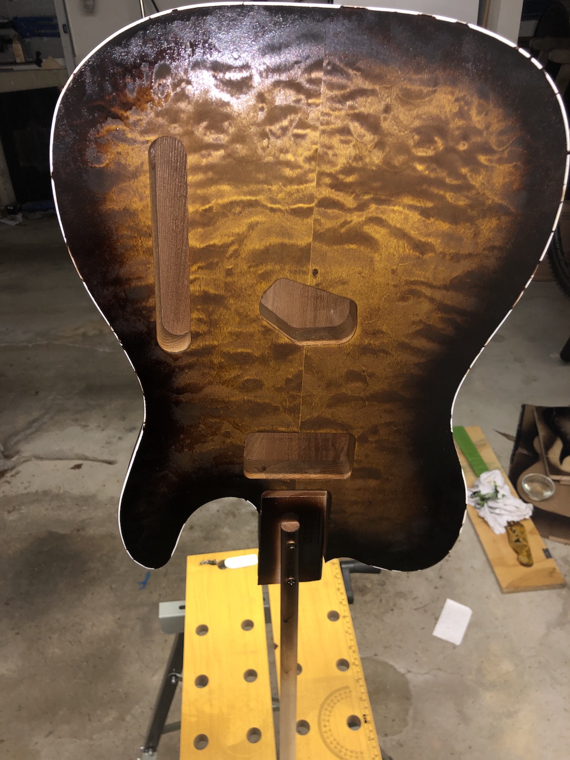

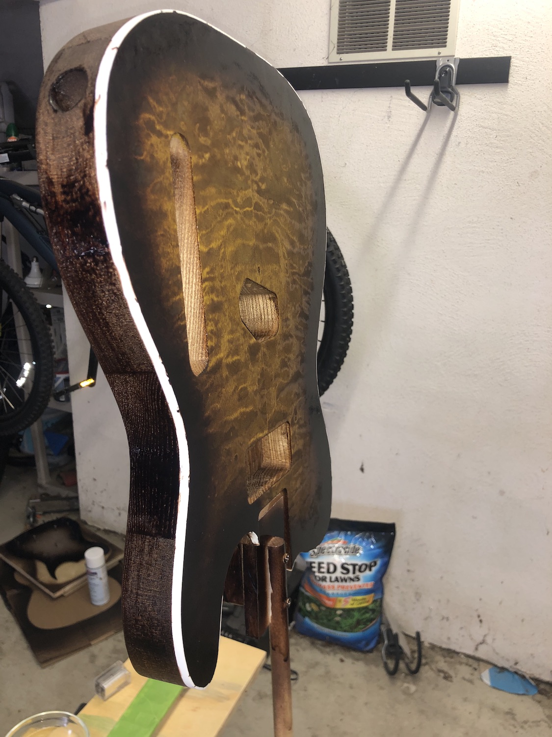

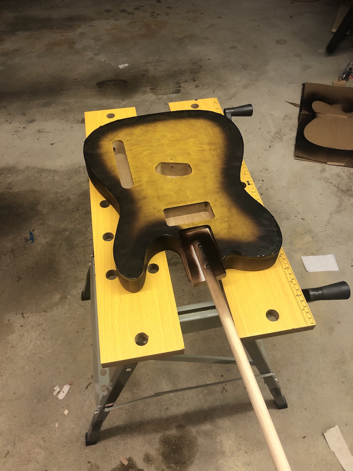

    Hi All,
    I am a complete newbie when it comes to finishing wood (and guitars). I have started with an ambitious project, because I am a glutton for punishment . I am going to try to turn my TLA-1Q into a tuff-dog esqe Tele. My goal is a tobacco burst on the quilt top. I have purchased Keda dyes as well as Mohawk Black lacquer and Clear Stringed Instrument Lacquer. My plan is this...
    1. Use Terps to find glue marks
    2. Use goof off and a tooth brush to remove glue
    3. Dye with black Keda
    4. Hand Sand back as little as possible to highlight the quilt
    5. Dye entire top with Amber Keda (which I will create by mixing yellow and orange keda dye).
    6. Let dry
    7. Tape off and paint back and sides with black lacquer
    7. Cover top with tear shaped cardboard lifted with toothpicks to raise the edges a bit and spray outward with black lacquer to create a feathered burst.
    8. Let dry and use clear lacquer on face sides and back to apply several coats
    9. Sand with increasing grit sandpaper to polish clear coat.
    10. Compound wax, etc.
    Question: Will the black lacquer be noticeably higher than the dyed center? Am I better off hand rubbing the burst?

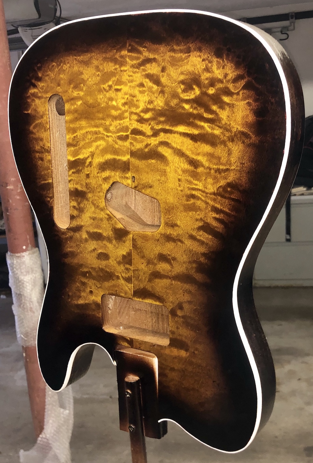

    You can only give it a try and see how it goes....
    However...

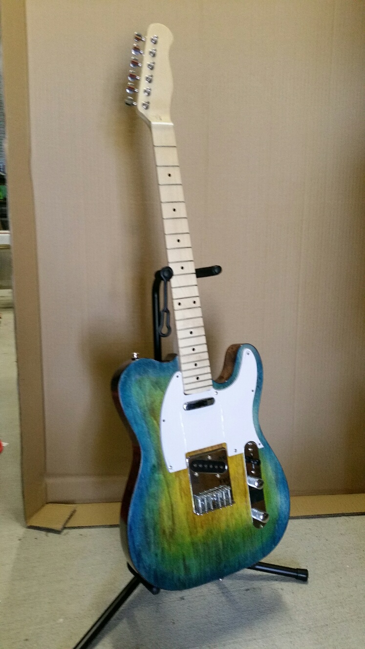

    Watch carefully with the Keda dyes... When putting your black layer down be sure to wipe as much excess off before it dries, as any loose dye will re-animate in your lighter Yellow/Orange application stage and contaminate it with unwanted Black. Keda dyes don't become fixed until after your clear coat goes down. Before that they easily redissolve into the next colour stage....
    About the only success I've had in doing similar to what you're planning is by just pouring the Yellow layer on and dabbing (instead of rubbing) it to a dryer state. Rubbing (as is recommended) will definitely dislodge any Black dye underneath.
    A mid build pic of my rainbow Tele from years ago (one of my earliest builds) shows just how messy mixing only Yellow and Blue Keda dyes can get....
    Good luck.

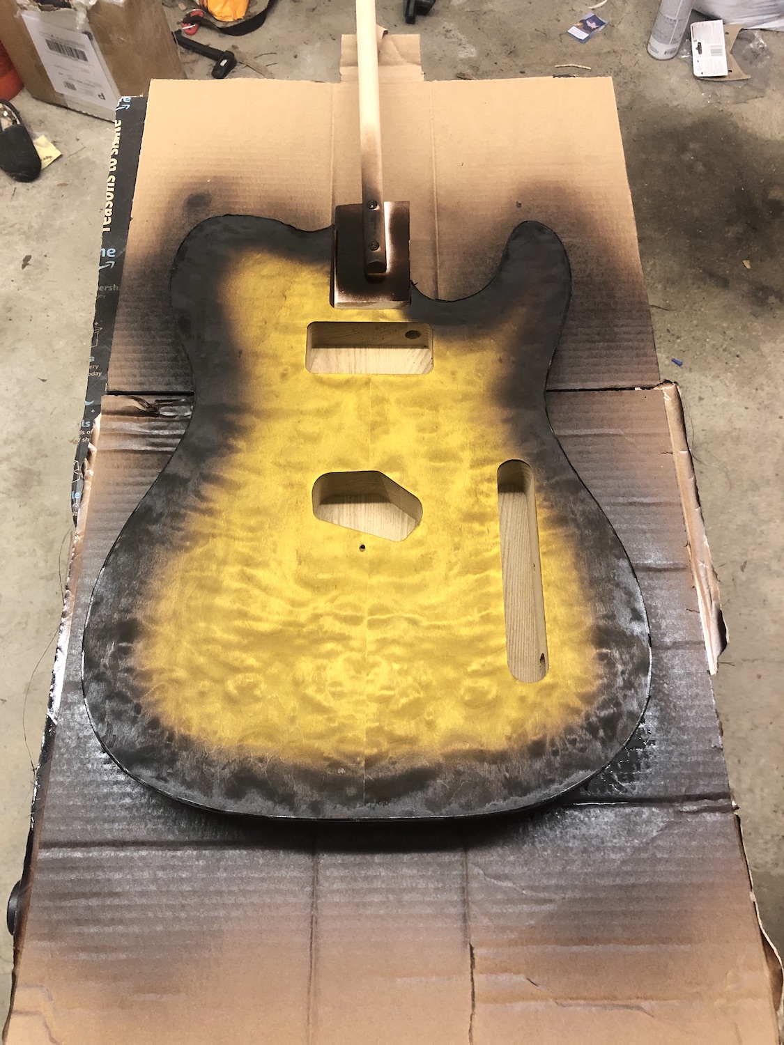

    The very best way to do a burst is spray it. Whilst not impossible, it is very hard indeed to do a graduated burst just by staining.
    When spraying, you don't cover up the middle of the guitar otherwise you'll end up with hard edges in the finish. You simply hold the spray gun or can over the centre of the guitar and spray out towards the edge. Exactly where will depend on the width of the spray cone, so try out on some cardboard templates first. Start by aiming just beyond the edge of the body. The graduation is simply done by the edge of the spray cone, which has far less paint than the centre.
    You'll find that dark finishes get darker as they dry, so don't be tempted to go in too heavily to begin with. Much better to do two two three lighter coats than one really heavy coat (which is more liable to run).
    It's good to be able to rotate the body whist spraying. I spray with the body flat and use a turntable (made from a Lazy Susan) but I've also used a piece of cardboard underneath the body (generally necessary anyway when spraying flat to raise the edges off the surface). This allows the body to be easily spun around, which means that you can stay in the same place.
    If you want to fully copy a Tuff Dog, note that the burst isn't a teardrop shape (like on most Gibsons) but follows the outline of the body by 30mm or so.
