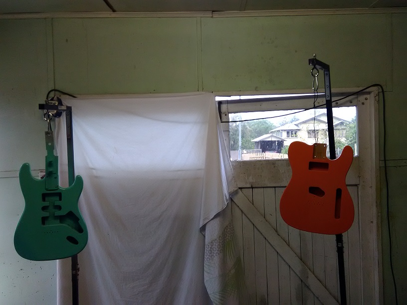

    I have a stand for painting that is sturdy enough (so far haha), but i might run a chain to the roof just incase.

    Yes the strongest one has a heavy duty umbrella stand as a base, ways a ton :P
