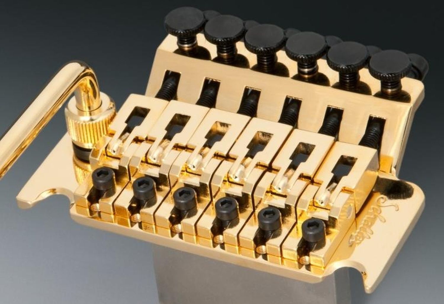

    Been thinking of doing something really radical with my Strat and changing out the stock trem for a Floyd Rose Trem system, so far all the nuts I have tried have had some issues, the one that's currently on my Strat neck makes the high E-String buzz like a Sitar a bit.
    By doing some testing last night, I found that a Schaller R3 Locking Nut will fit on the neck of my Strat, the width is about right and the Radius machined into the nut about matches the fretboard Radius, I can either install a Chrome Schaller Lockmeister Floyd Rose Trem, or a Gold Gotoh Floyd Rose Trem, I might go with the Chrome Schaller Lockmeister Trem, yes I do realize that installing a Floyd Rose Trem is a one-way mod, but as it is the guitar is not that useable with tuning stability issues and Sitar Buzzing on the high E-String.
    I might do some thinking about it first.
  9. #929
    2,079
    Never fitted a floyd rose trem so can't comment Doc.Ref sitar sound. This has happened to me early on if I'd cut the nut slots slightly too deep, or slots have been a little tight for gauge of string,another thing to check is if your string trees are low enough behind the nut.
  10. #930
    Have checked that, on the stock plastic nut and the bone nuts, all the nut slots were a bit too tight for the strings I was using, also from what I could work out, the Sitar Buzzing seemed to be caused by the way the string sat on the bottom of the nut slots, plus, some of the strings have a very slight sideways kink to them on their way to the tuners.
    I did some experimenting with the position of the B and E string-tree before installing it, moving it towards the nut or away from it varied the break-angle over the nut but didn't do anything to fix the Sitar-buzzing, it wasn't due to the string slots being cut too deep because I checked by fretting the string behind the first fret, the Sitar-Buzzing stopped, indicating it definitely was caused by the nut.
    I might just leave the guitar for a while so I can have a good long hard think about installing a Floyd Rose Trem on it, I can still play my LP Studio in the meantime.
    I might get a Gold Schaller Lockmeister Floyd Rose Trem for my Strat, they're a bit more expensive than the Chrome version but I reckon I can get a budget together for it, the Gold Lockmeister Floyd Rose Trem comes with all the mounting hardware needed and also a matching Schaller R2 Locking Nut, which does fit my Strat's neck, here's a pic of the Gold Schaller Lockmeister:
