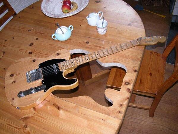

    Lol *eyes 100 year old oak table in dining room*
    5,666
    If I take out a body blank from near the edge...I can claim it’s a hole to install a sewing machine lift to give her more working room for her dress making....that way she can’t be mad right?
    FrankenLab
    That could end up being a very, very expensive scratch built body.

    Hah- from the divorce you mean? To be fair the table has seen better days, its copped a lot of use in the ~40 years its been in the family.
    Apparently oak isn't that great for guitar building anyway....
