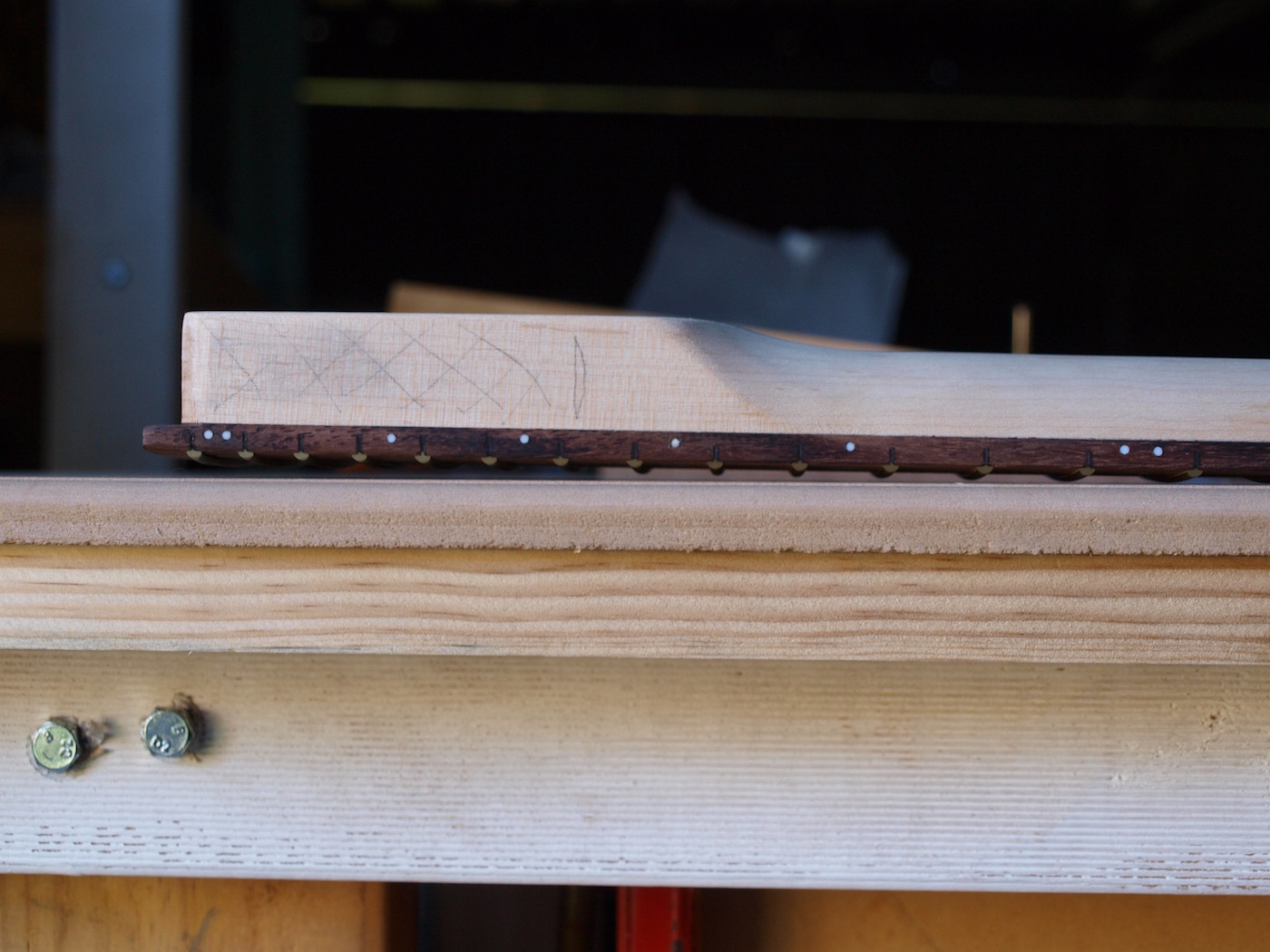

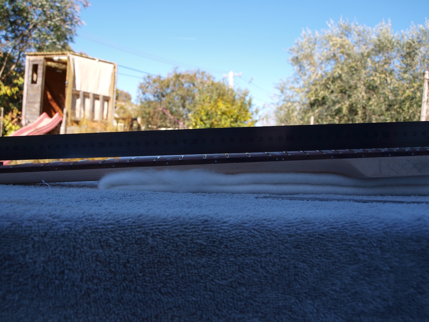

    And 'problem' 2 for the neck. I was checking the frets for level, and the whole neck seems to have quite a pronounced back bend. I know this will change once there are strings on it, pulling it back into level. But should I have the board more level to start with? Is it worth adjusting now, or wait til the strings are on?

    Hey MJG, try putting a bit of thin superglue under the 24th fret where it's not seated and clamp it overnight.
    The neck has way too much forward bow. Turn the truss rod anti clockwise while facing the adjustment socket. You need to get the neck flat for a fret level. When its stringed and tuned up you may need to make further adjustements

    I gave the truss rod a 1/4 turn, that has taken out most of the bow. I'll adjust a tiny bit more tomorrow. Didn't want to overdo it.
    The frets look pretty level now, I can see that I'll have to flatten probably the 12th and 5th by the look of it. They are a little higher than the rest. A job for another day.
