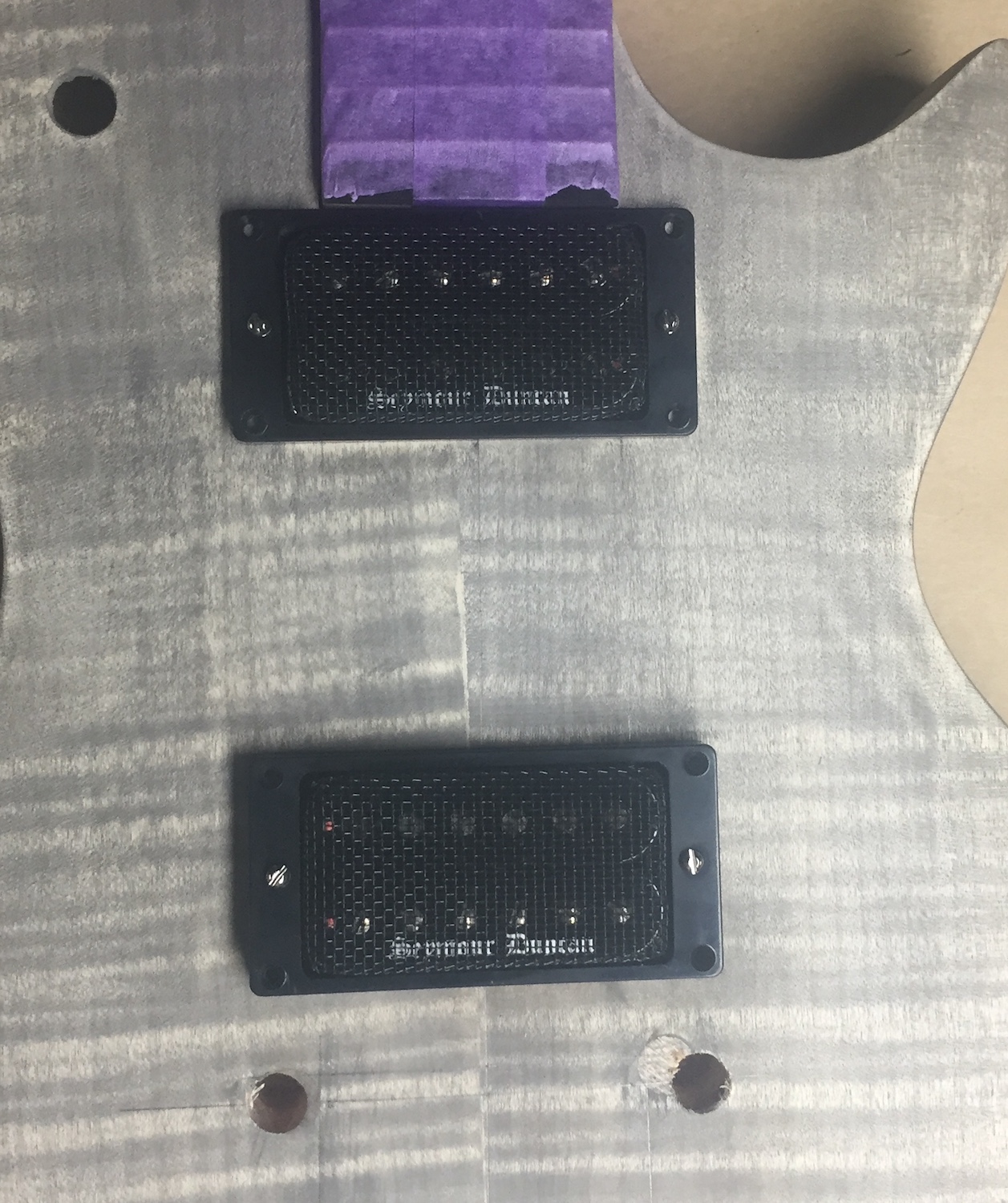

  7. #87
    Fiddle, fiddle, fiddle...
    Just an idea I am playing with. The silver standard adjuster screws are going to get replaced probably with Black low head allen screws sourced from work.
  8. #88
    Hi Frankie, liking the veiled mesh look.
    If you replace the screws you will still have shiny slugs and reckon it looks good enough with the mesh.
    Cheers, Waz
  9. #89
    Cheers, Waz
    I had a plan for that as well Waz, the mrs has a heap of really thin backing fabric in black that I can appropriate some scraps from. This'll go under the mesh to do the full black out.
  10. #90
    Hope it doesn't smother the signal.
    You could maybe use black nail polish to paint them instead.
