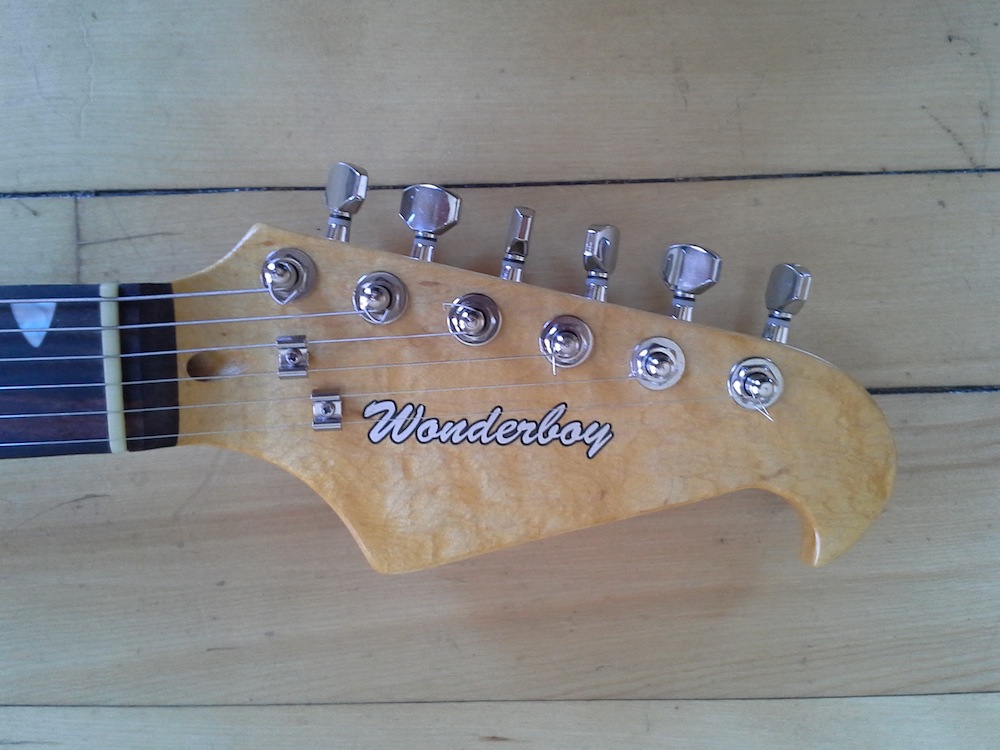

    Wonderboy - done.
    Hey Friends,
    Wonderboy is done. I put a bone nut in, tapped down a rising fret, made some adjustments, and I think we are ready to roll. The guitar has surprising sustain (the tailpiece probably helps), and the pickups are big and warm like a PAF - go figure. I'm happy with the result, and I want to thank everyone for your help and friendship, Adam in particular.

  4. #84
    Wonderful finish to that build, really unique instrument you have crafted.

    That looks gorgeous, Dave! I've got a preference for guitars with a bit of hollow in the body, and never knew of this design before finding this site. I think you've done it proud, with how it's turned out. The colour scheme looks like the beach, in a way. I don't know... I love it.

  6. #86
    Came up a treat! Great work!

    love the colour Dave a very cool axe, how does it sound and play ?
    some pretty cool grain in the headstock and an original shape suits the axe

    That looks great - you going to enter it into the guitar of the month comp?

    Mate what a fantastic build! you gotta be proud of that!

    Love it Dave! I cant go past a tasty semi-hollow guitar, and thinline Tele's in particular. Any chance of a sound demo? The blue really suits the style. How do you find the Chinese tremolo? Great job man!
