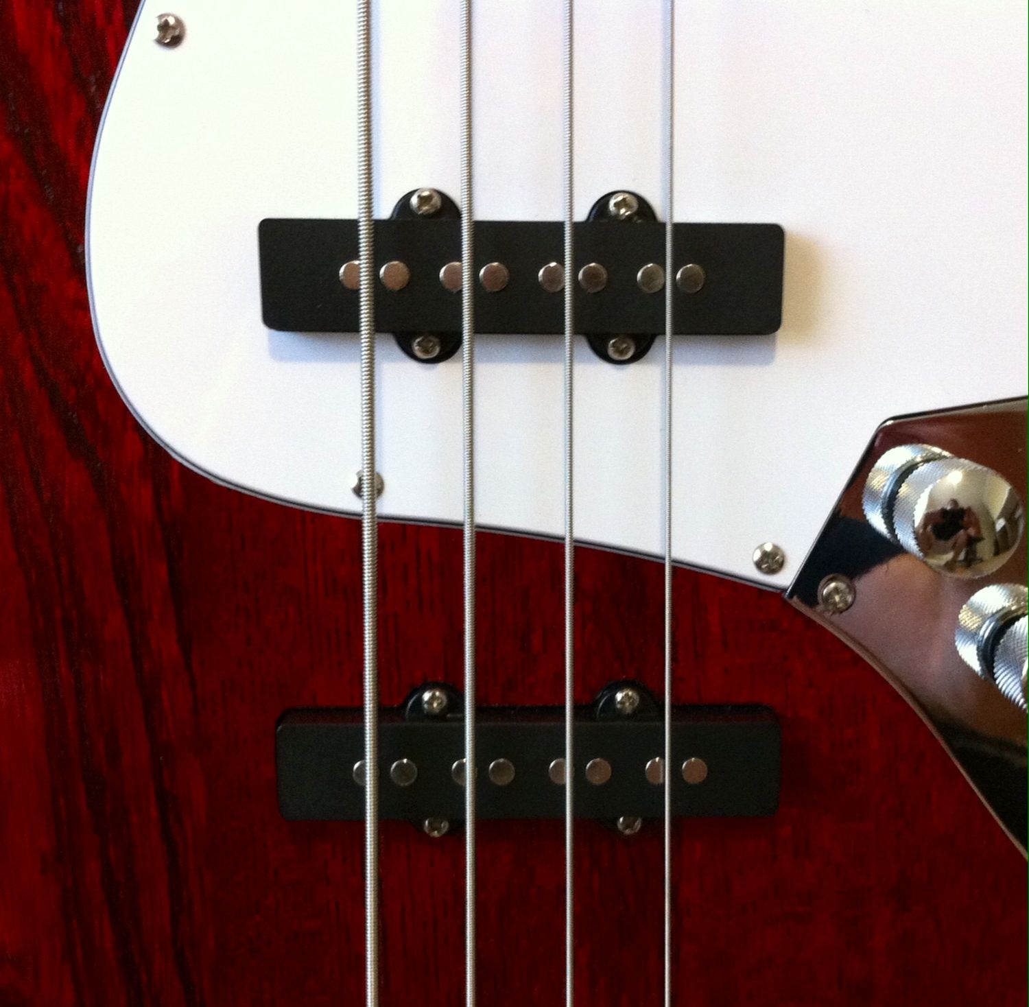

    Finally figured out how to do a half decent video on an iPad and just spent past few hours working out how to invert it as the iPad was upside down! Also took about 1.5 hours uploading on to YouTube.
    The reason for a sound demo was to provide a before and after example........here is the before with the stock Chinese pickups.....

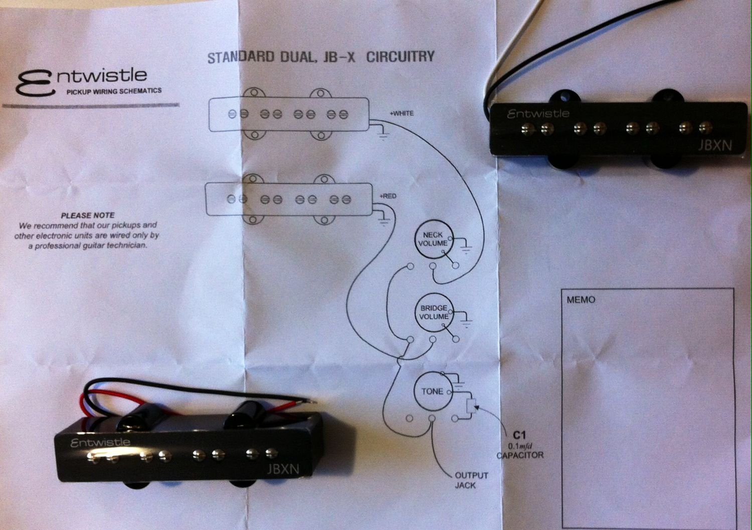

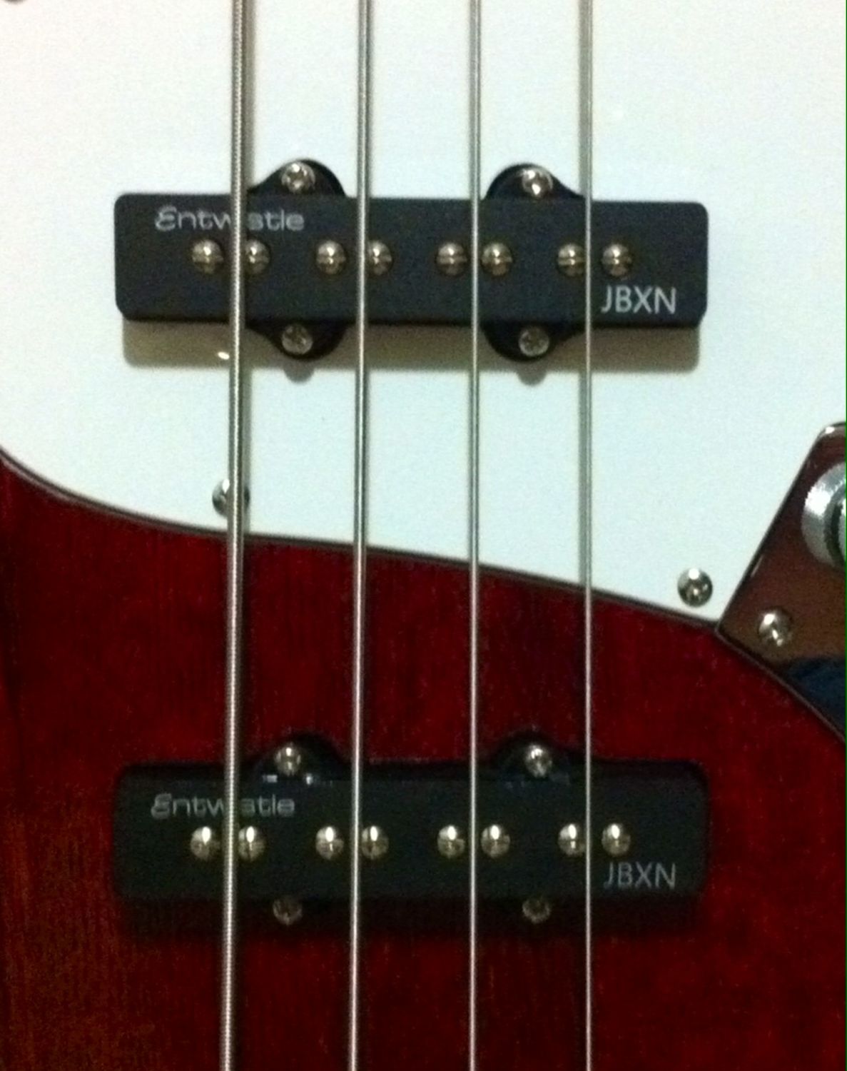

    Fitted some Entwistle JBXN (Neodymium) J Bass PUP's a week ago and just finished off a demo vid this afternoon.
ID:	14028Click image for larger version.
Name:	photo 4(12).jpg
    The neck PUP sounds the best as it is quite meaty yet retaining crisp highs whereas the bridge PUP was mostly brighter overall.

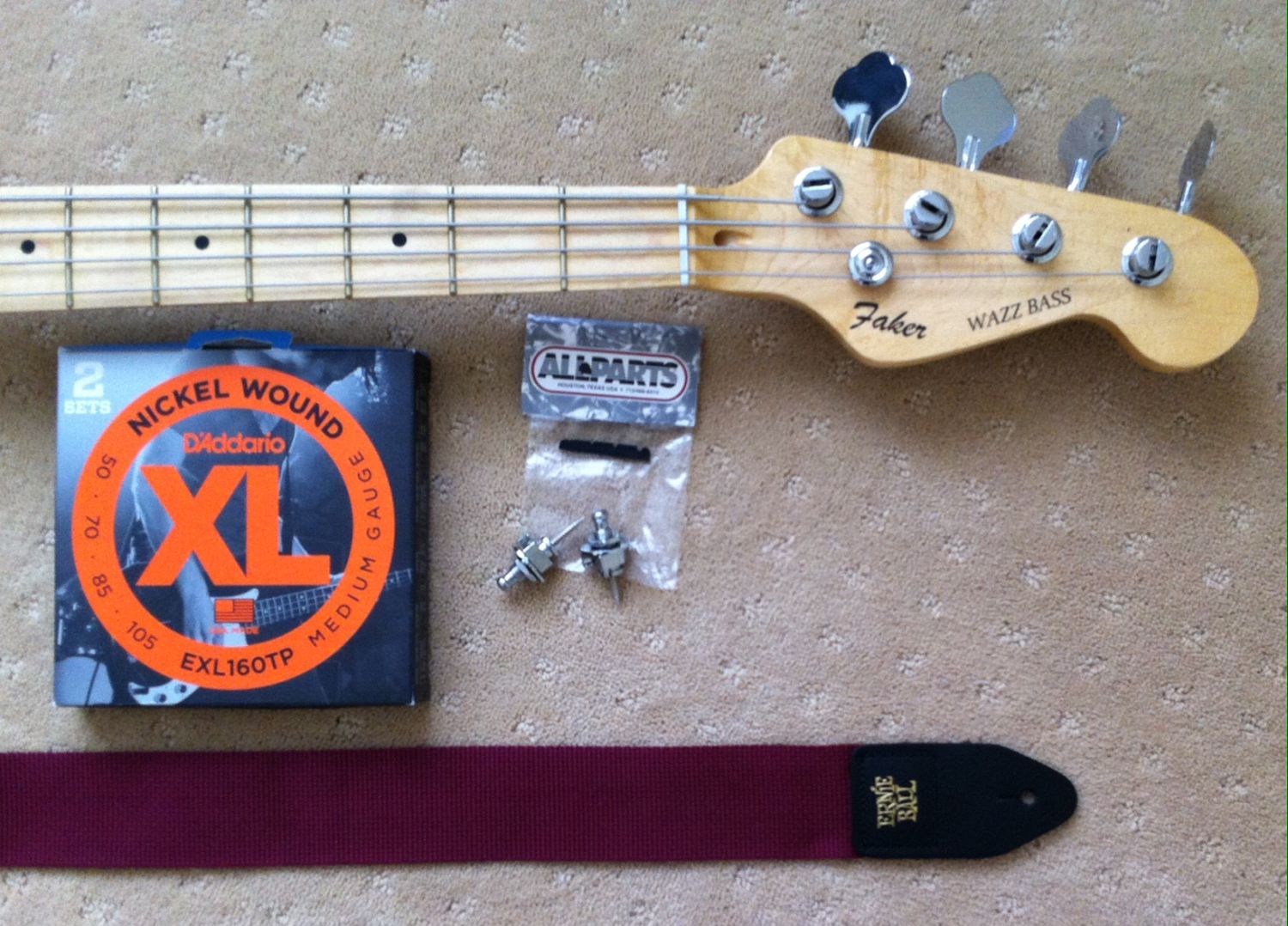

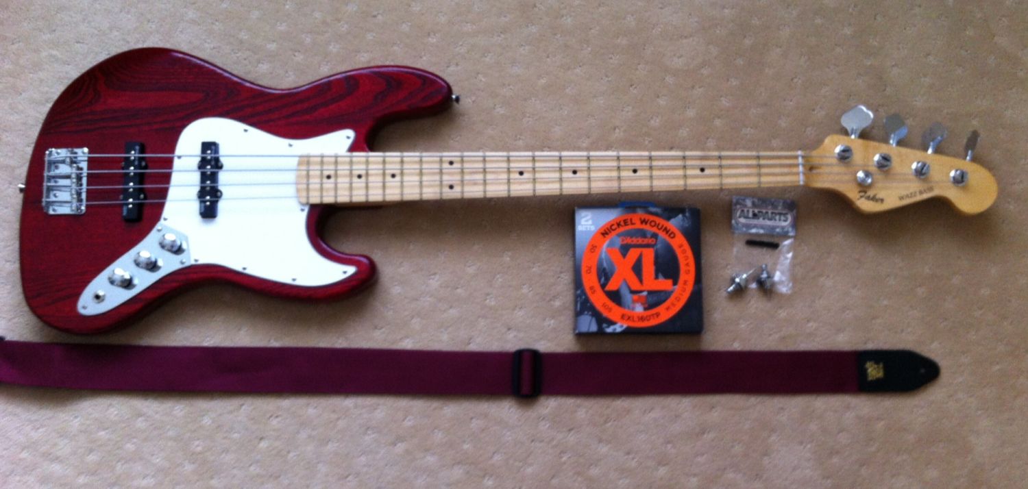

    Fine tuning & tweaking day yesterday.
ID:	15052Click image for larger version.
    Not much required on this build other than new strings, strap locks, and was also going to swap stock nut for a graphite one but once strings were off and having a closer look decided that plastic one could stay for a little while longer until I get a bone one as the graphite nut looked just like a black piece of plastic and probably sounds no better.
    Edit: Decided to go a slightly heavier gauge on the strings, particularly the high G and found the intonation travel not long enough as that saddle had to come a long way forward with the saddle resting above the mounting screws and still a fraction flat of the 12th harmonic. All other strings required a bit of re-intonation but not as much as the G string. May need to swap back to using 0.45 instead or find a suitable replacement bridge which is what I am currently researching.
