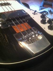

    Well, yesterday i finally give some touches adding a center mahogany veneer (dremel out before) and do some relic work to the top.
    Applied 4 coats of wax and this is what we have at the moment...
    At least the action its pretty good, some little fret buzzing corrected with a twist of the rod. Its ok for me. Lets see what happens until its finally cured, and new strings come up. I need to finish the truss rod cover too.
    More pics will come nearly.

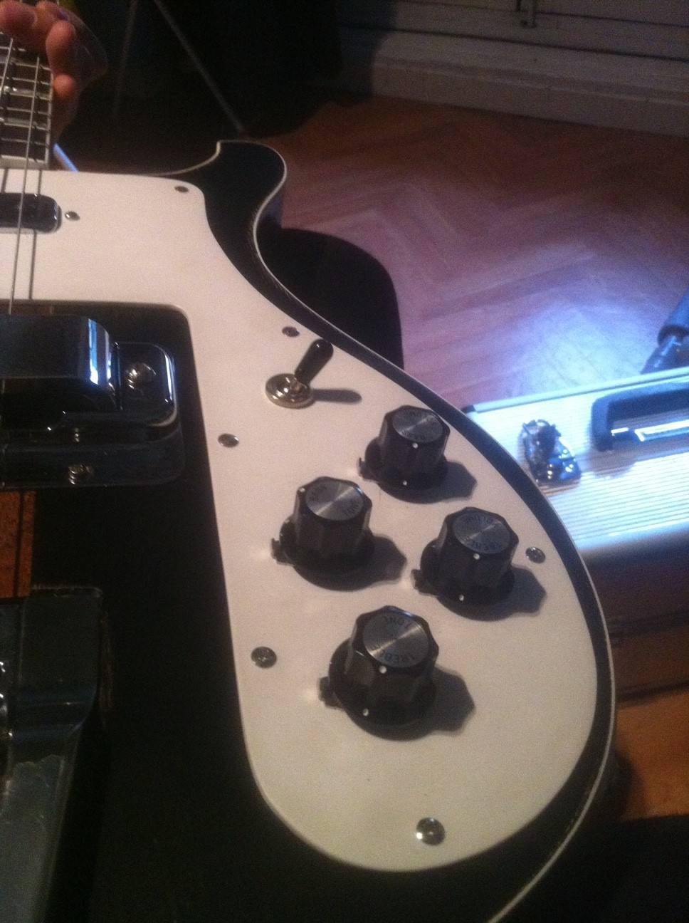

    Yesterday i fix some bleeding from pot volumes when they were turn off, and finally i found it was the hot soldering to jack (i thought it was maybe a bad grounding or disfunctional pot but).. Now, its perfect..sounds pretty much a rickenbacker (as its carrying the rick puppies) even connected to the soundcard of my pc, without any effect, only a minimum compression from the pedalboard.

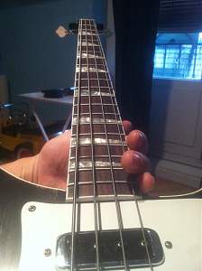

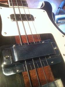

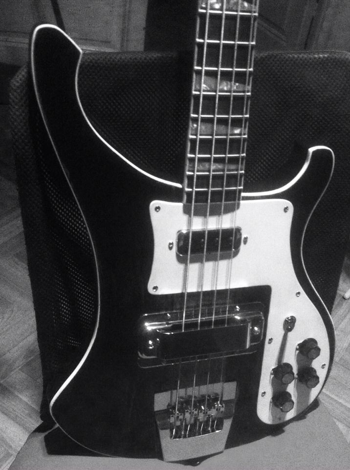

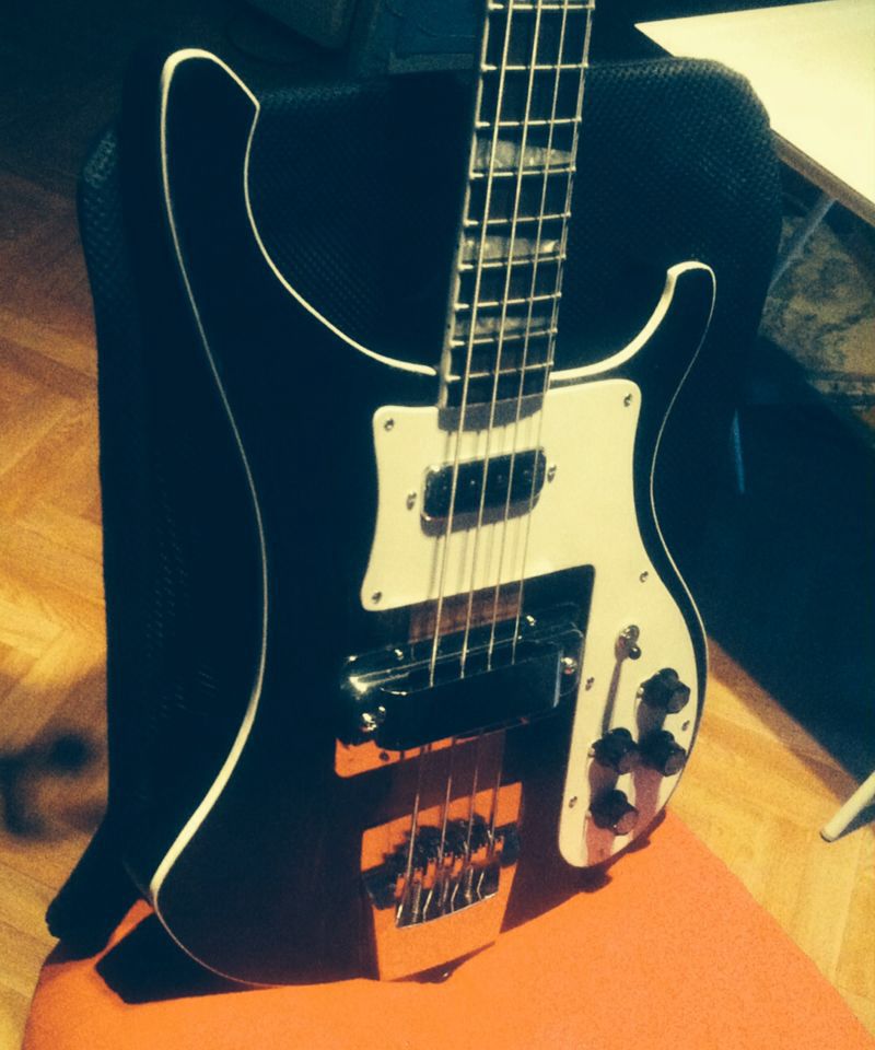

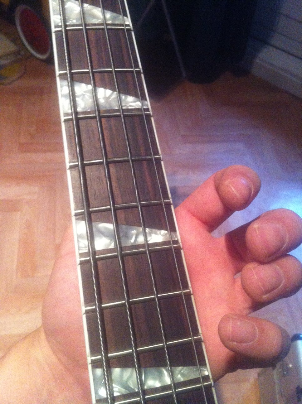

    Some finished pics..Im at the height, trust rods adjustments and first playable testings.
    Around 2,4 mm at 12 fret (E string). Still recording some audios for next upload...
