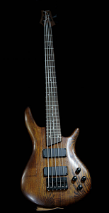

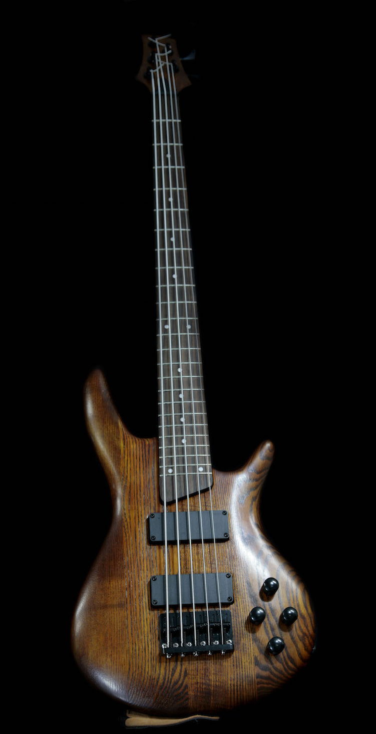

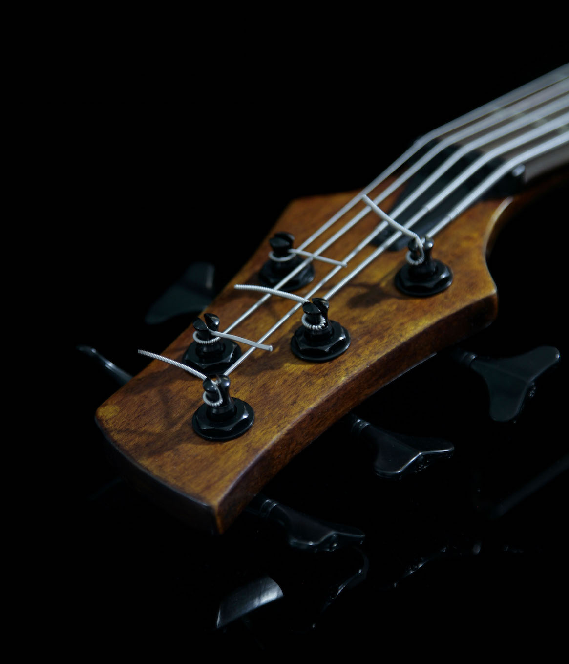

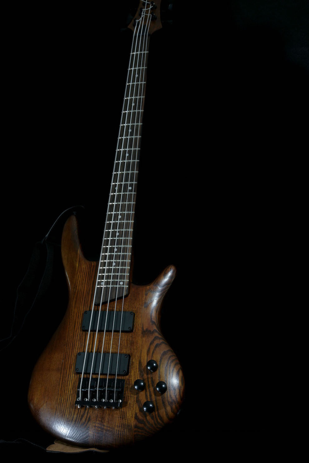

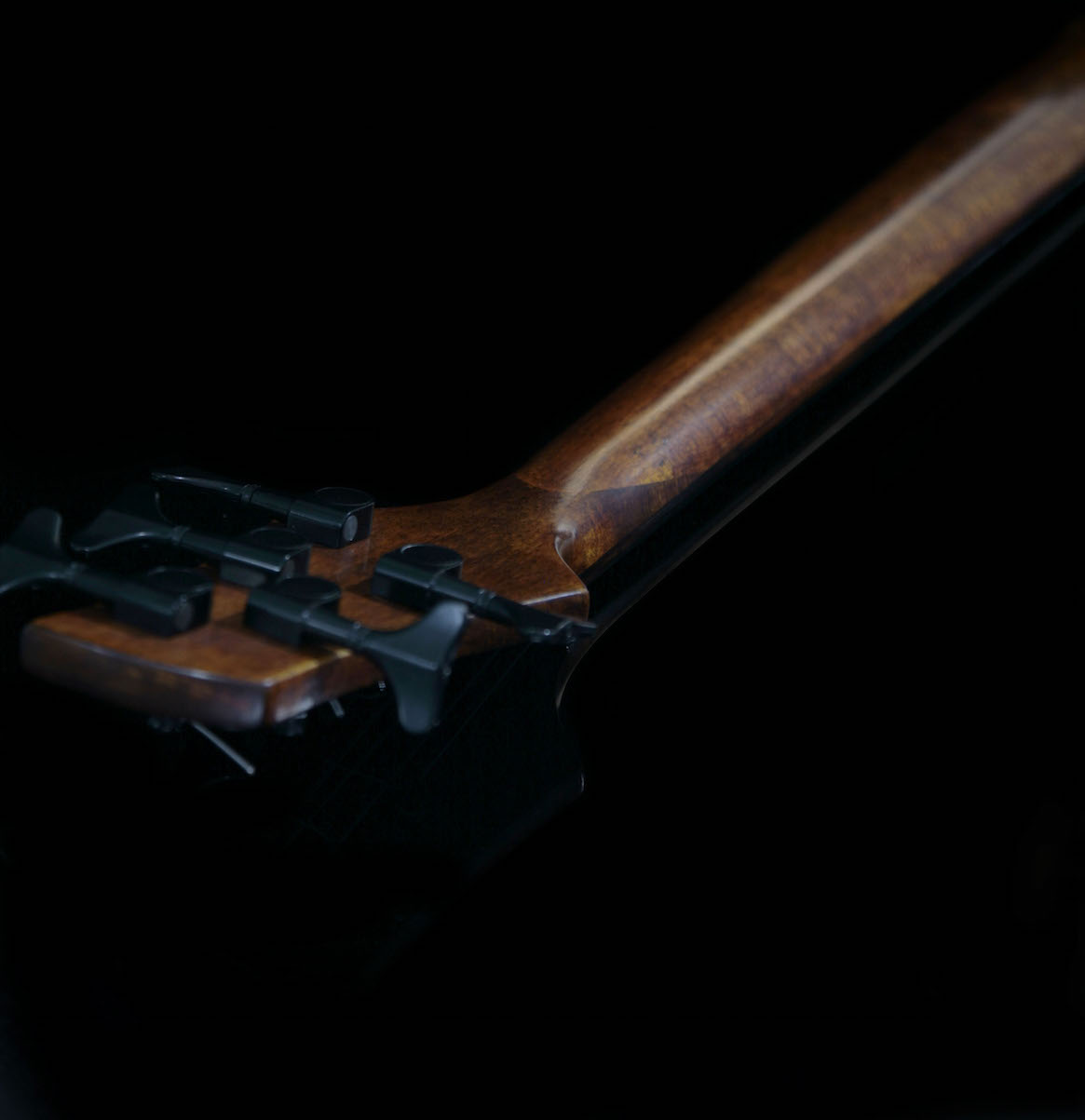

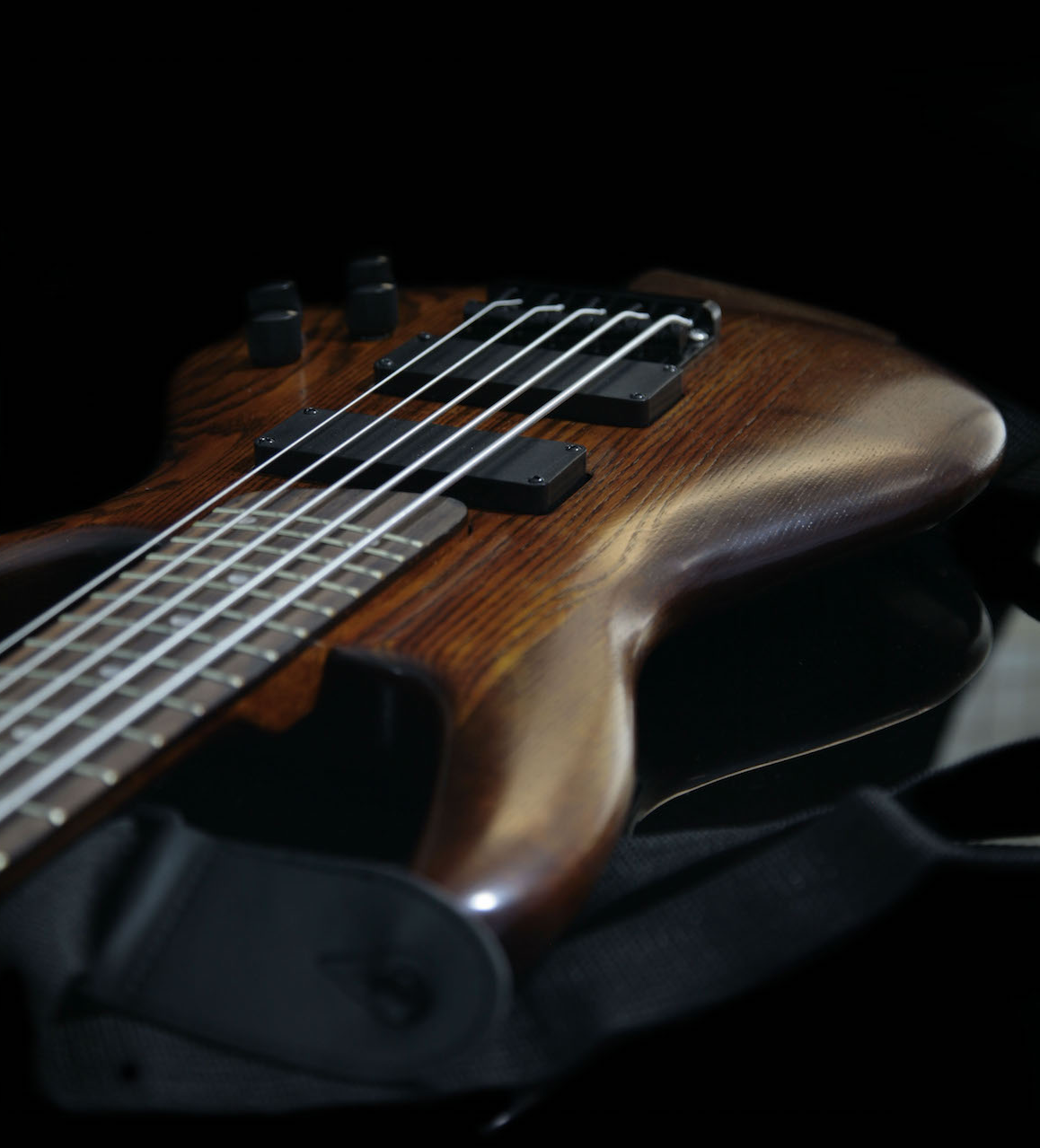

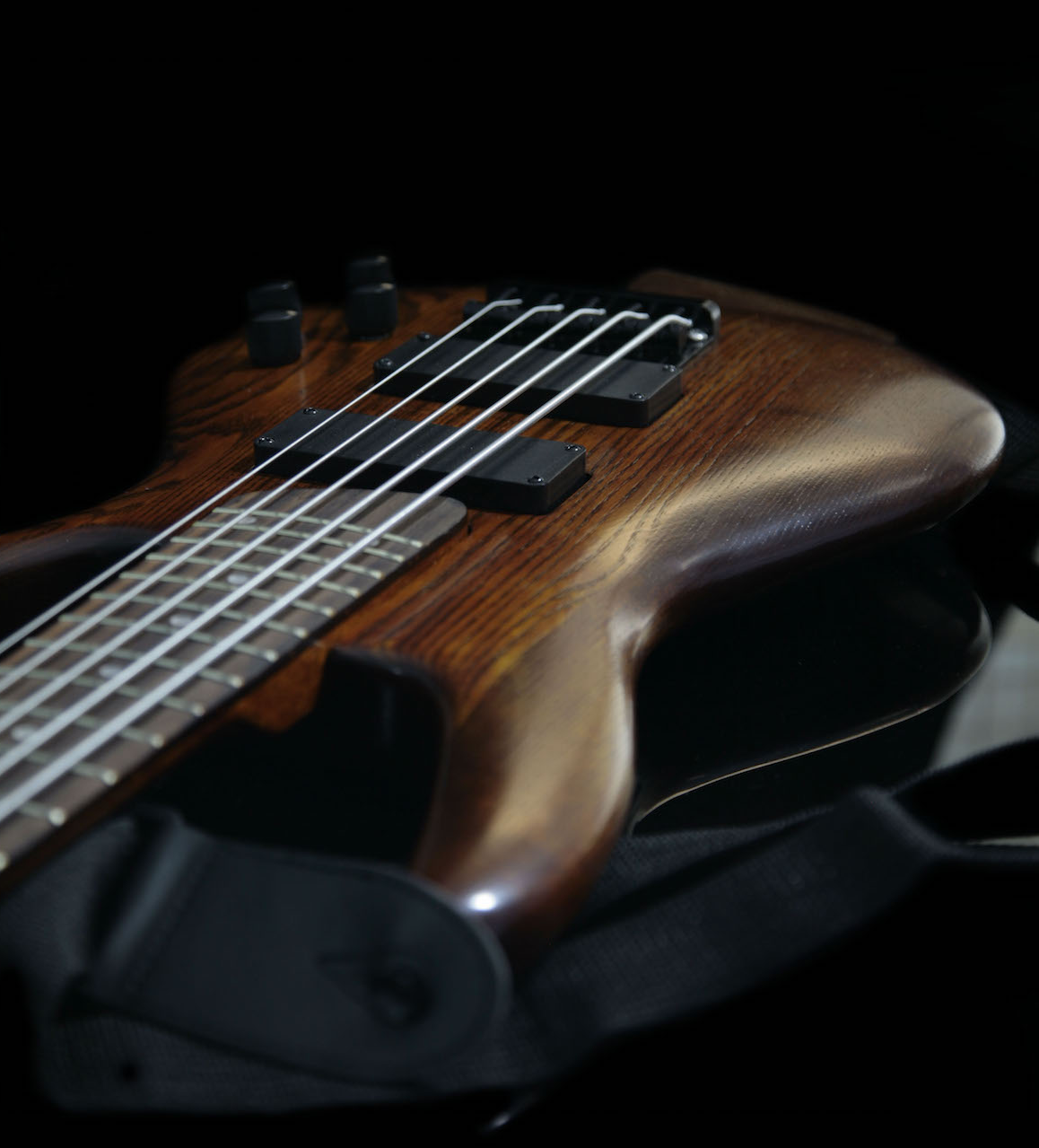

    First Attempt at a Kit Guitar Be gentle
    It is the IB 5. All stock parts. I started by sanding it ( as you do) then spray painted it Black. Then rubbed it back again leaving some of the grain with the black paint in it. after that, Natural stain, with slightly tinted shellac ( about 12 layers ), French polished every 3 to 4 layers with 0000 Steel wool ( Its meant to look old ) Click image for larger version.

  7. #87
    sweet looking build Ejay, you need to enter it into November GOTM as it is judged start of the month.
    One of the moderators may be able to do that
  8. #88
    Looks great Ejay. Black and brown looks very classy and nice grain.
