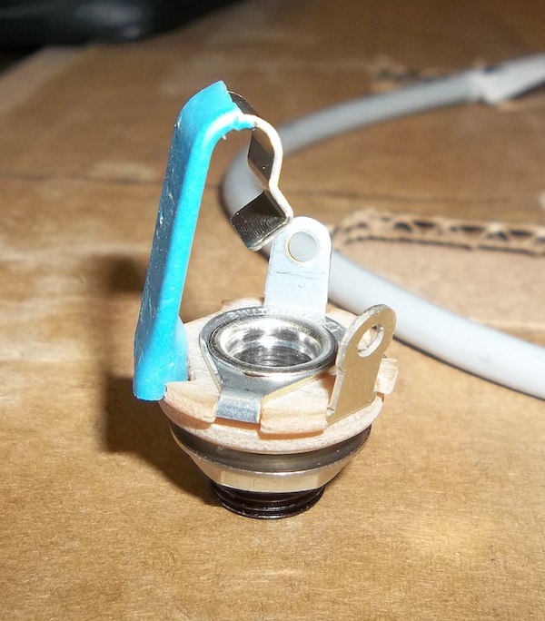

    Shielding plus side mount jacks can easily cause hidden problems. Grab some wide heat-shrink tubing and slide it over the arm any time you’re doing a side mount, it’ll save headaches:
    Glad you got it sorted.
