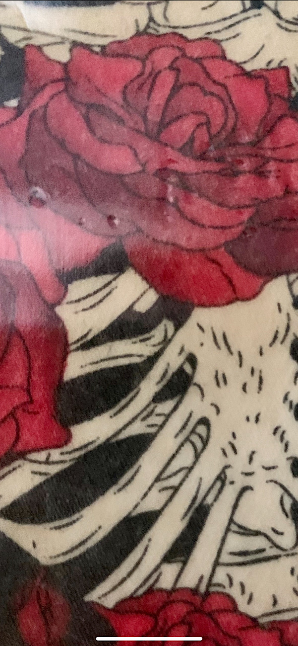

    Orange peel may be a bad name for it / let’s call it dimples - it basically low spots within the finish. In may have been something to do with the fabric or the glue. I sanded fairly aggressively to try and flatten out the finish and get rid of the dimples. Hopefully the attached photo helps
    My process is fairly simple - wipe on with a cotton patch folded over - thin coats. Same application as my first build which is totally flat and was easy to level

    Ah, I see what you mean now.
    Yeah, those dimples look pretty deep, almost like a bubble that formed and broke.
    How extensive is it? Does it appear all over?
    I only ask because if it's just a few small areas, maybe you could do drop-fills with CA, then level them out and polish.
    There a few good how-to videos out there on drop-filling. Hope you find something that works for you.
  10. #80
    You could also try drop-filling with thinned poly, though thin CA would be quicker. The poly's surface tension means it follows the contours of what's beneath it, it doesn't just sit and fill-in the hollows unless it's really, really thinned down. I know you're afraid of sand-through, but sanding back a large amount is really the best way to remove the dimples. I'd wait a few days after applying your last coat and then start sanding. Otherwise you can just build-up a deeper and deeper finish and never ever get rid of the dimples if you just keep applying more finish.
