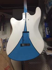

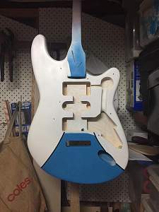

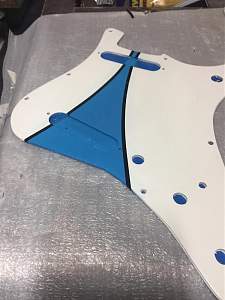

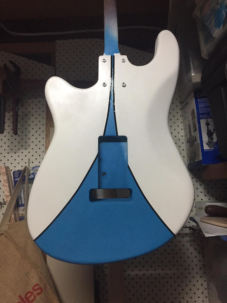

    A few days and a bit of progress! With colour coats complete, on a whim I decided on a different approach. First a did a couple of light layers of clear, then did the pinstriping with automotive tape (after a long discussion with the bloke in the shop who assured me he'd applied acrylic over the tape and it had worked fine!). It was very easy to do I have to say. I then did another clear. At this point the tape decided to lift a little and I thought I was screwed, but I've managed to keep it in place and do a couple more coats. I think I've got it firmly fixed now. I'm happy with the pickguard and front, the back isn't quite as tight but close enough! I'm going to do a heap of clears to get try and get a glassed look so I'll have to be patient!!

    now thats different the tape will be fine under clear just dont spray the 1st 2 coats over it to wet after a couple of dry costs you'll be fine, if it was me i would have put the tape over a few coats of clear as will stick better

    It did do a couple of clears first but probably a bit too light to make for a really good surface to stick it to. Your suggestion would have been spot on! I've now done three over the top and it's settling down.

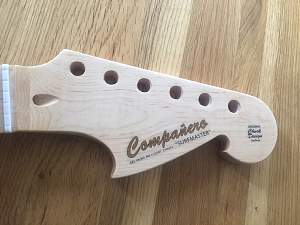

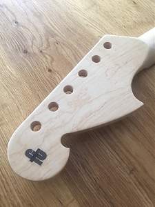

    With all the heat/rain/humidity, painting on the body is going very, very slowly! So at the very least I figured some logos were in order. Funny thing is that when I originally started this project I'd called this one the Surfcaster, but at some point I've created logos with word Surfmaster. Oh, well, let's just go with Surfmaster from now on! I also did a very small logo from the surfboard I'm basing this on and put that on the back of the headstock as a nod to its origins.

    Looking awesome Chuck! I really love the headstock shape man. How did you create your headstock decal? Is it just a water-slide? Could you tell me the font, color, printer type etc. to replicate? I would really like to do something similar.

    The font is Brushscript and I did it all in Photoshop (created an outline for the font, then played around with "brown" tones to fill to try and get as gold as possible.). All the various logos etc where then dragged into Word where I played around with getting the sizes right. I then picked up some laserjet waterslide paper off ebay and printed it on the laserjet printer at work. It's much simpler than I thought it would be.
    Unfortunately I don't have access to Photoshop right now as I was using the work copy, and I've just left that company! As soon as I find a Photoshop source I'll get details on the brown/gold colour - or I could send you the Photoshop file and you could play around with my template?
