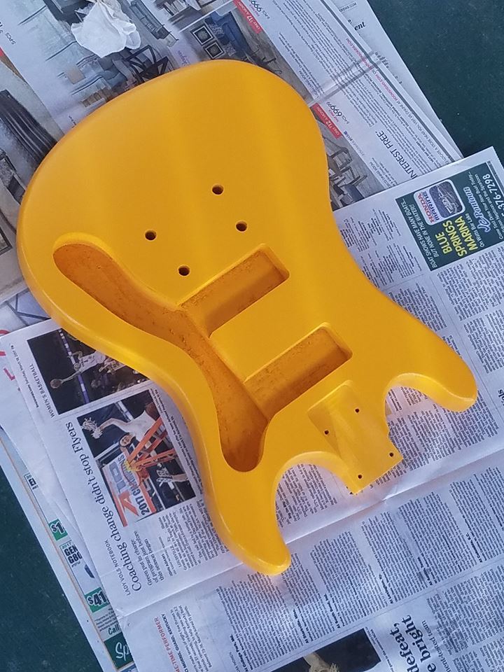

    Here is the body. All shiny and partially clearcoated. (The striping is actually shadows from my balcony, it was late in the day.) Just fixing that edge I mentioned...Click image for larger version.
Name:	Body curing.jpg
