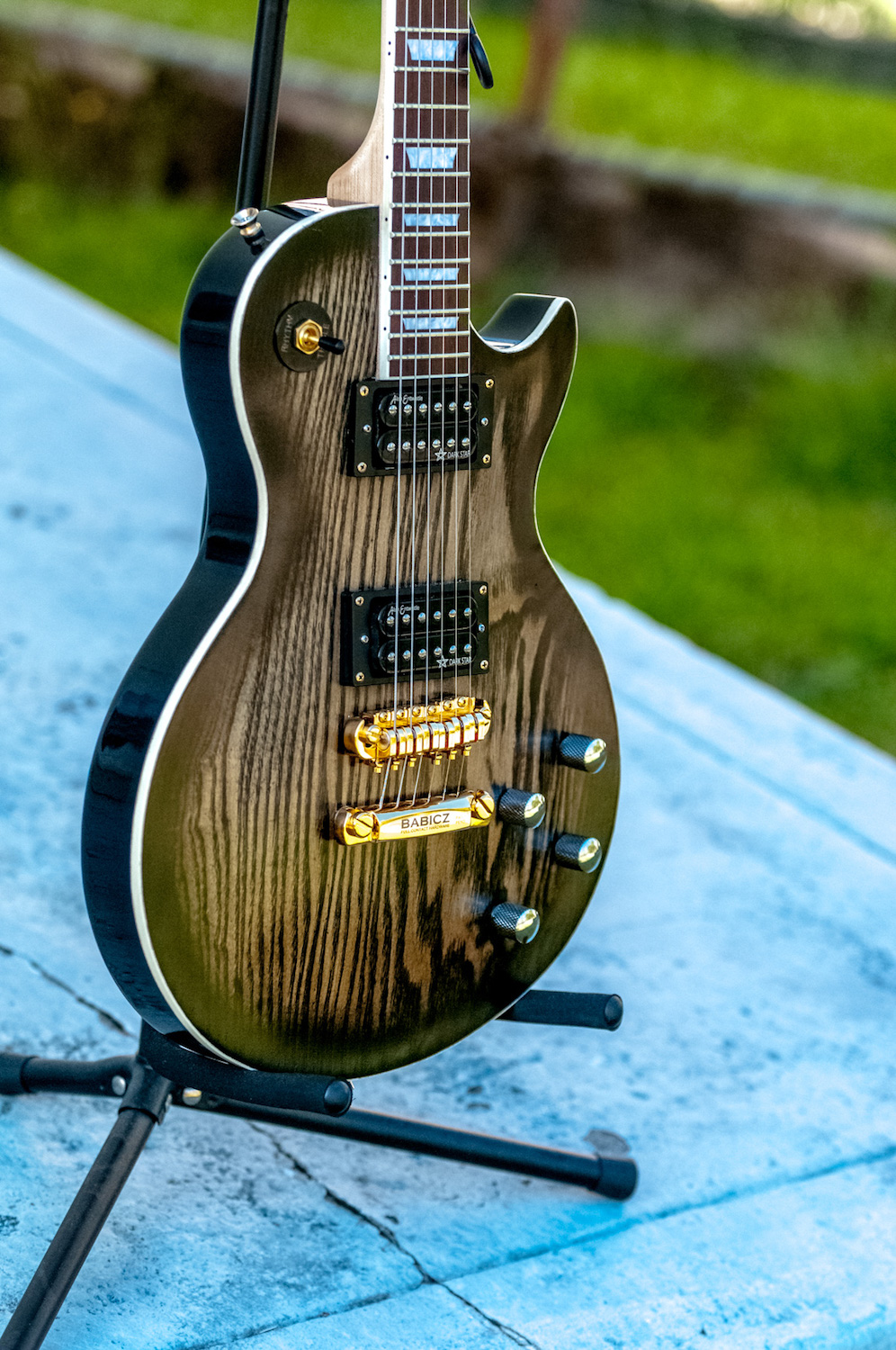

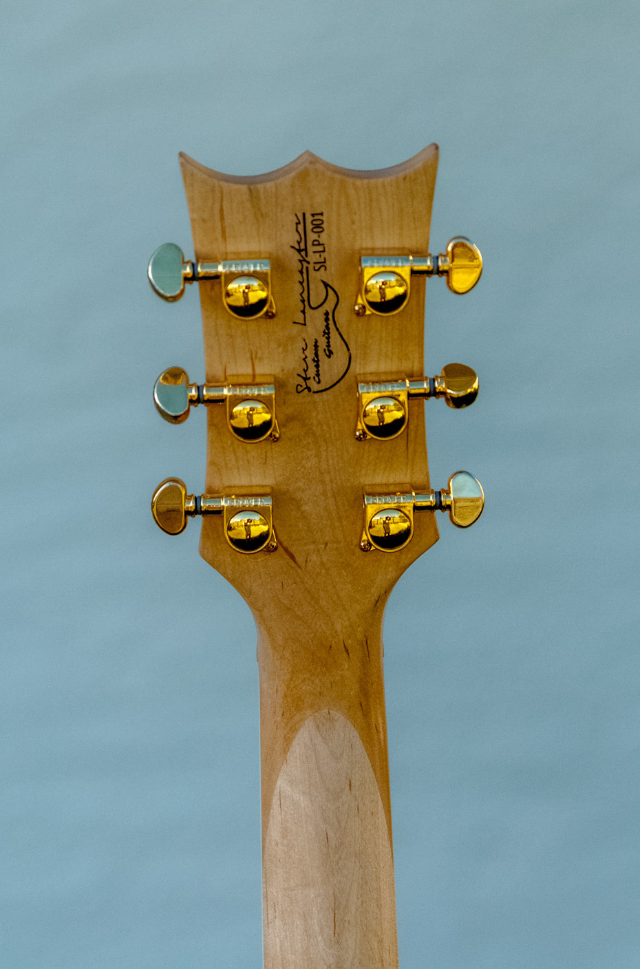

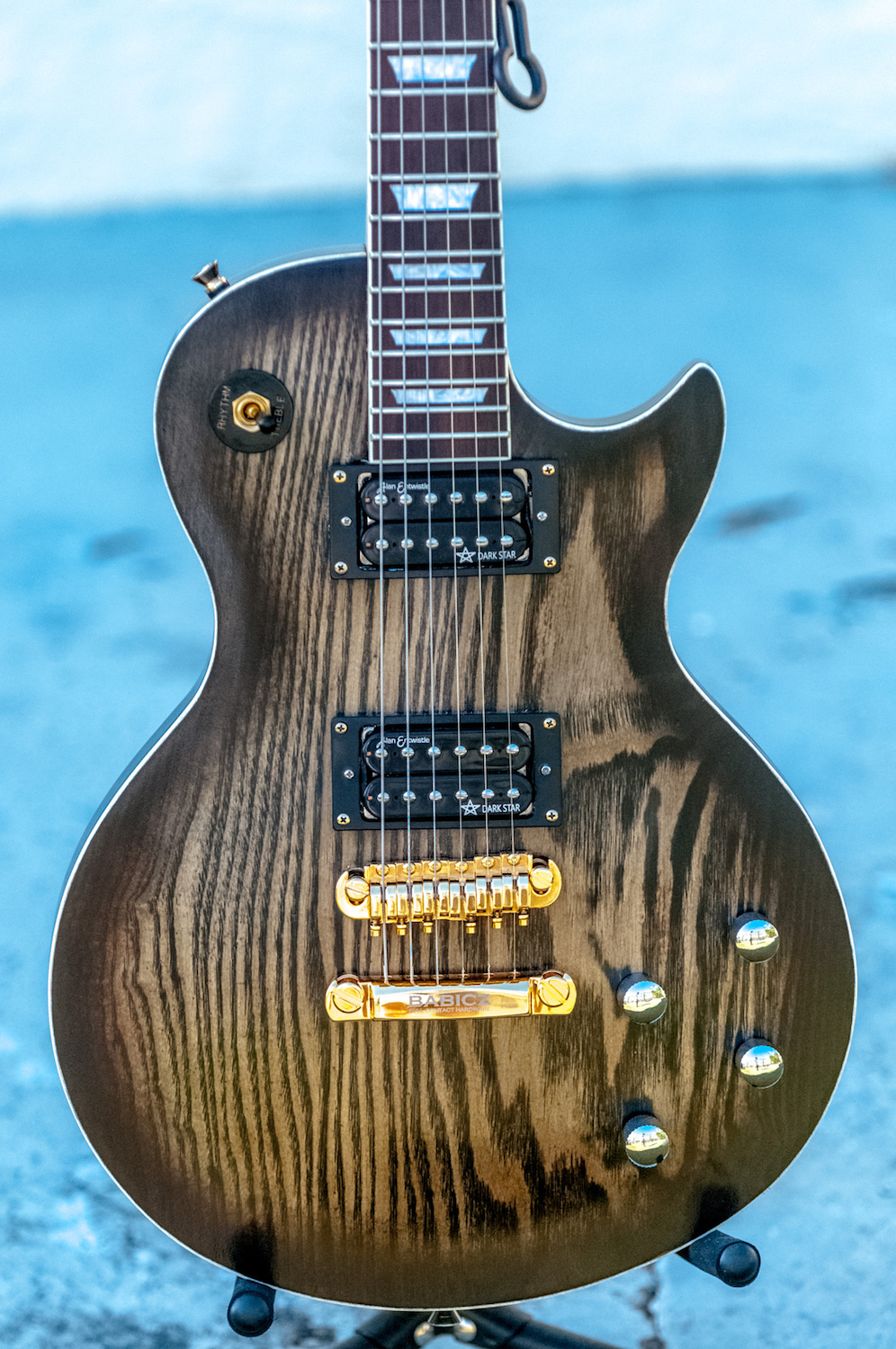

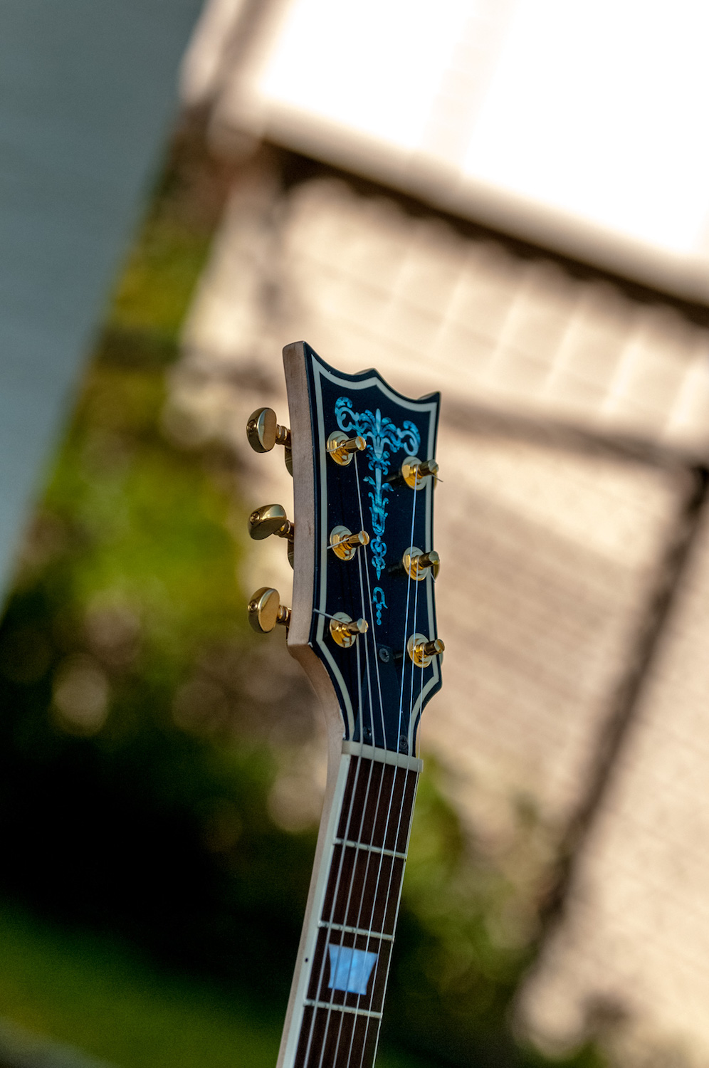

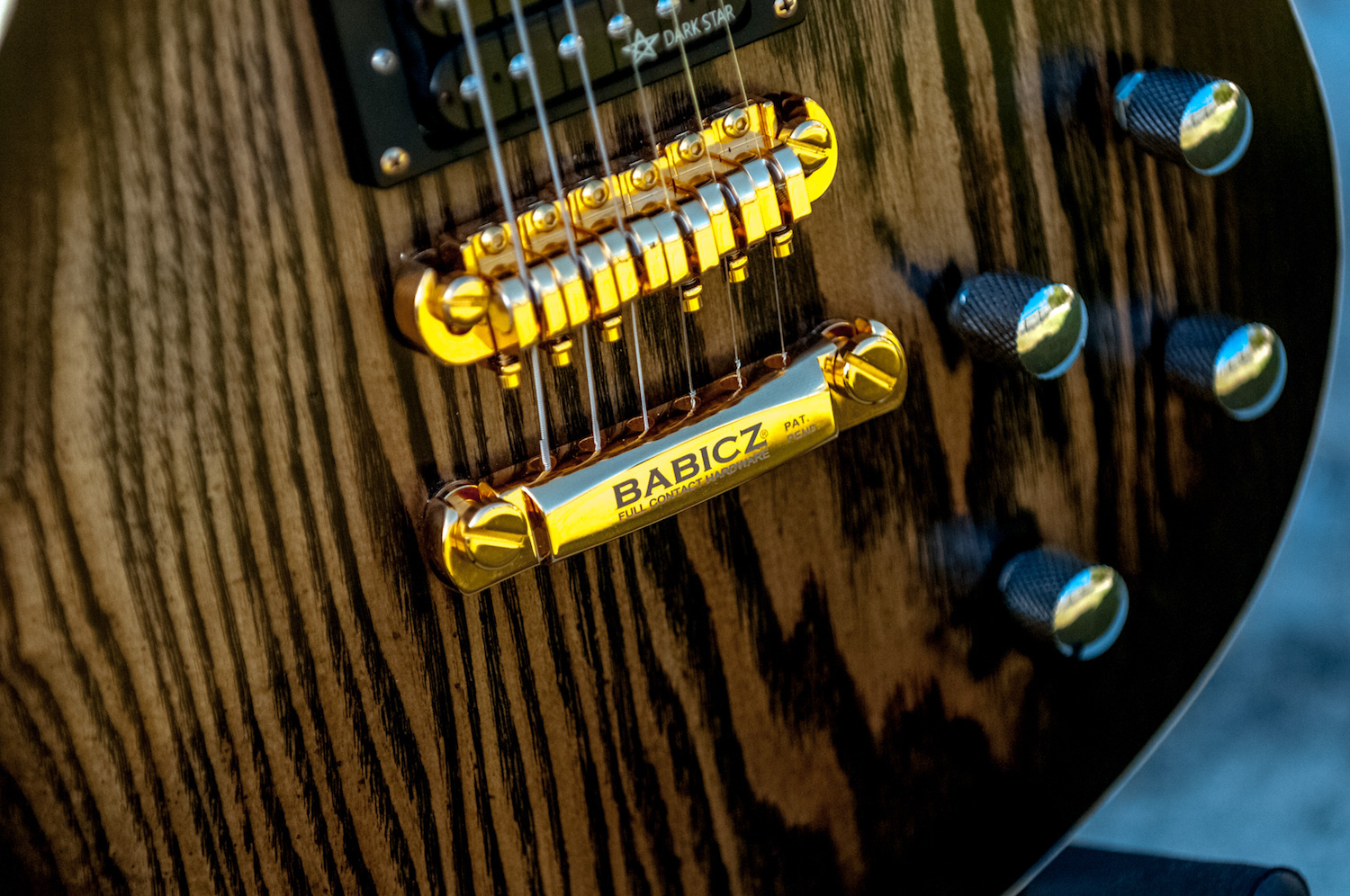

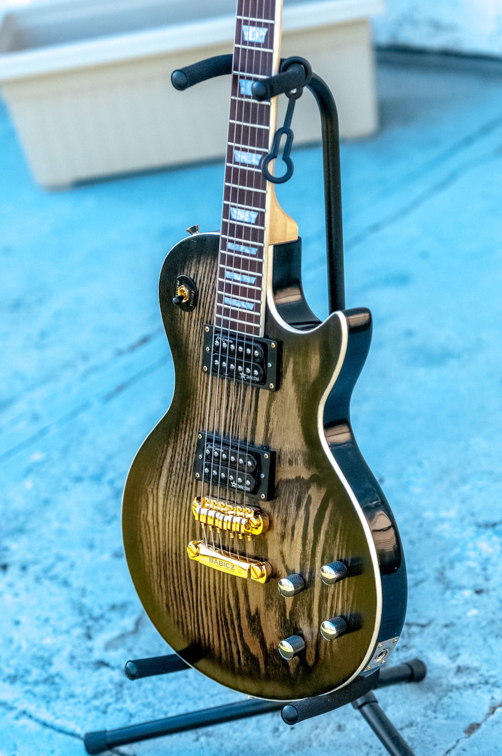

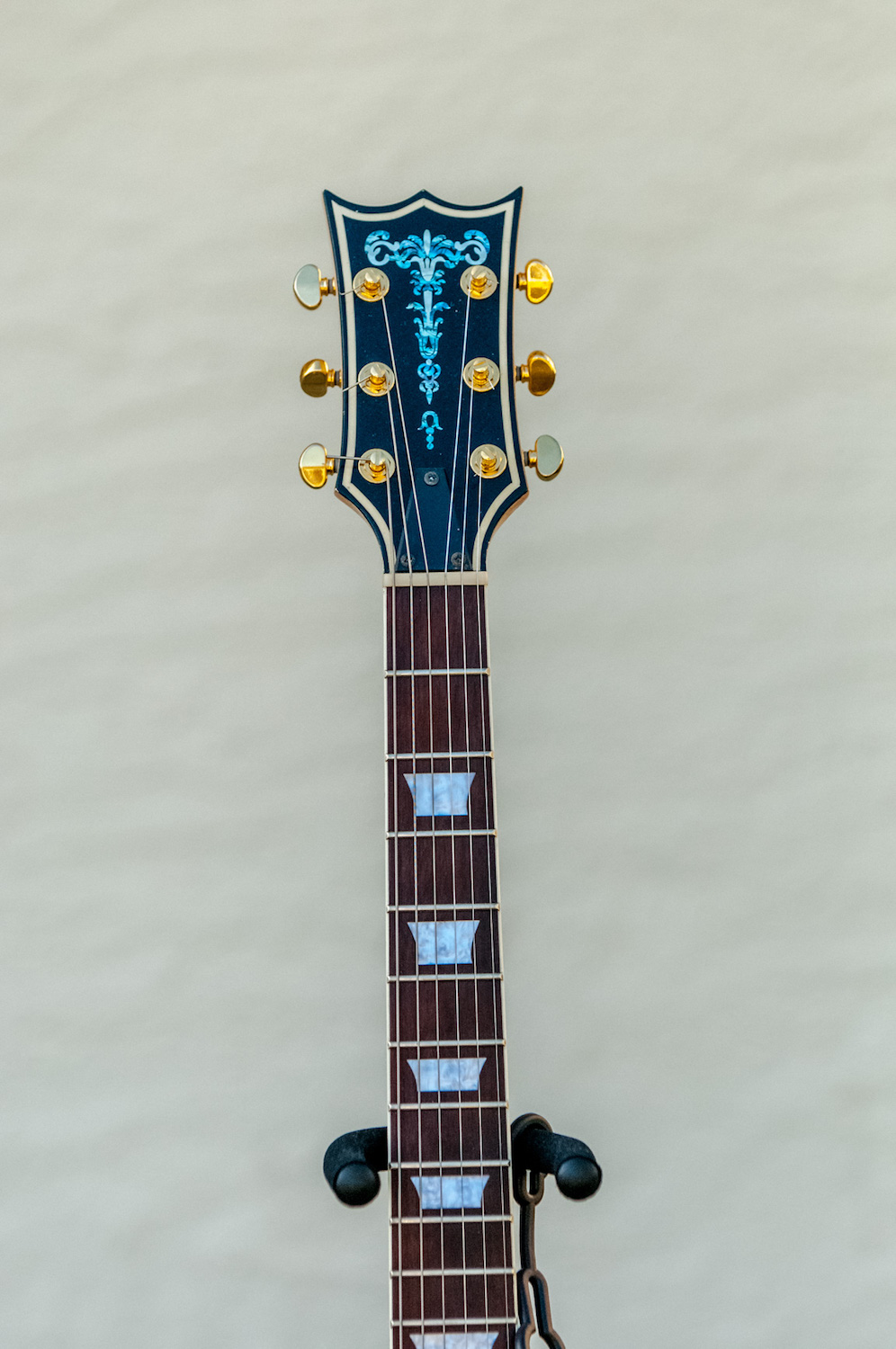

    AND SHE'S DONE!
    SOUND DEMO RECORDED (Please don't laugh at me - Im still a learner!!)
    My Soundcloud Demo of me fiddling with my new guitar
    Recorded Entirely on this guitar (drums and bass obviously not of course)
    Finish
    Dingotone Blackstump / FW Black Japan burst
    Dingotone Top Coat
    Black Acrylic side and back
    Automotive clear coat side and back
    2 Coats Tru-Oil for the Neck - Neck finished matt for speed.
    Neck
    Fret Job, Neck Levelled
    Dingobass Bone Nut
    Headstock
    Inlay-sticker Headstock, Hand trimmed face
    Grover Locking Mini Rotomatics
    Bridge and Tail
    Babicz FCH Tuneomatic Gold
    Pups
    Entwistle Darkstar ND Bridge and Neck
    Electrics
    Bourns 500K A/B Push/Pull Pots for Tone and Volume
    Klein Treble Bleed Cap and Resistor Mods
    Sprague Orange Drop Caps
    Jimmy Page Wiring (21 Tone with Phase and splits).
    Some modelling shots - I'll get more later on...
ID:	15131Click image for larger version.

    Hi Depicted, sorry but I have to ask, how have you got that sound from the Darkstar pickups, the test sounds brilliant, really brilliant, and those pickups are very dark, I have them on an LP too and never have got a sound as shining as that, how have you done it? I need to know XD is the Orange Drop capacitor? Is the Klein mod? Or is it some kind of eq you've used while recording the sound test? I'm really impressed for the quality of the sound, it's an amazing guitar.

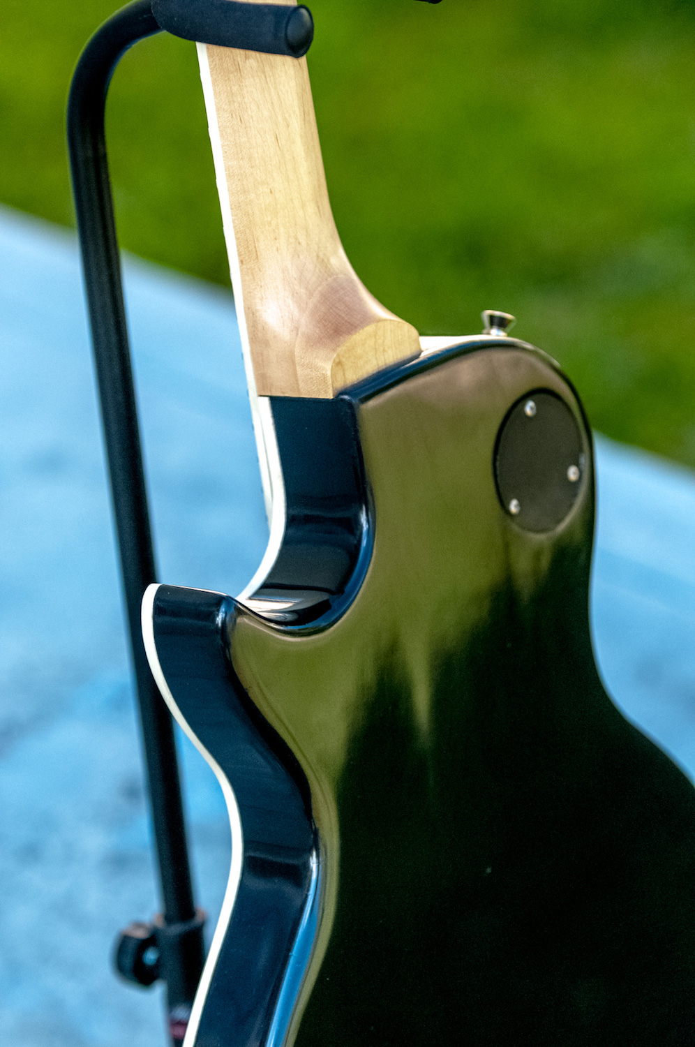

    Some more
ID:	15135Click image for larger version.
ID:	15136Click image for larger version.

    You have done an outstanding job, what an awesome guitar
