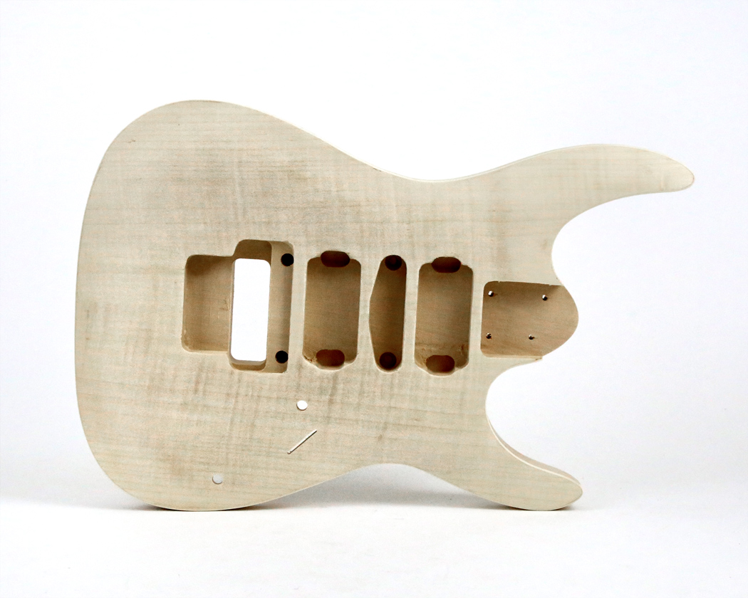

    Hi Zandit, as it is going to be a solid colour suggest using the dremel to take out enough for the boomerang shaped PUP base to fit in the cavity.
    On some high end super strats they actually have that PUP shape cut into the top such as on this PBG kit...
    Is it the same for both single coils or just the Hot Stack going in the middle position? Either way you will need to at least enlarge the middle PUP rout.

    Under cut is the only way to go then as that is how traditional strat single coil PUP's are made with the boomerang shaped base.
    Don't think you will need too much vertical adjustment but should leave enough room just in case.

    It was actually quite an easy job with the right dremel bits borrowed from a workmate.
    Probably not the cleanest of jobs, but it won't be visible from the outside.
