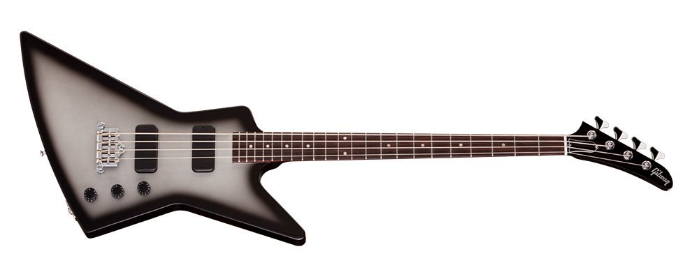

    I reckon it would look good as blended edge rather than a full burst. A bit like this but not such a defining edge line perhaps?
