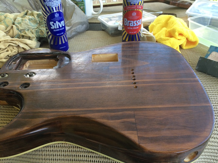

    The back after the 2000 grit sand.

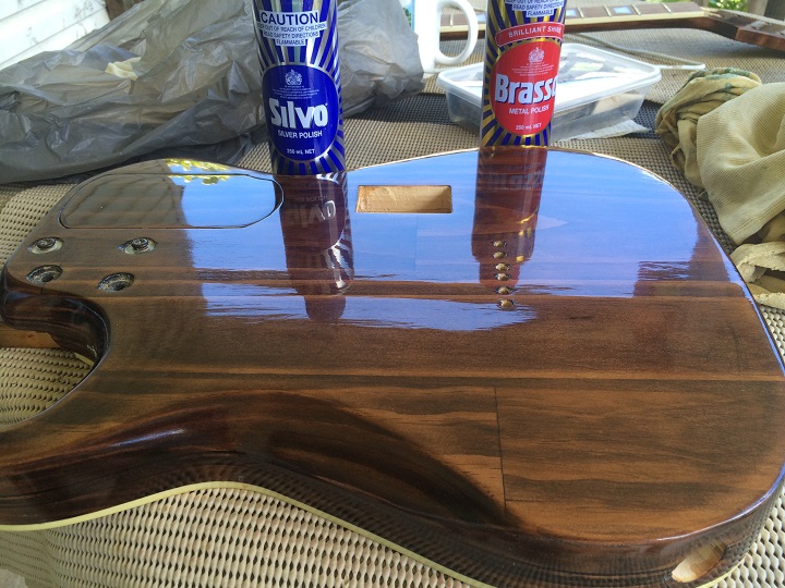

    The back after a good hand buffing with Brasso.

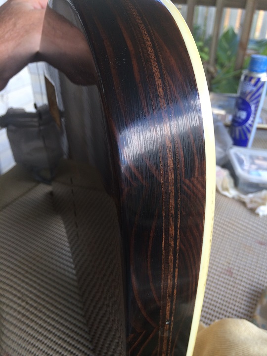

    The side after the 2000 grit.

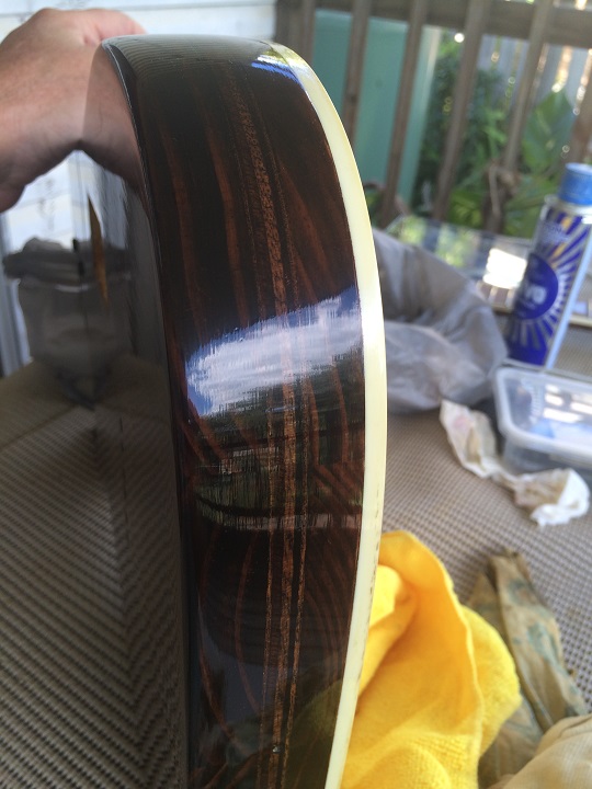

    The side after the Brasso.

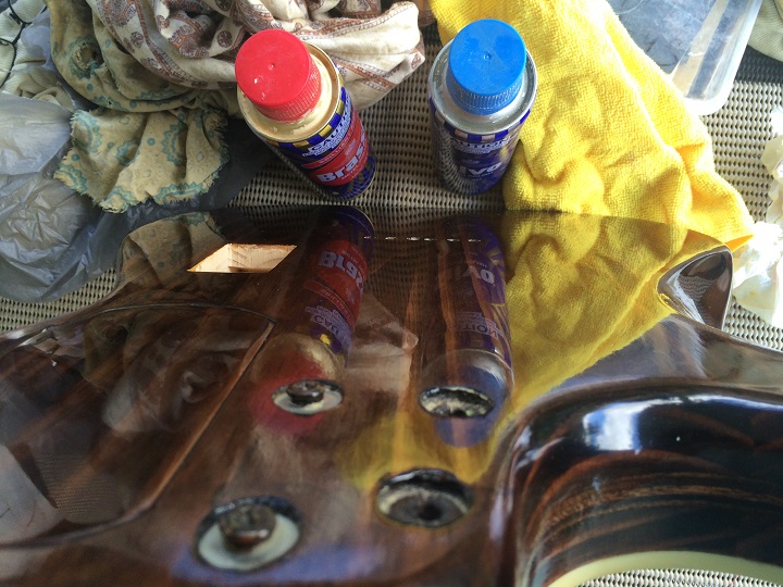

    A bit of an “arty” shot of the back.
    Actually the photos are very flattering, as the finish is not that good IRL.
