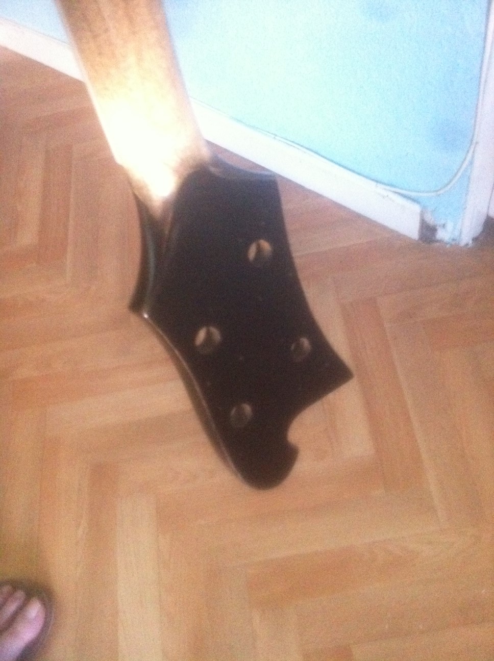

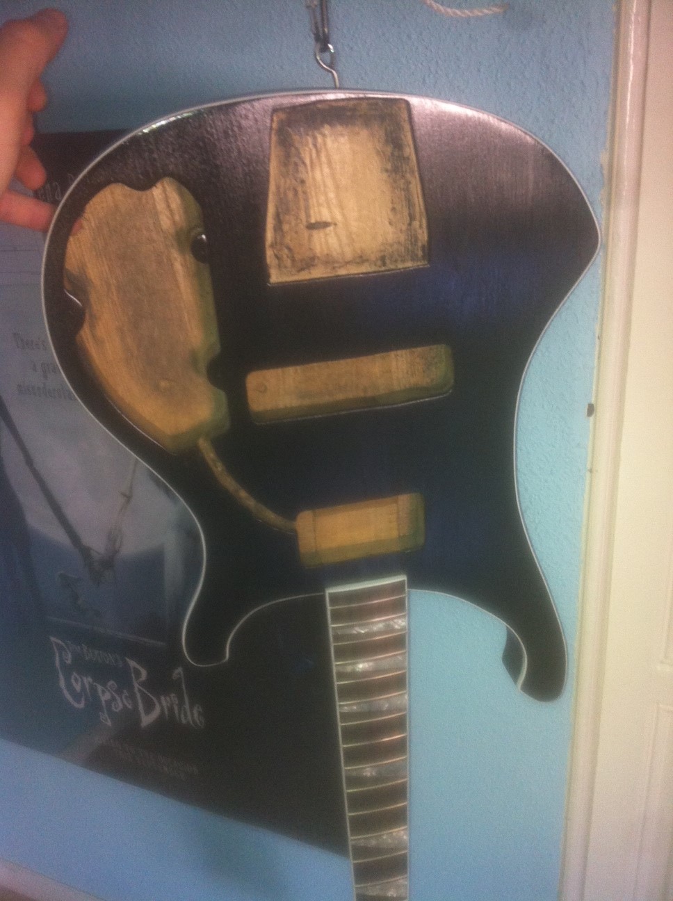

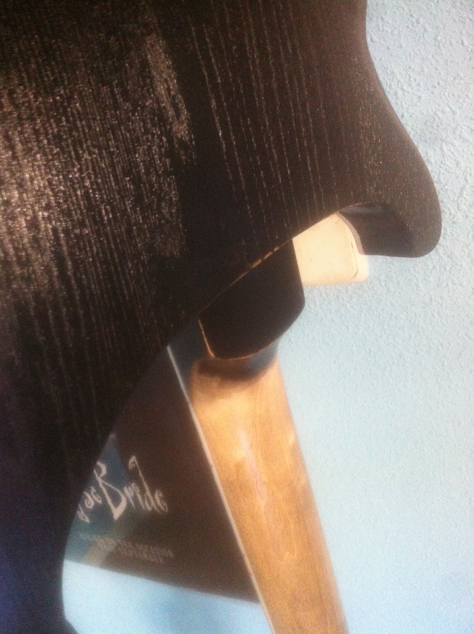

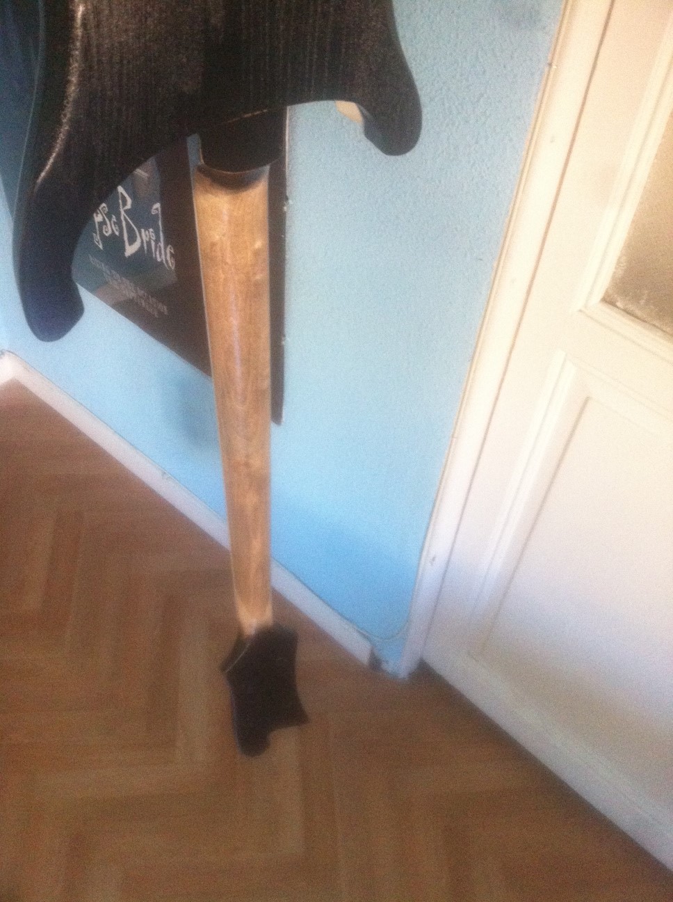

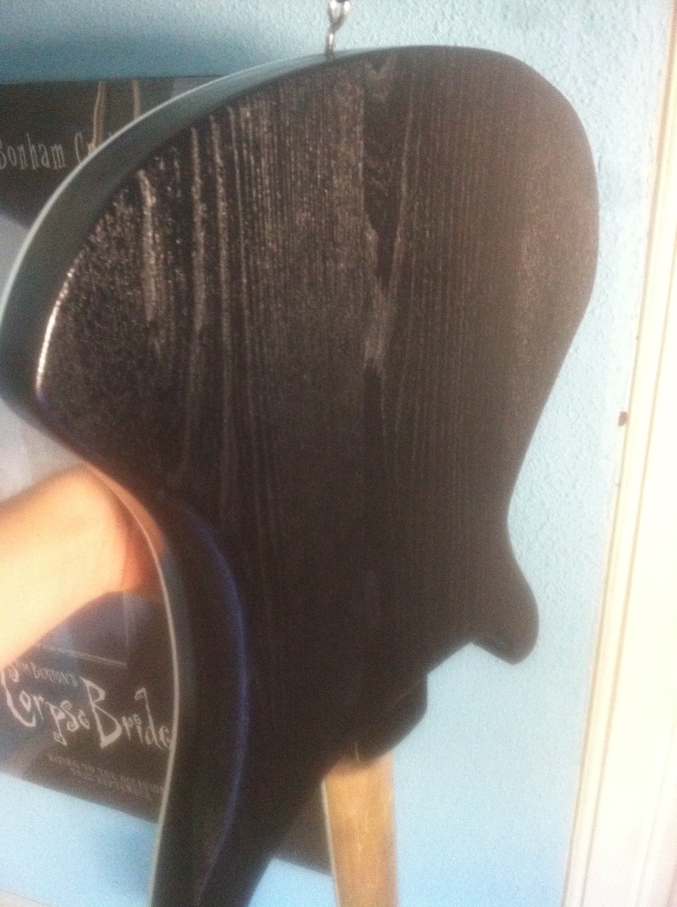

    Long time since the last update.... a lot spend, learning how to apply correctly the india ink, sanding it, screwing it, redoing it...screwing it....hundred of times. horrible experience, but learn some things..
    -1. dont prep sand more than 240 grit, even 180 or less to get nice results.
    -2. dont apply more than 2 coats. One if were possible.
    -3. Apply with a bathroom sponge...and when its dry (1 min or so) rub with a used cotton shirt to even the ink..(it gets satin)
    -4. I following to apply shellac from spray can. Get nice results on the back, not in the top.
    -5. On ash wood, dont apply grain filler. Its not necessary, its better looking without it, and it will not accept the ink as well.
    Anyway, some new features came along in the body. some relic touches on black..And neck sanded to barewood.
    I had to routed 3mm for the bridge installation. A little bit of high action seen in the mock build so...dremel...heres your turn..again!
    I decided to routed the cable room from neck pickup, due the complexity to solder to pots. I did it in my drill press, as I have seen on some original basses.
    Here are the pics, not good quality sorry.
    4th truoil coat applied yesterday, and it feels very nice..End is coming.
