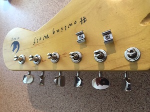

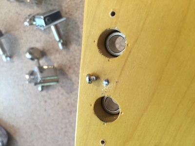

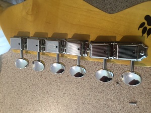

    So the conversion bushings came in and were fitted. Needed a tiny bit of glue as the outside of the conversion bushings were exactly 10mm and the hole was too. The vintage backs are only a little skewed due to the wonky holes and the 10mm spacing.
    All was right in the world until I snapped a screw. Now I'll not repeat what flew out of my mouth at the time, slightly more colourful than my guitar, but needless to say I do not have the specialist tools to get the screw end out, replug and redrill.
    It all seems to be holding quite well without the screw but its gonna piss me off until I fix it later.

    Hey Andy, looks good, huge bummer about the snapped screw but should be fine without it, the tuner shouldn't rotate and doubt not having a screw head will be that noticeable.
    If you run a straight edge along the tuner edges do they line up fairly well ?

    Ouch!!.... I've been there and done that too so I know how you must feel, you can order these screw extractor kits online from Stewmac:

    Yeah they're pretty straight except for that one wonky hole "G" string which you can see in the pic.

    good stuff Andy, glad the wiring is sorted. Might be worth plugging the G tuner hole with dowel and re-drilling so tuners are aligned. Which tuner did the screw break on ?
  7. #77
    The screw between B and high E.
