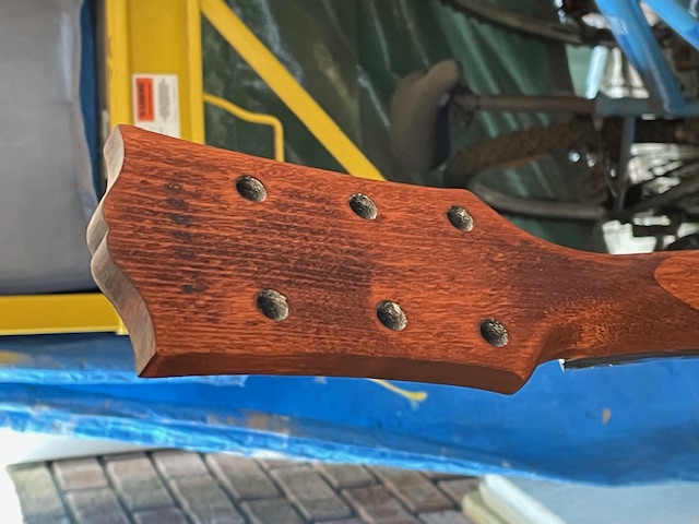

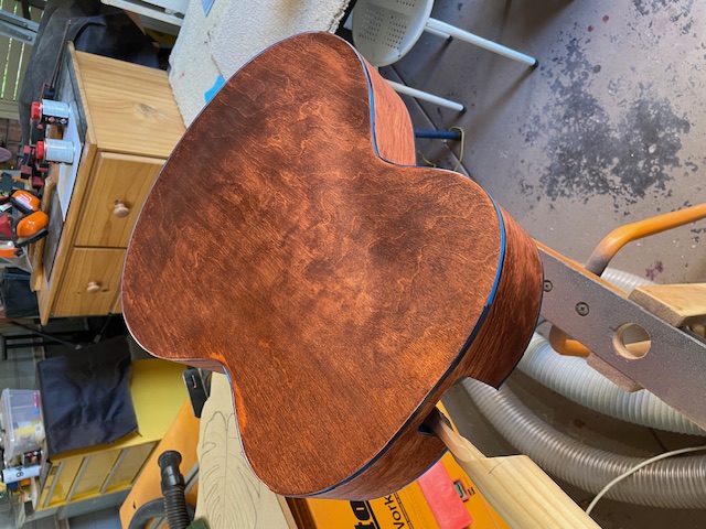

    Added a coat of FW Jarrah stain to the sides and back of the body and the neck.

    I did not do as well with the binding this time. Some stain has leeched under the tape and along some cracks in the binding. For future reference: I should have applied the sanding sealer directly to the body and binding (which may seal the fine cracks in the binding), taped it up, and applied more sanding sealer to body (which may seal the edges of the tape). Maybe I just fluked it the first time!
