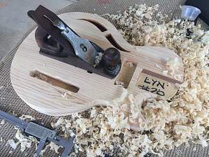

    So…. I needed to drop the string height by about 1.5mm so I opted for shaving a mm or 2 off the guitar body so that the bridge sat a bit lower. So out with the plane, lots of wood shavings later and now the string action “should” be alright.

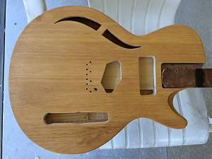

    I also put a couple of coats of stain on the guitar and I must admit to being rather underwhelmed by the result. It is less than eye catching so it looks like I will go with Option B for the finish which was to paint. If that fails I will sand it back and go for the stain again.

    Mentor dozymuppet's Avatar
    Jun 2020
    842
    I reckon if you mock assembled the hardware you might be more impressed...
    Mentor robin's Avatar
    Brisbane
    1,513
    Yeah I tried that DM but it just looks very plain. If all else fails I will go back to that and maybe give it a bit of a relic look to add some character. But I want to try painting first.
    rob
    1,841
    I think it looks good. It will look great with the hardware.
    And love the cavity hole shape.
    Brisbane
    1,513
    Thanks Trevor, I guess I was a bit disappointed because the body was showing some nice grain patterns, but they just disappeared when the stain went on. But never mind, paint will go on this week and I'll decide then what I want to do.
    I could still see the grain on the stain pictures. Nothing stunning, but it was there. Clear gloss on top would bring it out more. And there's always the sunburst option. Many a plain piece of wood has been made to look more interesting by adding a burst. You could always give that a go and if you don’t like it, then you can still go with a solid colour.
    Brisbane
    1,513
    Thanks Simon. I thought about going sunburst, but I have a few sunbursts now and wanted to try something a bit different. I'm going to try something I haven't done before so it could quite easily be a bit of a disaster so stain and clear coat is still a 2nd option.
