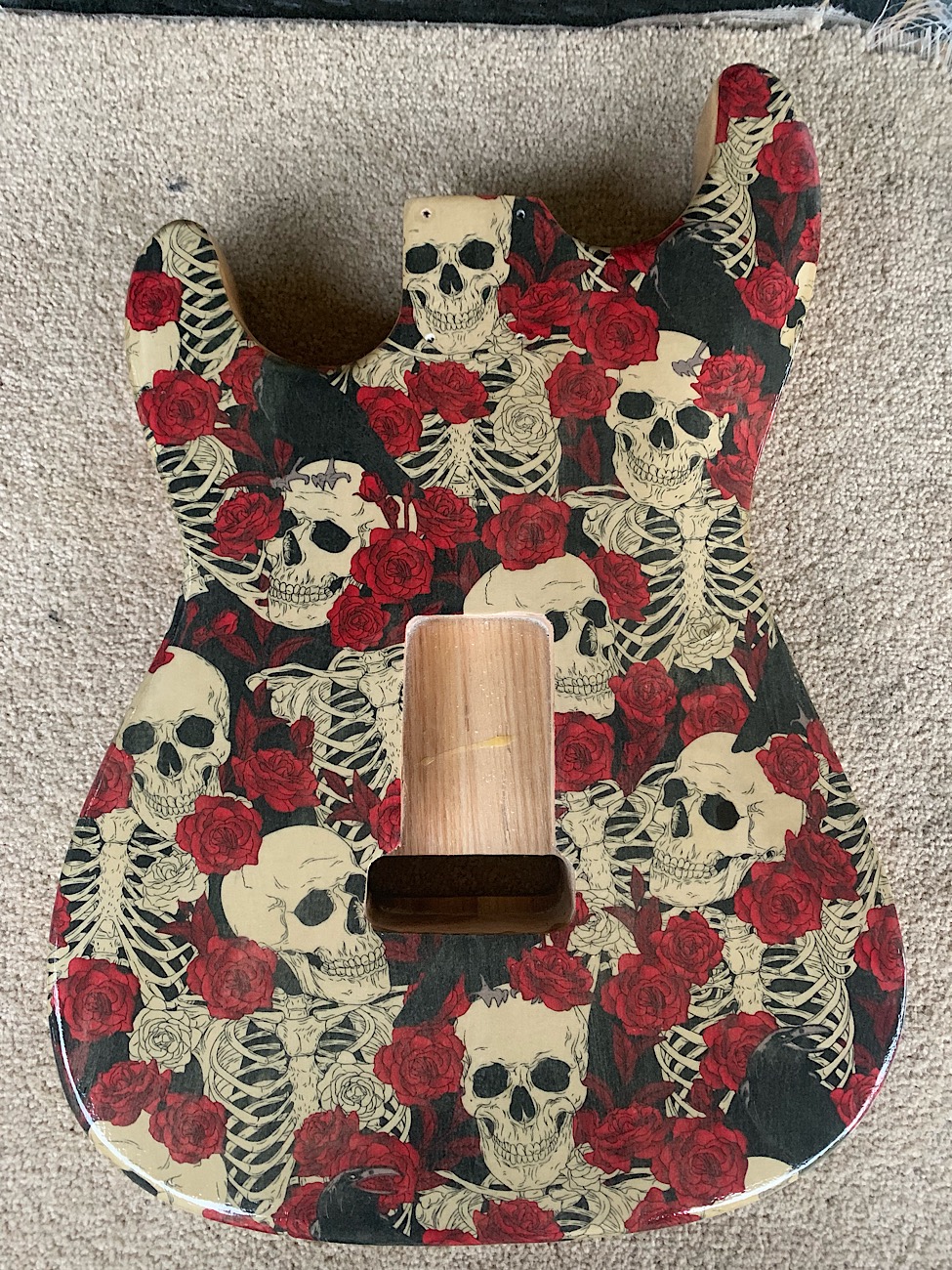

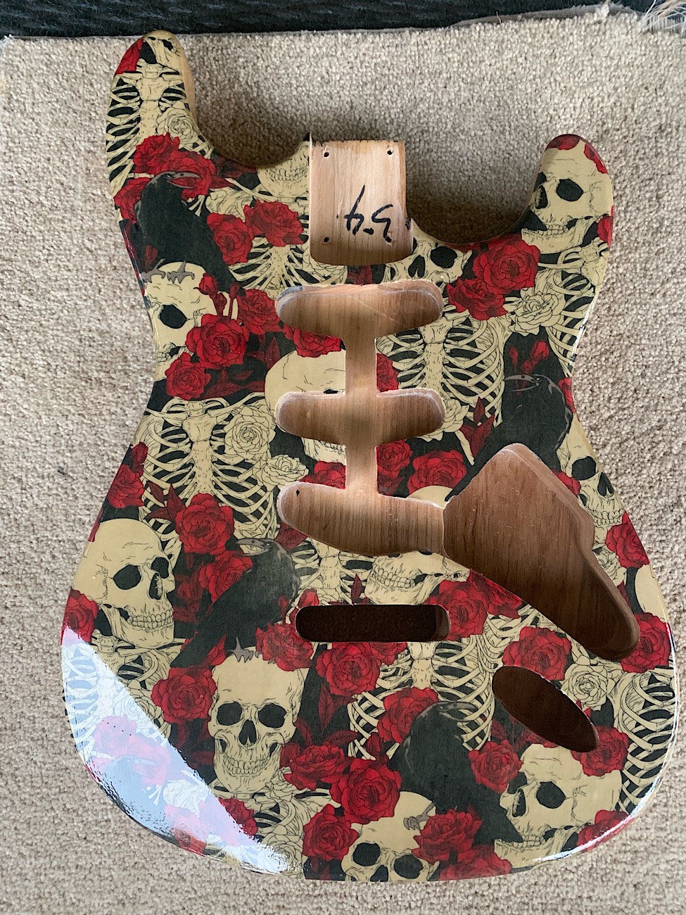

    Hi All,
    It’s been a while from my last post and there has been a lot that has happened in the build. In short sanding off the fabric top was a huge pain in the ass!!! If I would have had my time again I would have taken the advice to be patient and maybe fix the small bubbles. But what’s done is done....
    I started the build again and re-bonded some fabric to the guitar body. I have divided to use wipe on poly instead for the finish. I liked how durable the finish was on my first guitar and additionally to that with enough coats I feel I can get a good gloss finish. At first I wanted to use a rattle can for the crystal clear coat and didn’t want the yellowing effect of the poly, however, given the variability in temp in Melbourne and the fact that my shed gets extremely hot I feel I will run into the same issues with the rattle. I also left the sides wood rather then bursting in the sides with black.
    I have attached some photos of the guitars progress. This is with 5 coats of poly on front, sides and back. Edit: I also just realised that I changed the orientation of the fabric - not by design but is what it is now

  9. #69
    Mentor DarkMark's Avatar
    Sep 2017
    1,570
    Looking good. Wipe on poly is my finish of choice at the moment. You may need many coats. Got me thinking I’d like to do a fabric top, if I was going to do another kit.
  10. #70
    Jun 2019
    156
    Yep guessing that I will be wiping it on for a while. I will build it up over sometime - annoying this is I will be overseas late Jan so will have to take a back seat again. But until then I will continue to do some coats
