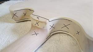

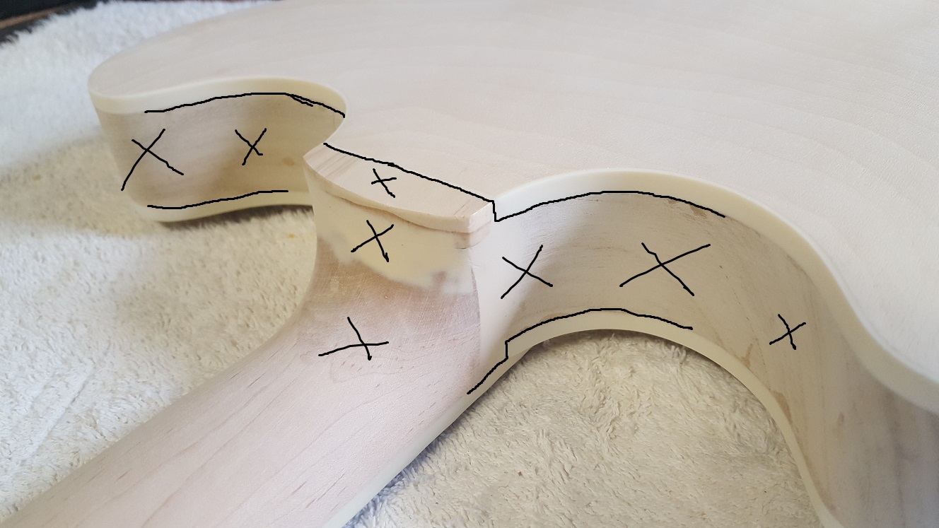

    It wasn't hard but you convinced me to use Tru-Oil on the body front.
    Problem now arises, I have a skim of timber filler at the neck joint that won't work with a see through finish so I'm thinking ... Black enamel sides and neck (possibly back or Tru-Oil on the back?).
    The question is if I paint and cut back the black sides once hard, can I Tru-Oil over the front, binding and black enamel? This should smooth out the edge between binding and black enamel but retain a visual sharp edge?

  2. #62
    Well that's a head scratcher and no mistake. Not sure about TO over Enamel.
  3. #63
    Member cork sniffer's Avatar
    Dec 2015
    South Coast NSW
    348
    Thanks for comment.
    Been told elsewhere not to Tru-Oil over enamel, probably will take OK but dull the finish.
    Suggested I black enamel first, allow time to harden then mask off and Tru-Oil up to but not over the paint.
    Open for more comment???
  4. #64
    I'd recommend a method test first on some scrap and that will validate/invalidate your plan. Is it possible to do the clear in an enamel or an enamel safe clear topcoat?

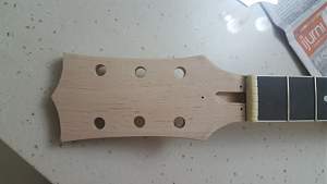

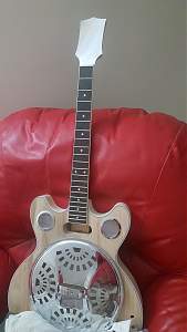

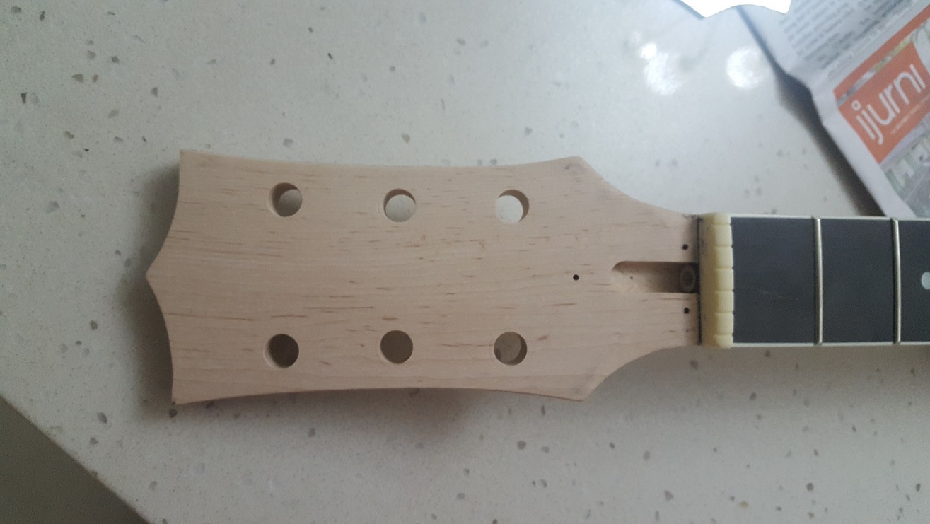

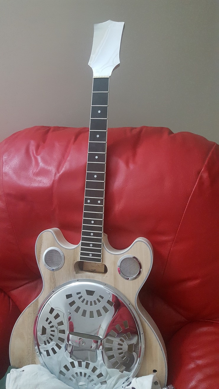

    Found a little build time today. Cut a shape into the headstock and decided to pick up on the chrome body look with a polished alloy veneer headstock. I'm not sure but think once tuners are fitted and a custom logo breaking it up a bit it may be OK. Never seen such before, it's a big world and I've been sheltered :-( I have a test piece glued and clamped just now, if it takes I MAY fix it tomorrow.
    Opinions welcome, it isn't too late to bin the idea.

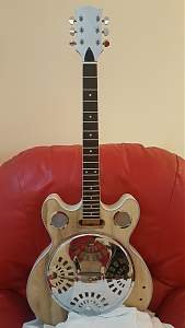

    Mock up with some of the chrome bits to get the vibe.

  6. #66
    Mentor blinddrew's Avatar
    Apr 2018
    York, Uk
    1,122
    I reckon that would look pretty special actually. Don't think I'ver seen anything like it before.

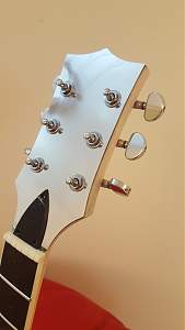

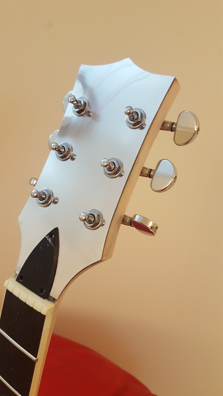

    The glued up test piece worked great ...
    I made the call early today to go this way, by late afternoon the tuners were screwed on :-). Still a lot of Tru-Oil and paint in front of me but another step hopefully in the right direction.

    Thanks. My wife took one look at the headstock and said "I think I'll have this one". Bummer :-(
