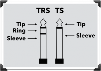

    Well, your battery will be always on (unless the pre-amp has an on/off switch). You could switch it via a TRS jack socket, with the OV battery output connected to the S connection of the jack and the R connected back to the pre-amp (and you use a standard TS jack lead).

    Right you are 0.047uF got that, TRS? OV? S? R? TS? I’m a bit lost on the acronyms there Mr. Barden, sorry the electrickery side of things is not my strong suit. I’m more of a lunacy with woodworking kind of guy.

    edit: okay, TipRingSleeve, TipSleeve gotcha. Run the power to that to enact an on/off via the TS standard jack to make the circuit. With you now. On that bit at least.
