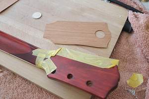

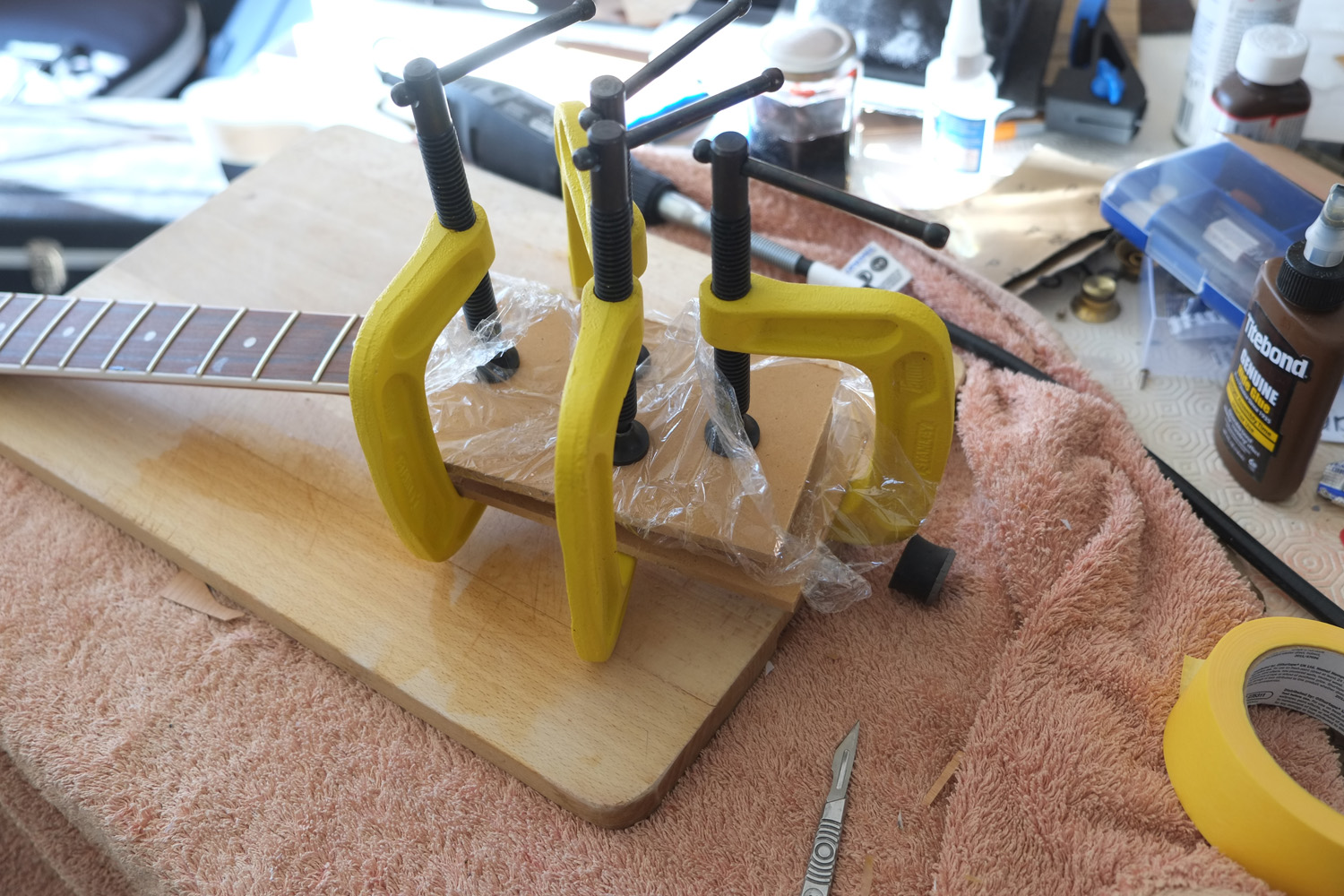

    Well I think I've sorted out the inlay issue, using a mixture of scoring round the shapes with a scalpel then using a Dremel engraving bit to remove the abalone in the middle. I realised that I don't need to cut all the way through the plastic backing, I just need to remove the abalone so that I can fill the gaps with black super glue. Though i'm not sure quite well how the superglue will stick to the plastic, so I've made holes right through in several locations, so that the glue can stick underneath (it should stick OK to the wood) come up through the holes and fill the pits in the abalone on the top, hopefully locking it into place. I've got a couple of inlays ready, but until I try each filling one with the superglue, then I won't know exactly how good they'll look, as the plastic backing is obviously a bit mangled from the engraving bit, so the abalone doesn't stand out much in contrast. Fingers crossed.
    Anyway, in preparation, I've cut out a bit of veneer for the headstock face, cut a hole in it for the inlay to sit in, and glued it to the headstock. Luckily my inlay design just happened to be the same size as a UK 10 pence piece, so I had an easy template to draw around. Here I'm halfway through taping up the sides of the headstock to protect them from any glue runs. There's no way that I'd get a wet cloth to remove any excess in between the clamping pieces with the clamps in the way.

    I just hope the veneer hasn't moved from its centred position when I clamped it up (cling film between the clamping piece and the veneer to avoid any sticking).

    The veneer is just slightly thinner than the inlay piece, but by the time the veneer is sealed and has a couple of coats of black paint on, it should be on a similar level. Then some wet sanding should bring everything nice and flat again.
    Well, that's the plan!
