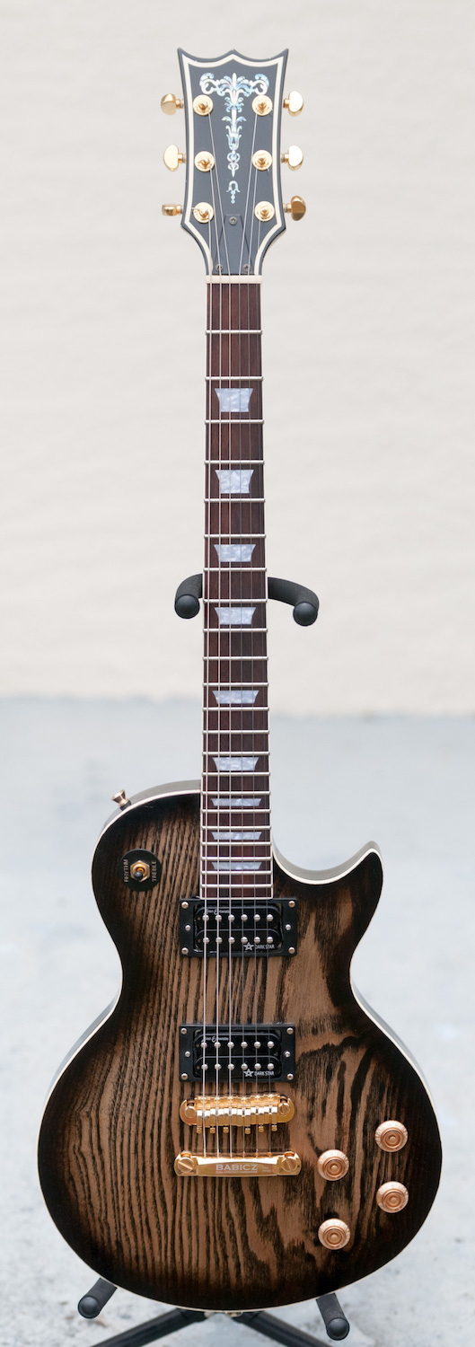

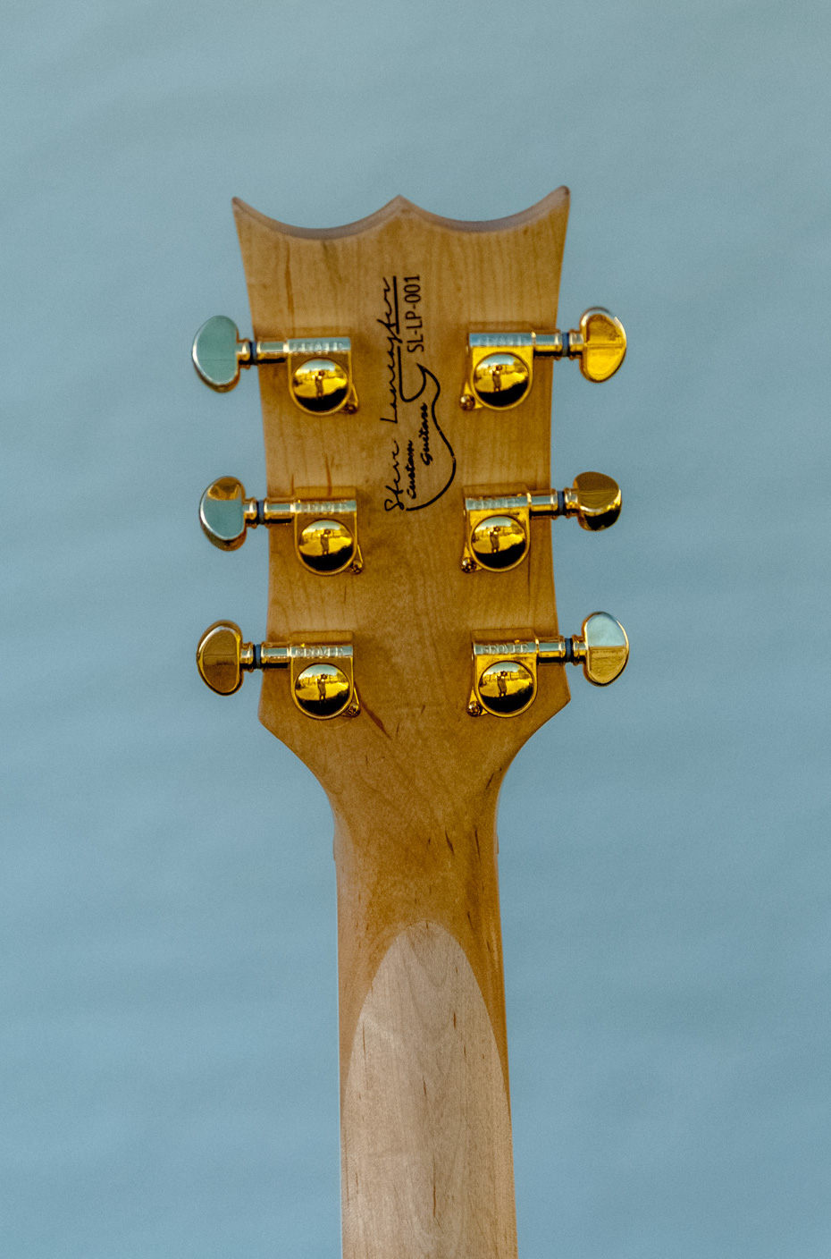

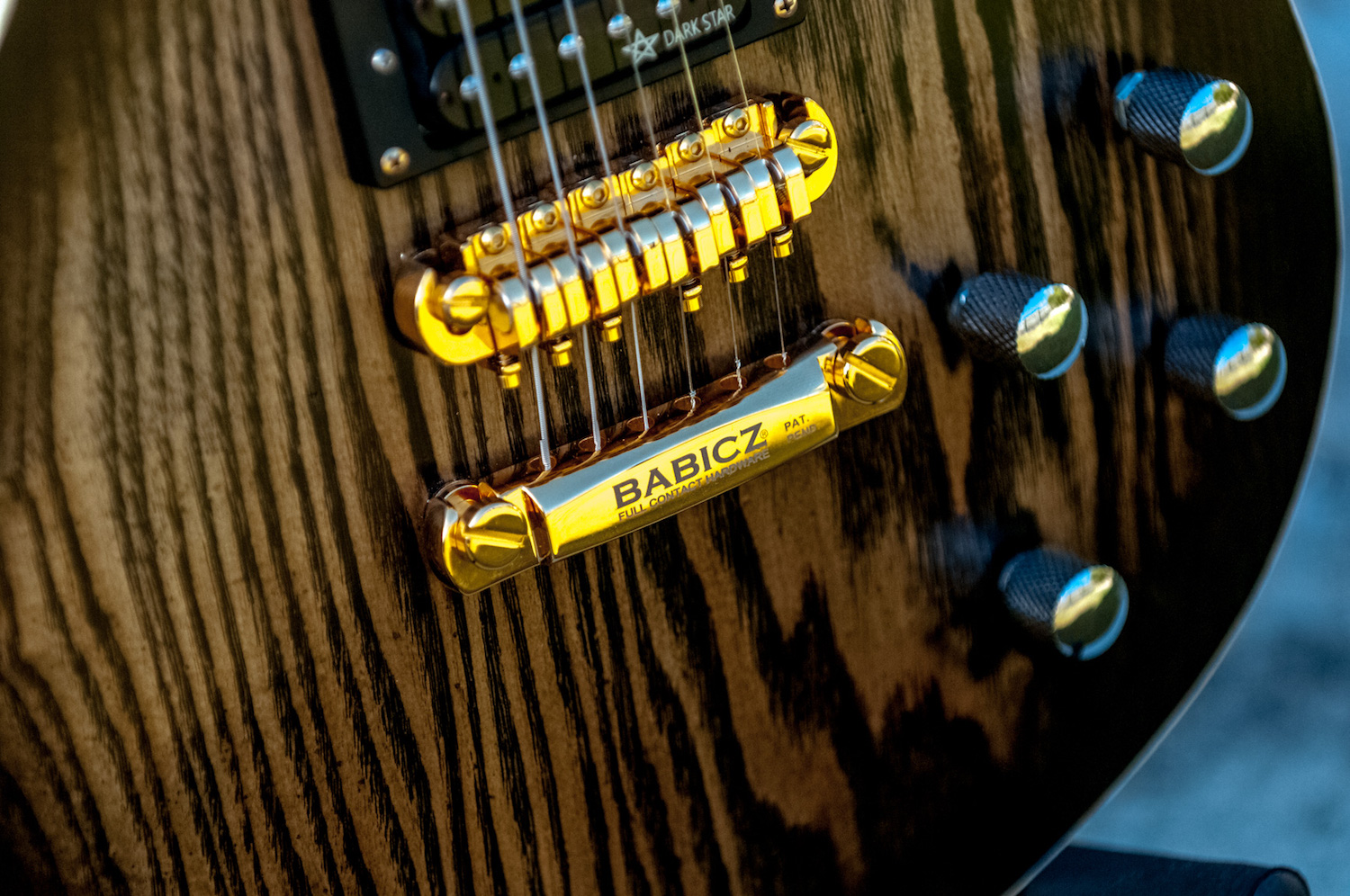

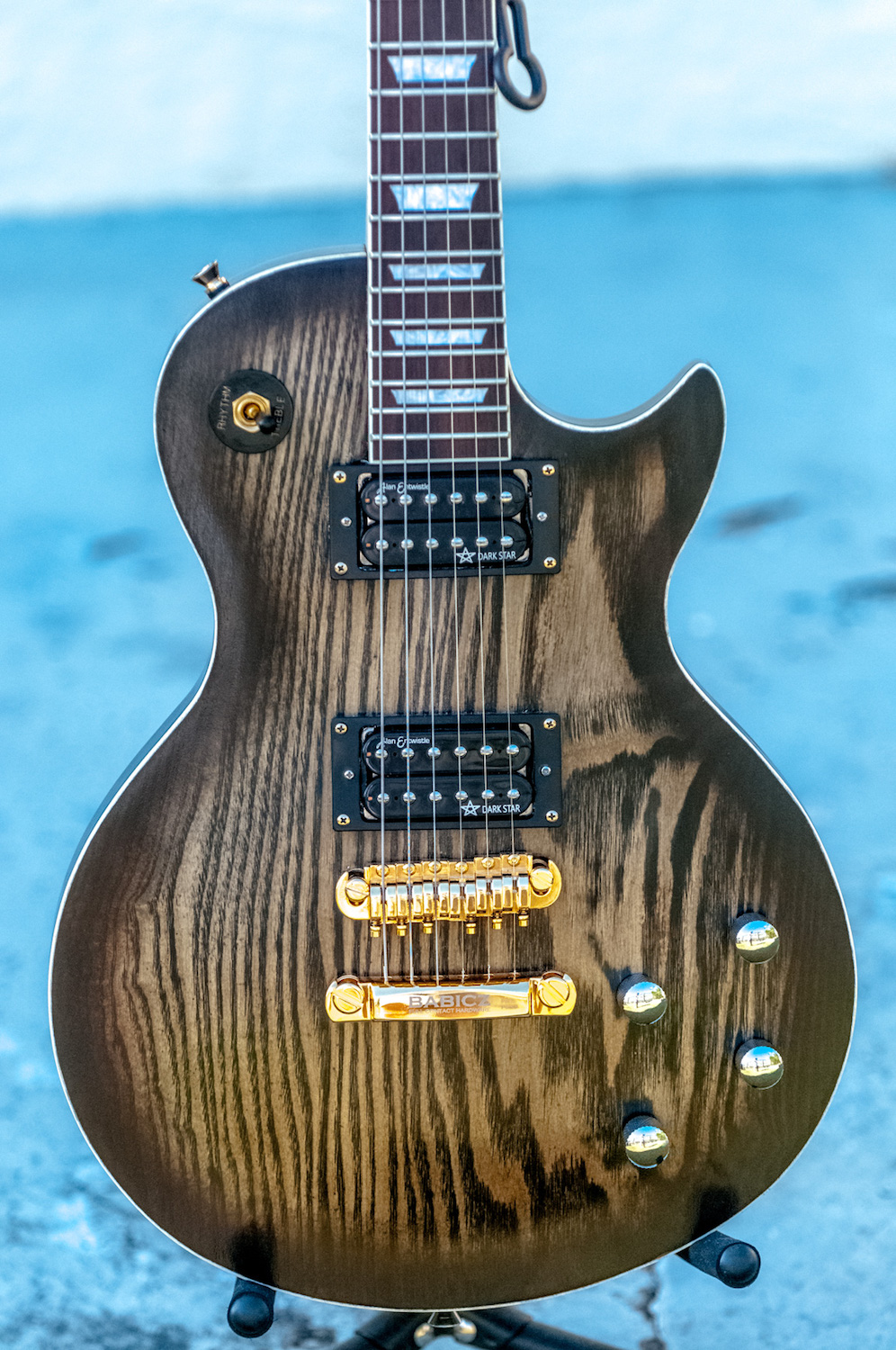

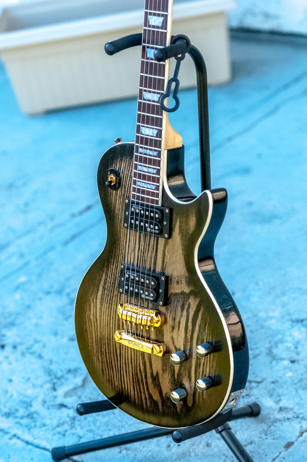

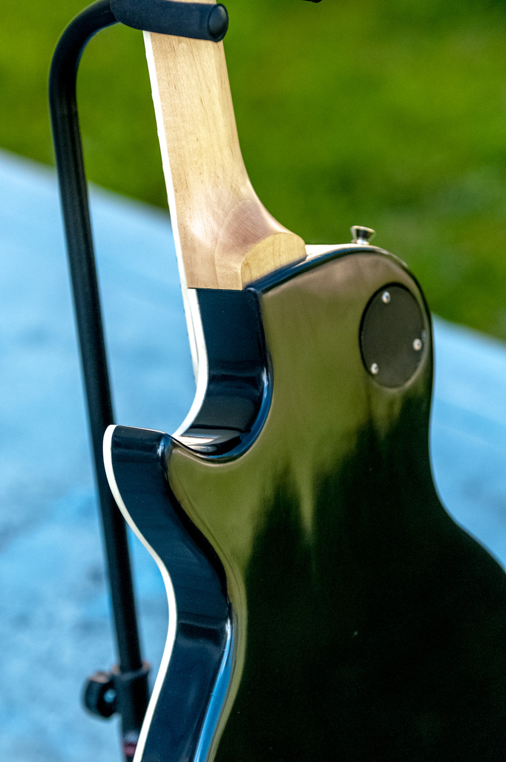

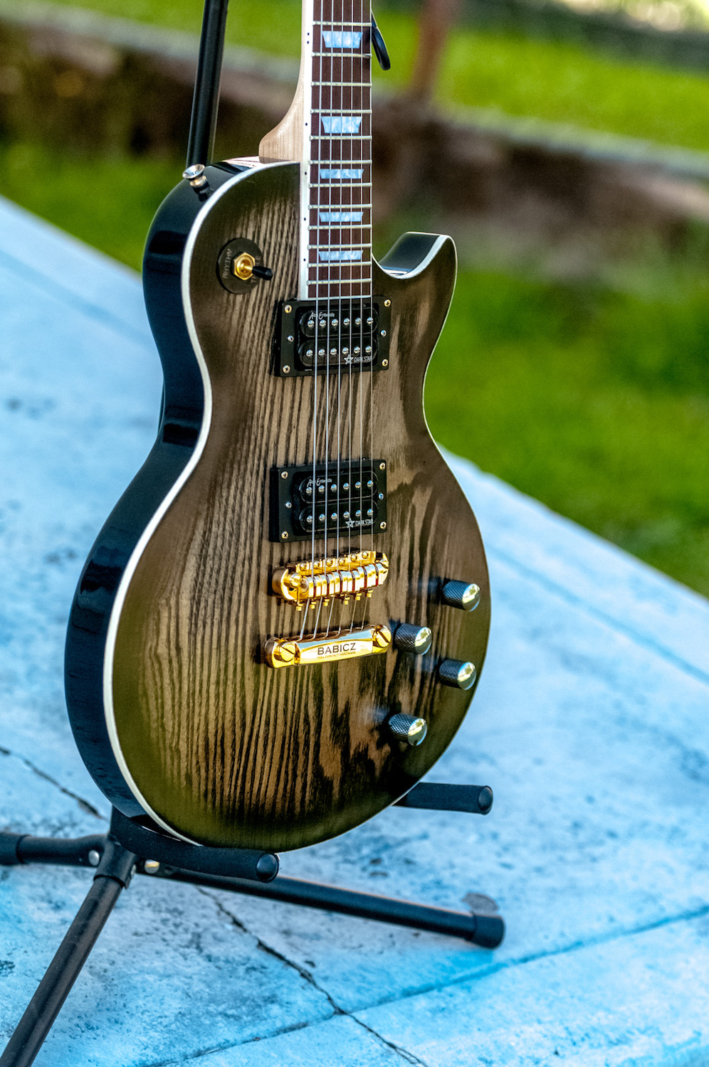

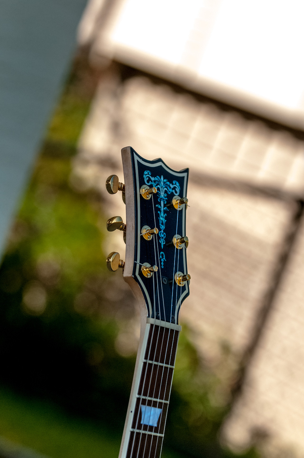

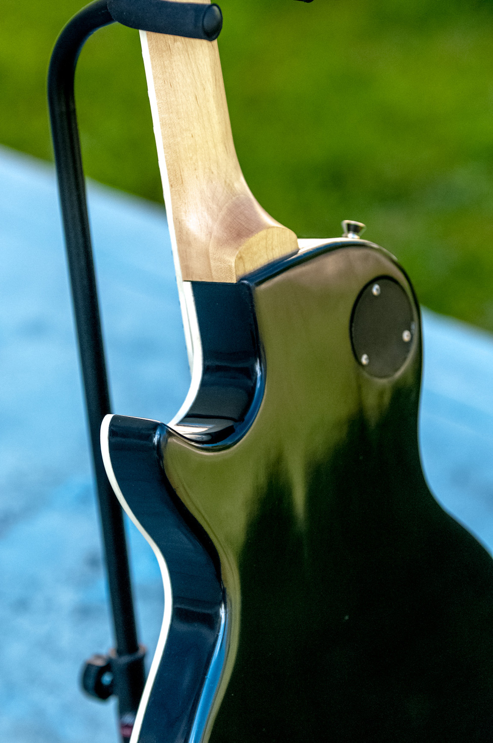

    I have no chance with all these awesome guitars on the forum, but Im just happy that I got mine finished, and sounding as good as it does.
    >>> SOUND DEMO RECORDED (Please don't laugh at me - Im still a learner!!) <<<
    My Soundcloud Demo of me fiddling with my new guitar
    Recorded Entirely on this guitar (drums and bass obviously not of course)
    Finish
    Dingotone Blackstump / FW Black Japan burst
    Dingotone Top Coat
    Black Acrylic side and back
    Automotive clear coat side and back
    2 Coats Tru-Oil for the Neck - Neck finished matt for speed.
    Neck
    Fret Job, Neck Levelled
    Dingobass Bone Nut
    Headstock
    Inlay-sticker Headstock, Hand trimmed face
    Grover Locking Mini Rotomatics
    Bridge and Tail
    Babicz FCH Tuneomatic Gold
    Pups
    Entwistle Darkstar ND Bridge and Neck
    Electrics
    Bourns 500K A/B Push/Pull Pots for Tone and Volume
    Klein Treble Bleed Cap and Resistor Mods
    Sprague Orange Drop Caps
    Jimmy Page Wiring (21 Tone with Phase and splits).
    Some modelling shots - I'll get more later on...

    I wasn't going to enter the comp until I got new knobs (the plastic ones weren't doing it for me, and I only had chrome) but it's done. And hey, I had a great time with the folks in this forum. Im just happy I've been welcomed into such a creative group.
