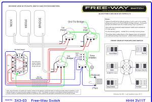

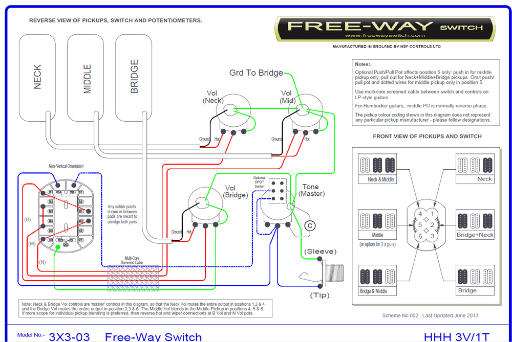

    Is there a reason you want to use a push/pull in addition to the Freeway?
    Weirdy
    in that diagram it showed a push pull to give the 7th option of "everything on". I'm hoping this will work with just a single push pull volume
    Ah yep, I see what you're plannng.
    edited my post

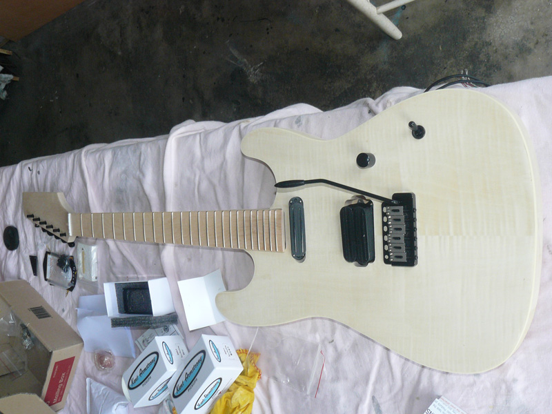

    so, everything ordered. Paint and stain on hand. Might do the neck next week.
    "I approve"
    good stuff Dedman, I put a Kent Armstrong single blade in a tele bridge and it's pretty hot
    It's going to require delicate surgery to fit in the route (neck). I'm hoping I can undercut with chisel and dremel, it's not much that needs to be removed
    you mean the neck pup cavity needs enlarging ?
    I'd use the dremel first, chisels can end up in tears !
    it's only a bee's dick that it needs to open up, if possible I don't want to touch it up the top as I don't intend running mounting rings I'm not real sure my dremel bits are long enough to under cut. I do have some exacto hand chisels usually used with balsa and crafty stuff that are razor sharp that should be able to shave 1/2mm off toward the bottom.
    [QUOTE=Dedman;116121]it's only a bee's dick that it needs to open up,QUOTE]
    Imperial or Metric Bee? You can get little sand paper heads for the Dremels that might assist with what you are doing. Might be better to sand out than cut/rout?
