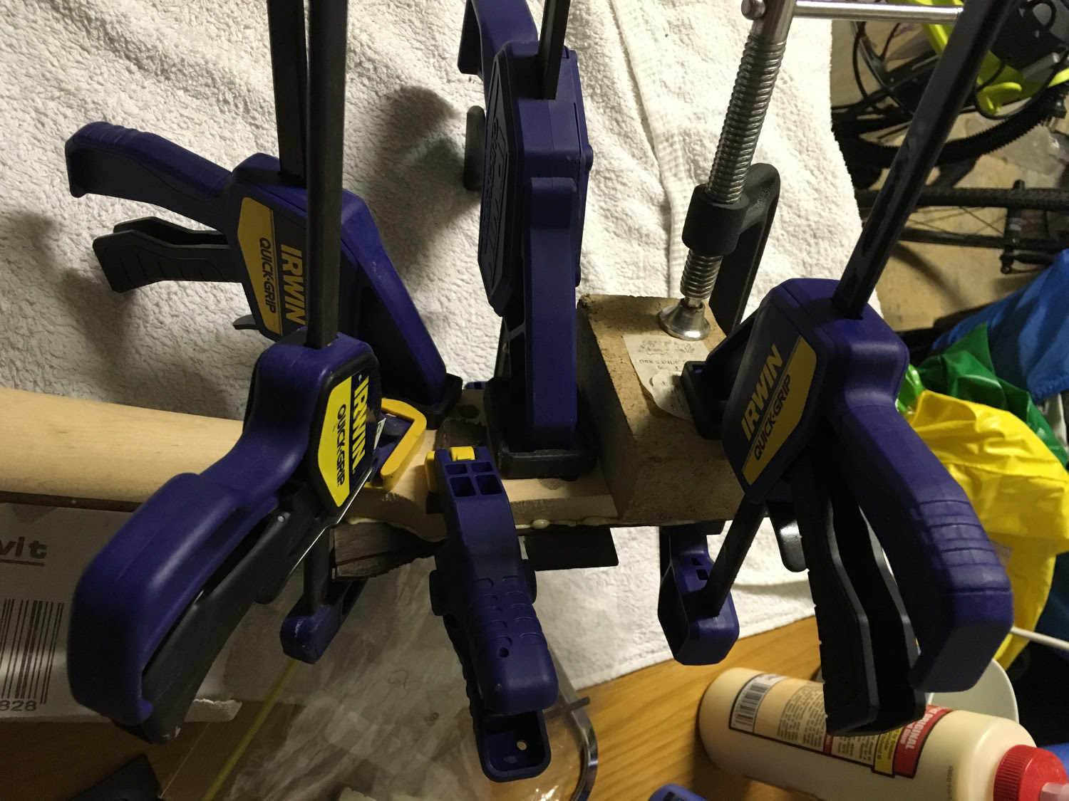

    So what could possibly go wrong in putting a veneer on the headstock?
    1. Attempt number 1. I discovered veneer is very brittle...the hard way...and it split length ways in the wrong place.
    2. Attempt number 2. I discovered that once veneer is placed on headstock it moves around ALOT. Unclamping the next day revealed this characteristic
    3. Attempt number 3. All good, not perfect but considering the steep learning curve ok. And the botched holes are covered....Nut in place to help position the veneer. Picked up some extra small clamps (you need loads of them). Tomorrow evening the nut is to be removed, the truss rod access hole dremelled out and machine head holes drilled.
    Clamps on

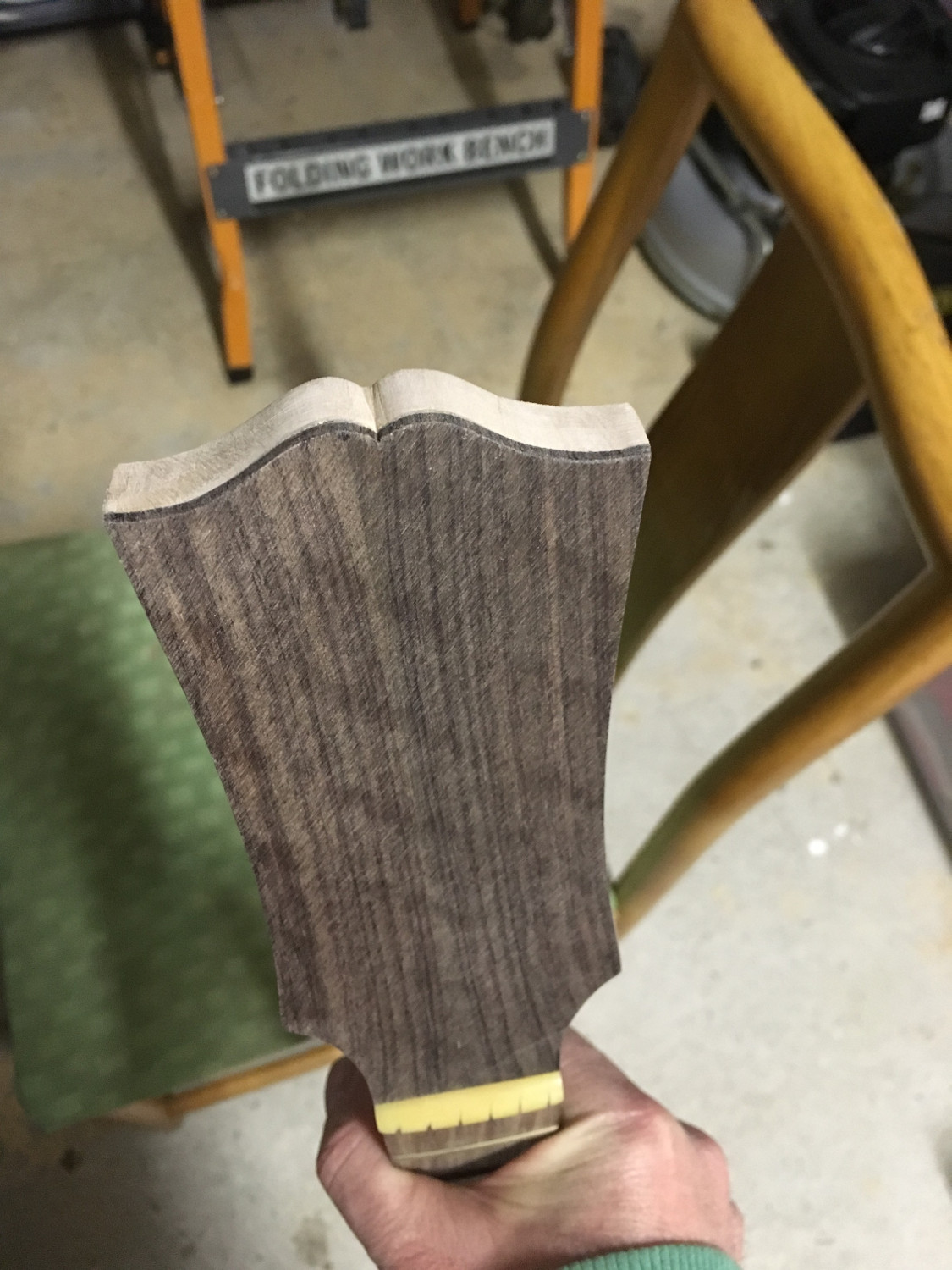

    I then shaped the veneer to the headstock with some files, finishing off with 80 grit sanding. Once machine head and truss rod holes are drilled I'll take a bit of then veneer off depth wise (1/2mm or so) then stain with some diluted FW Brown Japan. So tempted now to try my hand @ inlay.....
    And, I now have great respect for the luthiery skill of veneering, It's a toughy
