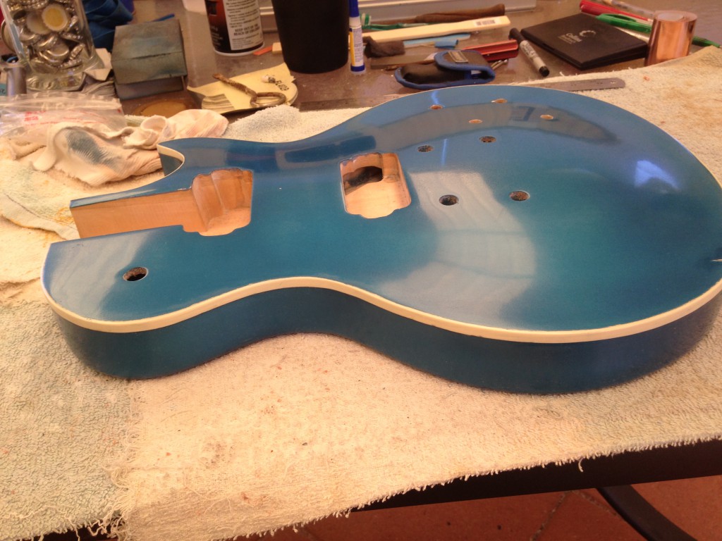

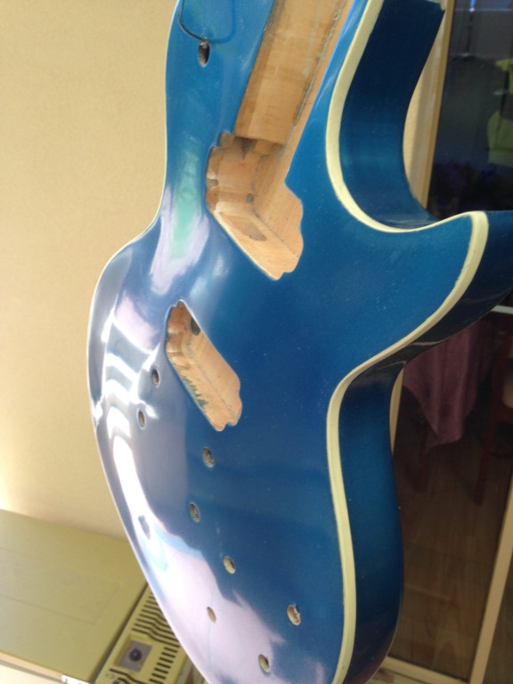

    Have been patiently waiting the gestation period and it was born yesterday. Welcome baby
    Attachment 9459 This photo to show colour and shine.
    Attachment 9460 The light thru the patio sheeting not that good.
    I really want to thank DB and Woks for their advice. I did an experiment on a piece of scrap wood on which I did a couple coats of clear. not because I doubted their advice but to see what happens. Let it cure for 5 days and then hit it with 800 grit wet/dry paper and there were these white patches in the finish. Obviously clear coats not cured. Thanks boys, I'll buy you a beer if ever we meet.
    That is looking the business! Beautiful shade of Blue that. Well done Salo, the patience torture has really paid off!
  2. #62
    well done Salo great results,
    no drama the forum is here to help every builder get the best results, and the least amount of mistakes and re-do's.
    Patience definitely pays off when clear coats are curing !
  3. #63
    That blue is awesome Salo! She's going to look amazing all assembled.
  4. #64

    Thanks fellows. I'm pleased with it and so is my 8 year old grandson (I'm building it for him)
  5. #65
    Top job Salo, looks nice
