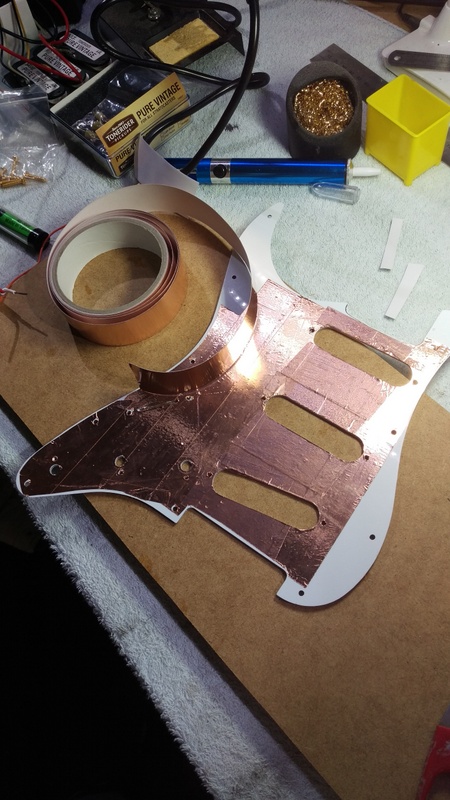

    So, I'm on leave and the weather is just rubbish here in Sydney, so I thought I'd finally get started on the electronics for the STA1M.

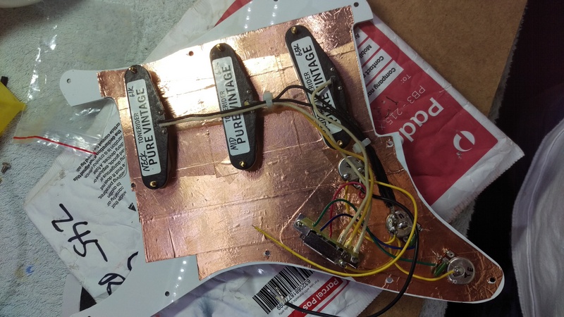

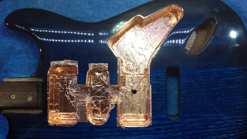

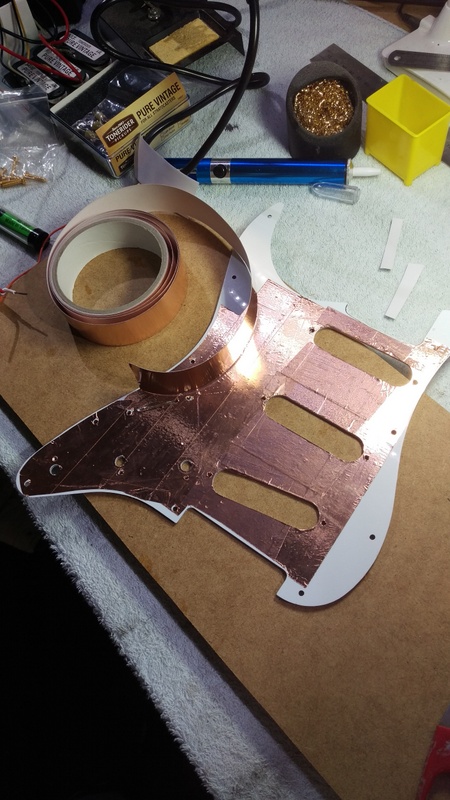

    I removed everything from the pickguard first, and applied copper tape everywhere:
    I used a mix of tape I got from PBG and a roll of snail and slug barrier from the green shed.
    The snail and slug barrier is actually a roll of copper tape, and it's narrower than the PBG tape so was good to get in corners and small spots.
    Once installed I tested continuity with the multimeter and all good, even without any soldering. Pretty happy with that.

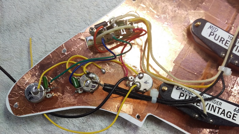

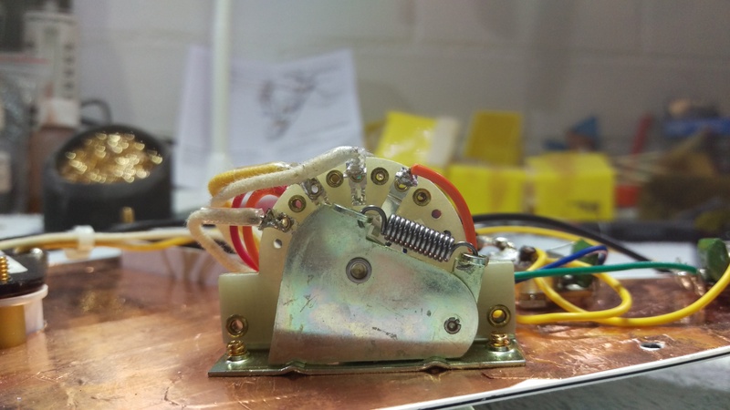

    Next I installed the tonerider pure vintage and re-installed the pots and the switch.

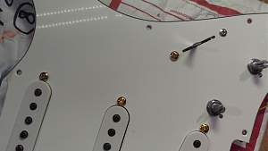

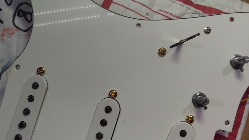

    I had ordered gold screws for the pickups and the switch as I didn't want to have a few chrome screw heads next to the pickguard golden screw heads.
    No issues with the pickup screws, but the switch is a problem...
    The gold screws I got are slightly bigger than the one that came with the kit... and they don't fit in the switch holes. I thought I could just enlarge the switch holes with the drill. I did one, but it didn't work... and because I've drilled it, the original screw is too small now... bummer...
    So for now I've installed the switch with one original screw, and I've soldered the golden screw in place... pretty 'ghetto' and it's not tight enough.
    So I've just ordered online a new switch (I used that as an excuse to upgrade to a good one), and a new set of gold screws as I think I messed up one...

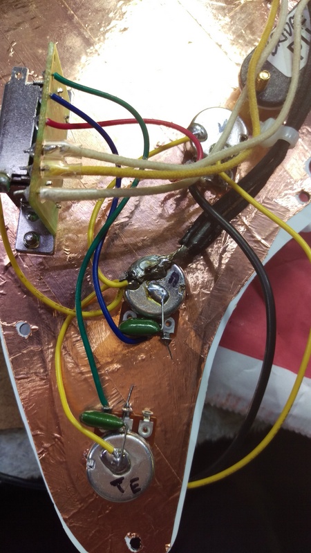

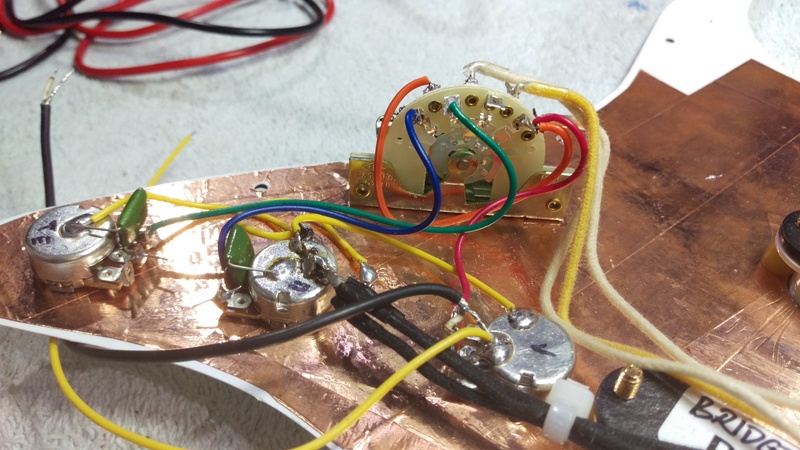

    Anyway, I still soldered it all together so I can test it while I wait for the new switch.
    Talking of soldering, I had not touched a soldering iron since I left uni... 18 years ago... and I struggled big time... pretty ordinary considering I've got a master in electrical engineering!
    I managed to solder the pickups grounds to the back of the pots where I removed the old ones from... but I was scared I'd cook the pot...
    Looks like I'd better watch a few 'soldering for dummies' youtube videos!!!
    Here are a few pics of the pickguard completed:
    The switch with different screws:

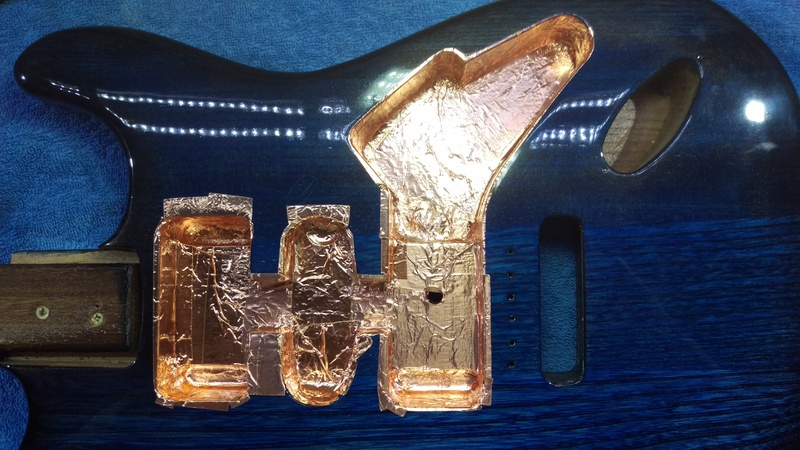

    And because I still had some time, I also shielded the body cavities:

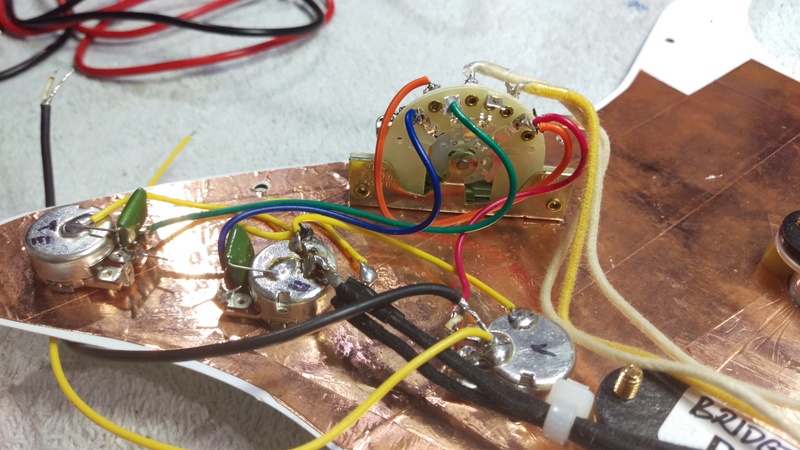

    So I received the new 5 way switch (CRL 5 Way Switch) and I replaced the one that came with the kit with this one:
    I had to bend the connectors and wires as this switch is a bit deeper than the initial one and I was concerned it would make contact with the cavity shielding.

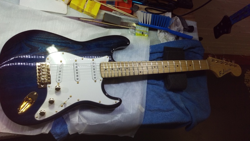

    And then it was time to put it all together!
    Pretty happy with the result I have to admit! There's a few small defects but I can live with them and I'll put that on the lack of experience for the first build.

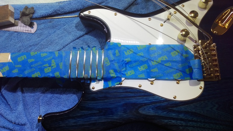

    While the strings were off I reversed most of the corrections I did, straightened the neck again, lowered saddles and I saw on Gavin Turner's blog that he lowered the six last frets to help lower the action, so I did that:

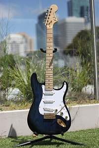

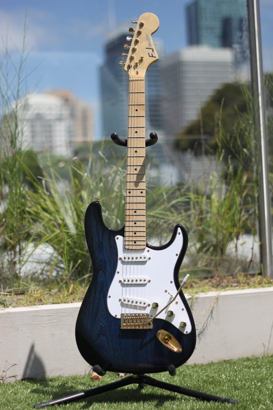

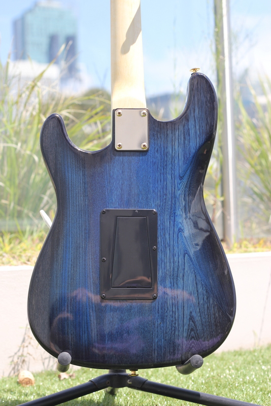

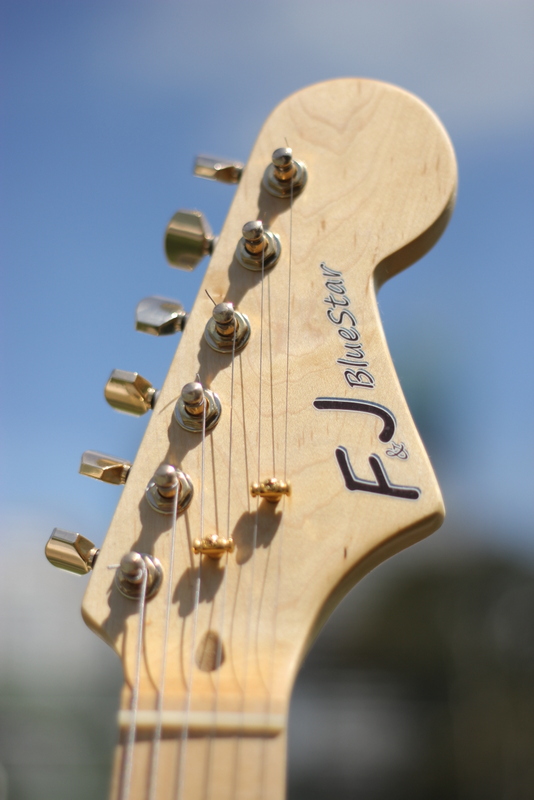

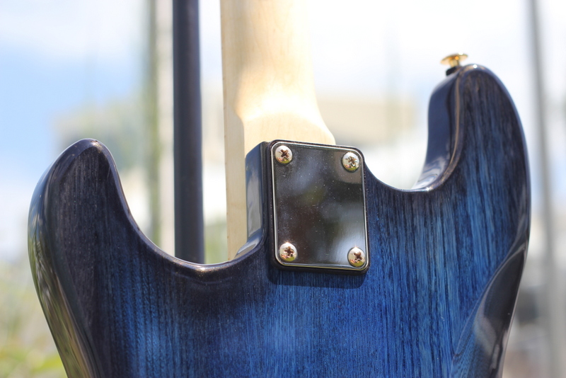

    And now that the guitar finally looks like a complete job, I took it out in the sun and had a bit of a photo shoot session, looks pretty nice!
ID:	7529 Click image for larger version.
ID:	7531 Click image for larger version.

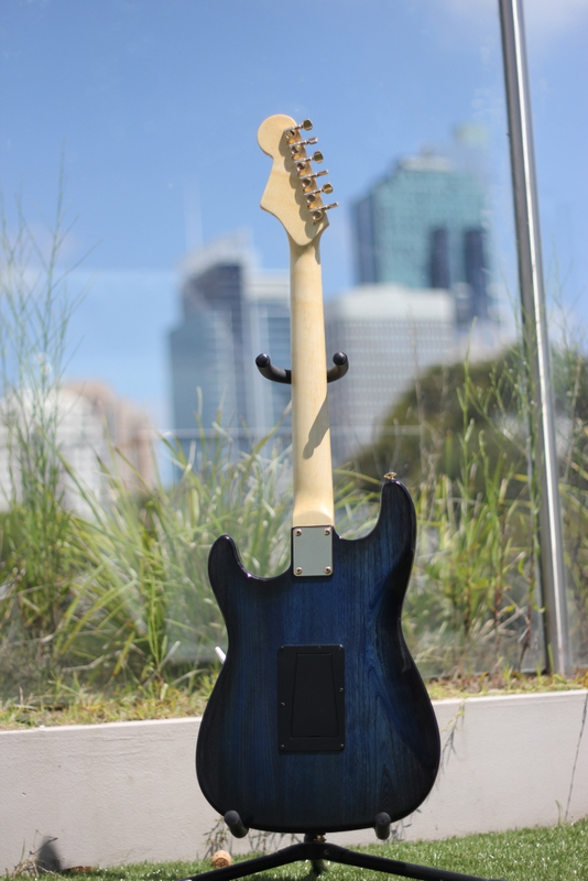

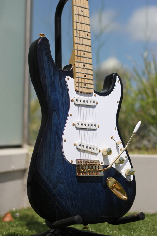

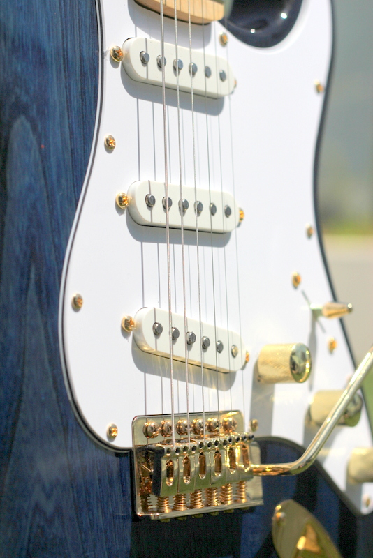

    And a few more:
ID:	7533 Click image for larger version.
