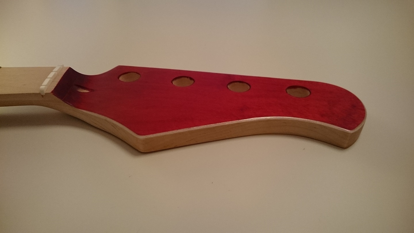

    Hi
    now got some pics for you but sorry about the quality of them - some are with flash and some not. The colors are a bit different in real life but you get some kind of idea on the result. Havenīt cleaned the binding yet so some stain is visible there. As I said before - the parts have two coats of TO on them to seal the color in.
    Anyway - here it is:

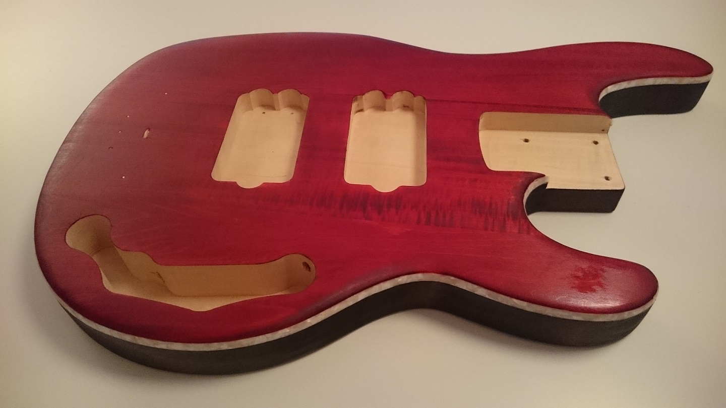

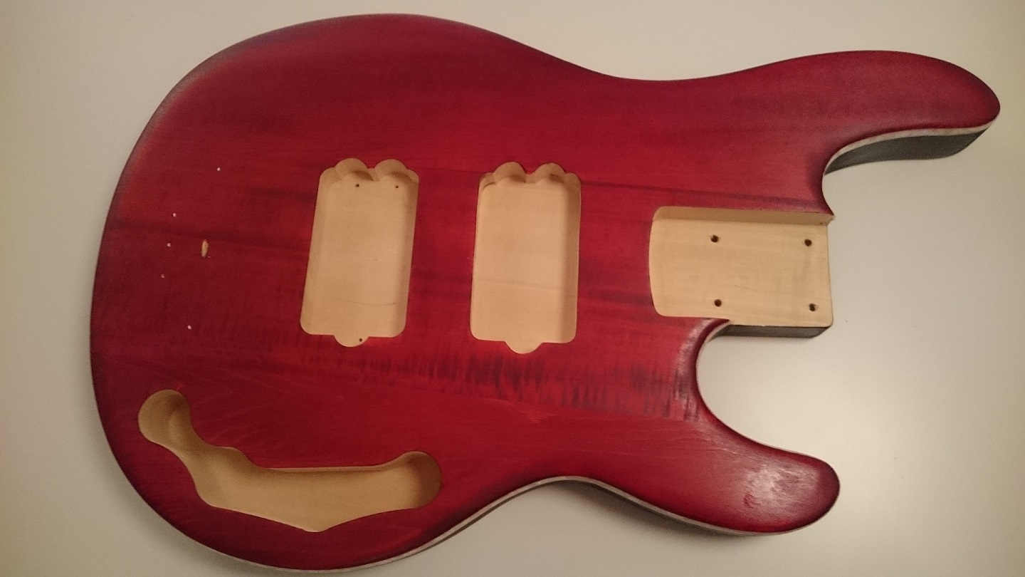

    The body top:

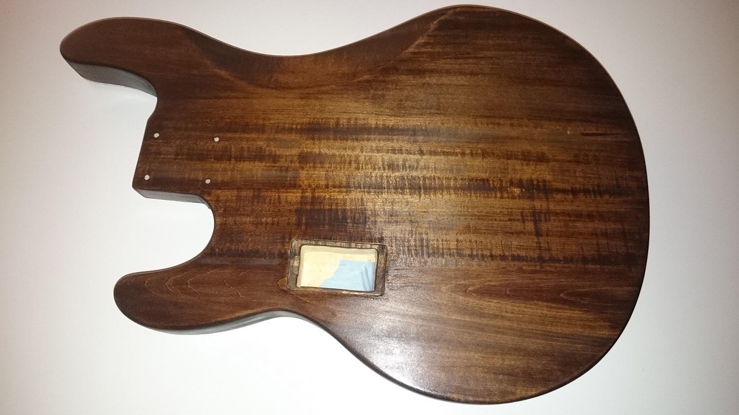

    The back:

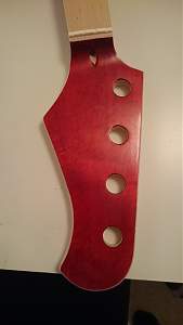

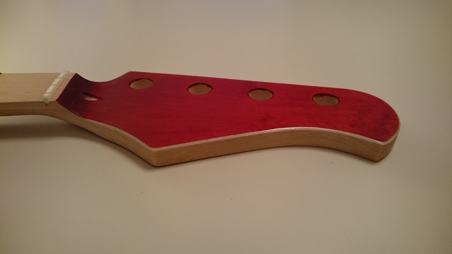

    The headstock:
    Now itīs just TO after TO after TO after wet sand after TO and so on... will take some time to build up and I have to order some until I can continue. Still - feels good to get rid of the sanding and move forward.

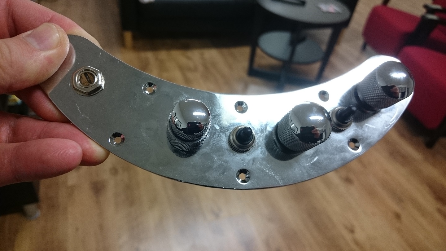

    Hi
    got the mini switches placed on the control plate. Seems to fit just about. Switches are really MINI but still work ok and no chance Iīd hit them by accident even though placed this way.
    TO finish is coming up slowly but anyway. The neck has about 6 or 7 coats and body about the same. Should be able to do the first TO wet sandind later this week. Canīt do more than two coats a day at home - only possible after the kids are asleep. Frustrating at times but should have the finish ready in couple of weeks. Then itīs Pickguard and assembly time...
