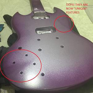

    I thought i'd give it one last go. Just had to be careful with spray can, hard to control but I think this is going to be the best i'm going to get with out a proper spray Has some nice new "features" now too lol.
    If you look at the close up you can see how splotchy it is, prob not going to be able to pro level burst without something like an air brush but I'm fairly happy with it.

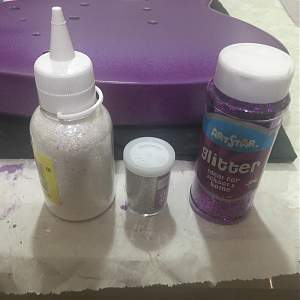

    Because I got the bad boyz to play with next. All the cool design I'm going to be able to make with these
Name:	34. Glitter.JPG

    That looks 100X better man, you'll be glad you took the time to refine it when it's all finished, great job!

    Just looking at the overspray mate, get your can moving before pressing the nozzel, and keep it moving after you let go : it will help the starts and stops look more even.
    Same thing when you step up the a sprayer

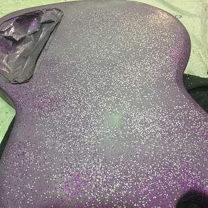

    Hmmmm first glitter test didn't turn out as I had planned.
    Looks like the guitar has some kind of disease. hell no!
Name:	35. Glitter Test1.JPG

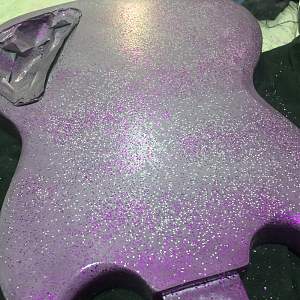

    So sanded it back to mostly whitish dots, I don't hate this enough enough to redo the whole back.
    So I guess it stays
Name:	36. Glitter Test2.JPG
    The problem is the glitter flecks are too big, will shop around for sand grain sized dots.
    Actually, I do hate it enough to sand the whole back down again. Here we go again.

  7. #67
    Bummer. You need to look for metal flake rather than glitter. Paint shop rather than art supplies.
    Something like this
    Also, once the flake goes down, you shouldn't sand, just need to bury it in clear. Sanding it will take colour off the flake and give you silver spots as you discovered.
