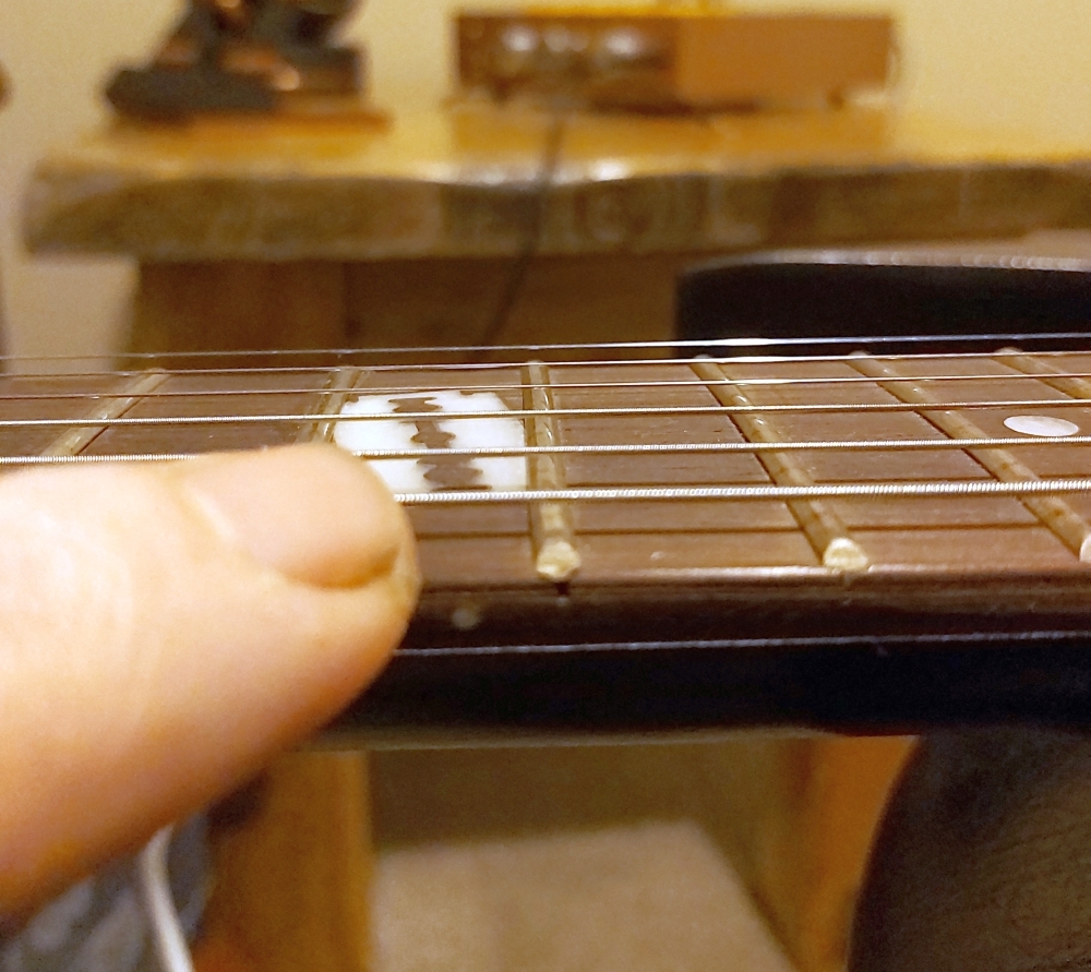

    Trevor was right, throw some strings on it - it actually came up really well. Almost perfectly flat and straight - maybe the slightest convex curve; very faint almost indiscernible.
    What is a problem is one fret, the 12th. I had trouble with it earlier, it was slightly raised when I was starting to work on it.
    Now, it's raised so playing anything lower than that fret on the E, A, D strings sticks on that fret and rattles. It's not too bad on the G, and not really noticeable on the top E and A. In fact though, playing the note just after the (lower) E where the fret is, then one note down, it's exactly the same note because of the height!
    This model of guitar doesn't allow to adjust the action / height as far as I can tell (there're intonation screws which I'm leaving until I resolve the fret issue)
    I trying carefully tapping on the fret with a nylon hammer - no luck.
    The only three things I can think of doing are:
    1. Trying to file a fair bit of the fret off, by loosening the strings and very gently with a needle file try to lower it.
    2. I'm not sure if adjusting the neck screw will help (?)
    3. Taking it to a guitar shop after his birthday and asking for them to replace the raised fret.
    I've attached a pic. And one of the finished (almost) guitar. The wiring and everything is fine; it has a nice sound. No hum or anything - the ground wire etc went well. Downside - you can kind of only use 1/2 of the guitar....
    I'm leaning toward option 1 until I can find someone to have a go on option 3.
    Happy to try option 2 if anyone thinks it's worthwhile
    Off to sleep now, the guitar has beaten me today. I'll check in tomorrow

    Hi Barno, it is looking great!
    The neck should be slightly concave with the strings on. Also, have you gone through the process for setting the action (string height)? It is difficult to tell in the picture if the strings are at a good height.
    Maybe the truss rod could be tightened to increase the concave curvature of the neck. The bridge may also be raised a bit using the screw in posts. These will raise the strings a bit!
    As far as the 12th fret goes.
    I'm not sure if it would need to be replaced - but It may need to be filed down a bit! Do you have a 12 inch radius block, fret rocker and fret file? I would not use a needle file. Maybe a small flat file could be used! The frets need to be rounded at the top - I use a fret file for this.
    The neck screws should not need adjusting. Option 3 if needed!

    Hi guys for your notes.
    Just to recap what I've done (previously) - I did the sharpie marker, straight edge, and very gently sand any high frets - it seemed ok at that point. I had to do very little sanding. The little 12th fret b**std has kind of risen a bit.
    I may have got my convex and concave slightly wrong - in fact I think I have. I attach a pic where I measured the gap between the string and the actual fretboard. At the head, it's 2.4mm, and the pickup end 2.7mm, on the 12th fret, 3.1mm. In the second pic, my guitar is like example 3, very very slight bow. So it's not too bad?
    I won't be able to buy a special crowning file before Finn's birthday (Saturday) but I could use the technique in that video to see if I can take even 1/2 mm off. It should be just a few bits of masking tape and I have 400,600, 1000 sandpaper. (I have found an online store in NZ that actually sells 250mm length of frets so it might be possible to remove the old fret and replace).
    So I've done the levelling already and the frets *were* pretty good.
    I looked at all four of John's videos. I can do some of the things he's talking about, after filing a little bit.
    1. I can (with strings on, I guess), turn the truss nut (using the allen key provided) 1/8th of a turn clockwise to get the last tiny bit of concave out of the neck.
    2. My bridge doesn't allow for strings to be individually adjusted for height. I guess I could take the bridge off and pack it up with a thin washer on each side. This would just make the strings even higher?
    3. Video 3 talks about filing through the neck nut - I don't think I'm brave enough to do that (I don't have feeler gauges, proper super-thin guitar files etc)
    4. Intonation I can do - Pit Bull had a video explaining how to adjust using open strings then on the 12th fret.Click image for larger version.

    Hey Barno
    That axe is looking very cool, nice work!
    That 12th fret looks like it has become "unstuck" so I think it will probably keep moving about over time through playing and environmental changes etc. (in my limited amateur opinion). I'd say it probably needs to come out and be replaced or reset. If it has been filed to level it before and then is reset, it will probably then be sitting too low compared to its neighbors.
    If it were my guitar, I'd take it to Rob Matthews guitar repair in Wellington. He's a great luthier and a top bloke, I highly recommend him. I believe he is operating out of the CBD. You should be able to find him on Facebook to make contact.
    I hope that helps!
