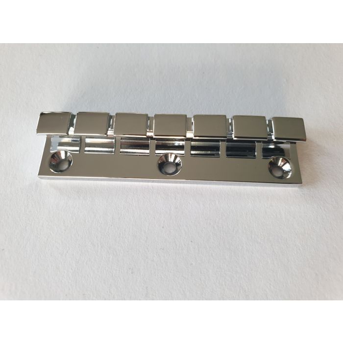

    There are at least two things that I would do with the original body. On both sides of the center block, I would glue a small block of wood right next to the bridge posts. Any kind of wood is probably fine. It doesn't need a lot of lateral strength, but it's also not worth risking a break through.
    I would also not use the stop tailpiece that came with the kit, even with a piece of wood glued next to it. You want the tailpiece posts to be really solid so that they do not pull out or spin. On my bass build, when the post broke free it spun, canted laterally and made it impossible to adjust.
    If you feel you must have a stop tailpiece, I would use something like this:
    It is only 71mm wide so could be mounted solidly in the center block.

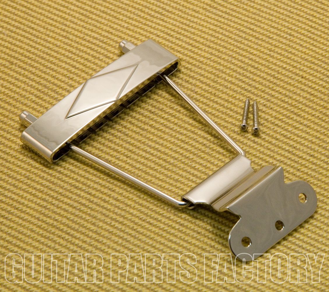

    My preferred option, though, would be to get a trapeze tailpiece like this one:
    I have a trapeze on an old Fender Coronado, and another on my ES4-B Pitbull bass. In both cases they work great. You never have to worry about pull out with a trapeze, and I can't really tell any difference in resonance or sustain.
    By taking some careful measurements, and using the adjustment nuts you should be able to position the trapeze in such a way that the bar at the top hides the holes. The one in the pic costs $20. There are a lot of them around for guitars, so you should be able to find one that covers your holes.
    Patching the holes is not difficult. Years back DingoBass had a thread about how to do it on this forum. If you are staining, the only thing you really need to be careful of is that you don't sand too hard when leveling the maple plug you put in the holes to patch them. If you can't find Dingobass's thread here's how I did mine:
