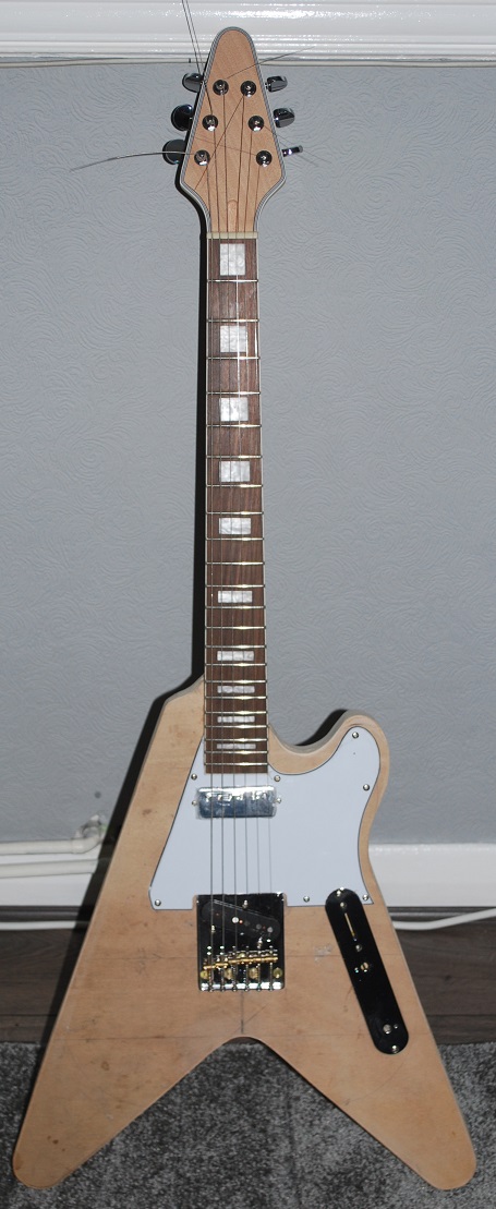

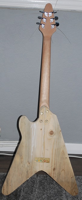

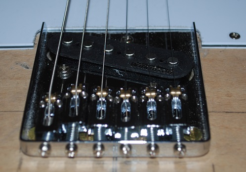

    I got a bit done on the TV and assembled for check and playability test. Not wired up at this time but I have some issues to address. The nut is way too high, I may fit a brass or bone one as the plastic one seems pretty low quality. The neck is a touch high around the 9th to 12th frets so some truss rod adjustment is needed. The round brass individual bridge saddles don't work, they force the string set 3 mm or so to the treble side and the strings foul the spring between the saddle and the base where it passes through the body. It also affects the position of the string relative to the pickup poles. I believe that I have some square type in-line saddles that will solve this problem. These round saddles obviously need the adjuster screws to be offset, which is another option, drilling holes to the left of the originals in the back of the bridge plate I think that I used up all of my set-up luck in earlier builds that just fell into perfect action and intonation!
    I fitted my 6mm brass ferrule/anchor block and a strat type jack socket
    The pickups are a Voodoo Vibe mini humbucker in the neck position and a Wilkinson vintage in the bridge. The scratch plate has, I hope, added to the hybrid feel by mimicking the body either side, and the control plate also follows the body line. ( lessons learned from Sonic with lines etc!) The neck joint is an attempt to smooth things out, losing the Tele square block, still some work to do there.
    I think it works dimensionally (I reduced the horn size) it is very comfortable in the sitting position (not fitted strap buttons yet) I may relieve the back top edge a little to lose the tele squareness a little. It is light and relatively compact and I hope will eventually be a nice instrument to play. I do think it still looks a little bit awkward (particularly from behind) but I can live with it!

    A bit of work on the neck and I am nearly there. I decided to fettle the original plastic nut before making a new one. I had to cut in about 3mm to get the action right and this actually revealed not a truss rod issue but two high frets, 10 and 17. I shall dress those in due course but am basically very happy with the general action now. Once I replace the saddles and make a decent nut I am pretty sure it will be a nice player. For some reason I strung this one with fender 9 - 42's and with a 24.75 scale this will be a real string bender

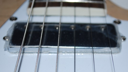

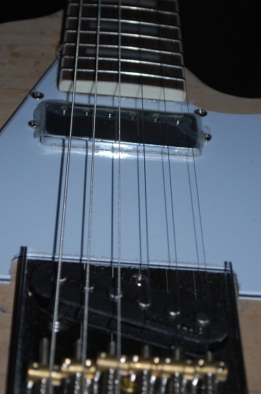

    I seem to be chasing the buzz/dead notes at the moment and would appreciate some guidance, particularly from you neck building guys.
    As stated previously, I seem to have run out of my easy set-up luck and this one is proving a bit difficult.
    I have solved the string alignment issue by using a set of roller saddles. They have put the strings more central and the only issue now in that respect is moving the neck pickup a mil or two toward the treble side for better pole positioning.
    I invested in a toothed fretboard straight edge and a trapezoidal fret rock indicator together with fret stones, fretboard protectors and a crowning file. The straight edge showed a dish in the middle which I cranked out with the truss rod (about 7/8 th's of a turn clockwise) This then proved that I had cut the nut slots too deep (not too concerned as I am replacing the nut anyway) By temporarily packing the nut slots with tinfoil and adjusting the new saddles, I achieved a fairly decent action with good intonation over most of the fretboard. The rock detector confirmed the high frets at 10 and 17 and I will work on those once I have replaced the nut.
    My questions are these; did I do this in the right order? i.e. neck straight, nut, saddles, frets. or have I approached this wrong? Is there a definitive method of setting the neck with an ordered procedure to ensure its not one step forward and two steps back?
    It seems to be a bit of a dark art and is obviously why luthiers are highly skilled artisans, some pointers would be most welcome
    Pics show the new saddles and neck pickup misalignment

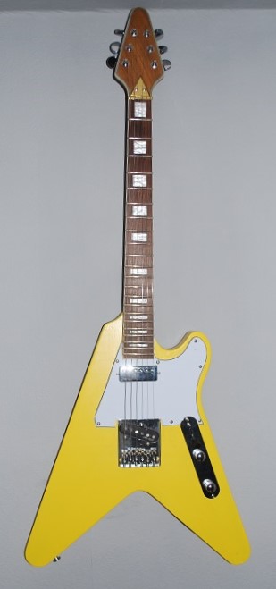

    So, after a period of ill health and family woes, I thought i had better finish this as it was languishing in the corner of the garage for about a year! How time flies! Finessing the frets after following the above advice paved the way to finish it. I thought as its a bit of a marmite guitar I would use a marmite colour, but friends seem to have warmed to it! It sounds great with the P90-esque on the neck and the Wilkinson on the bridge, a good tonal range and balance, the brass nut and anchor block add brightness and through some new effects from Sonicake that I was given, it is a real screamer too. Probably the last I will build for a while, although the excitement of plugging in and discovering the guitar certainly got the juices going a bit! I am sure that the resultant successful sound was more by luck than judgement, but I have picked up very expensive instruments and been disappointed with the sound and feel. This is quite a light weight guitar made with scrap wood, the bought in Gibson scale neck with light gauge fender strings is very playable, so all in all very happy! I am grateful to all the contributors to this site for their advice and comments, I now have a selection of guitars that I created and would not swap them for any other, thanks guys!
