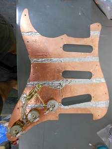

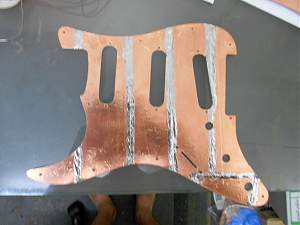

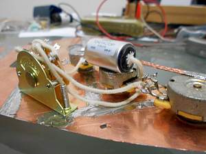

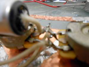

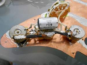

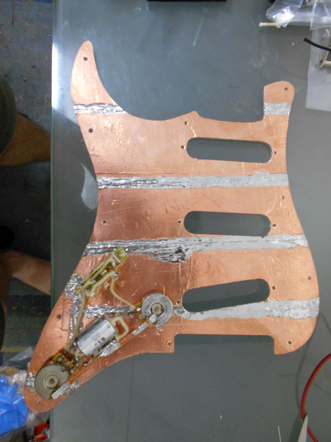

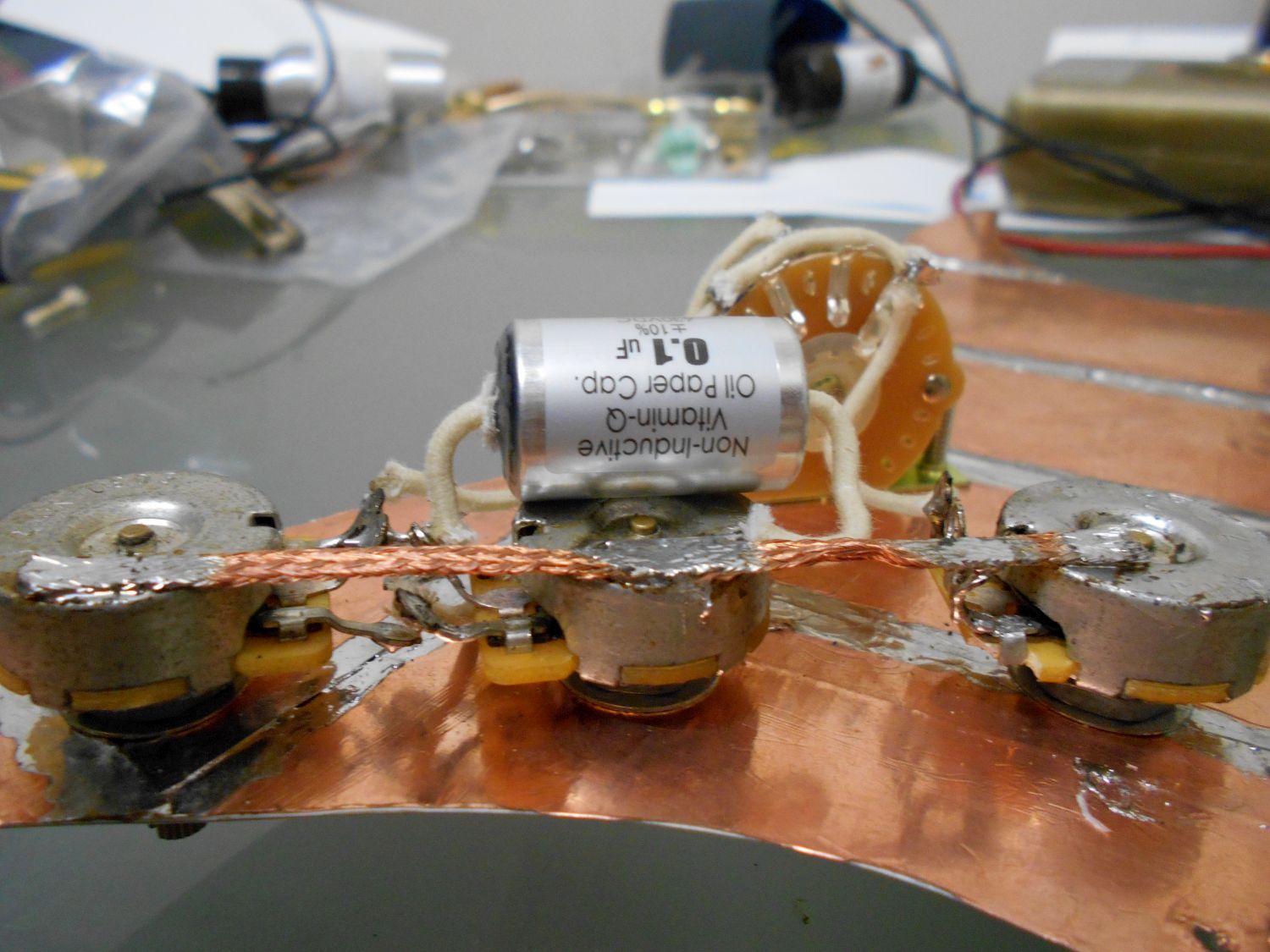

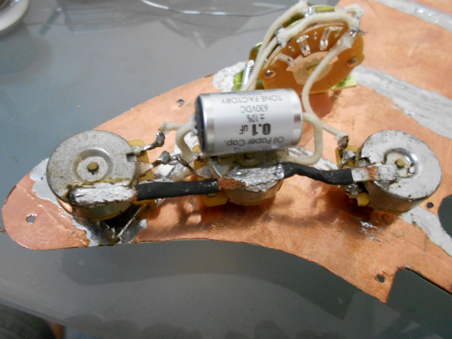

    Update:
    Well, I've finished doing as much of the scratchplate wiring as I'm able to do, because I'm still waiting on the Entwistle ASN57 Noiseless pickups to arrive in the post, and also for the Strat body to finish drying, there's not a whole lot I can do in the meantime, yes, I could order another guitar kit but I'm low on money as it is, anyway, here's some more pics of the progress I've made so far on the scratchplate:

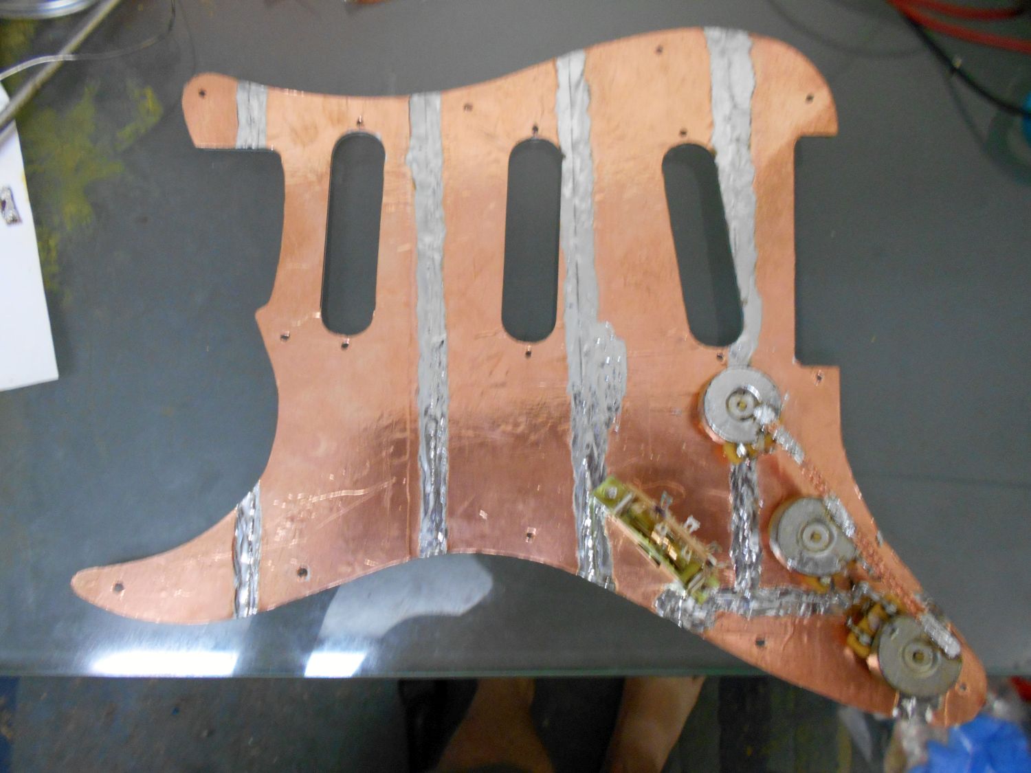

  5. #614
    Here are some more pics of the Scratchplate:

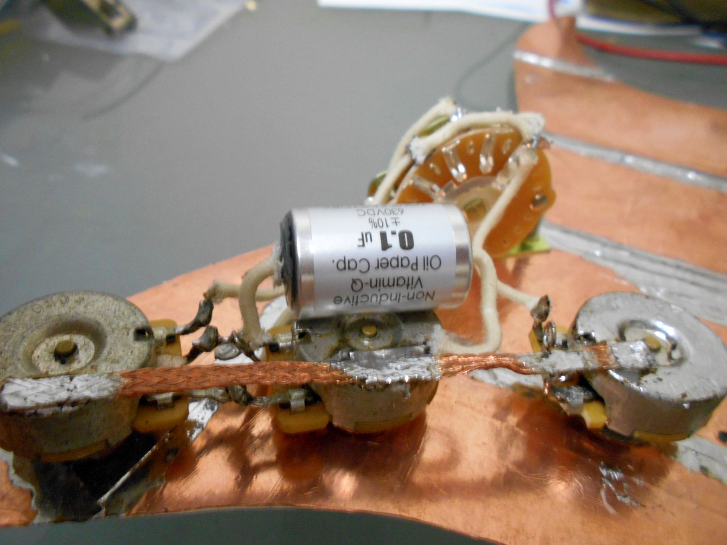

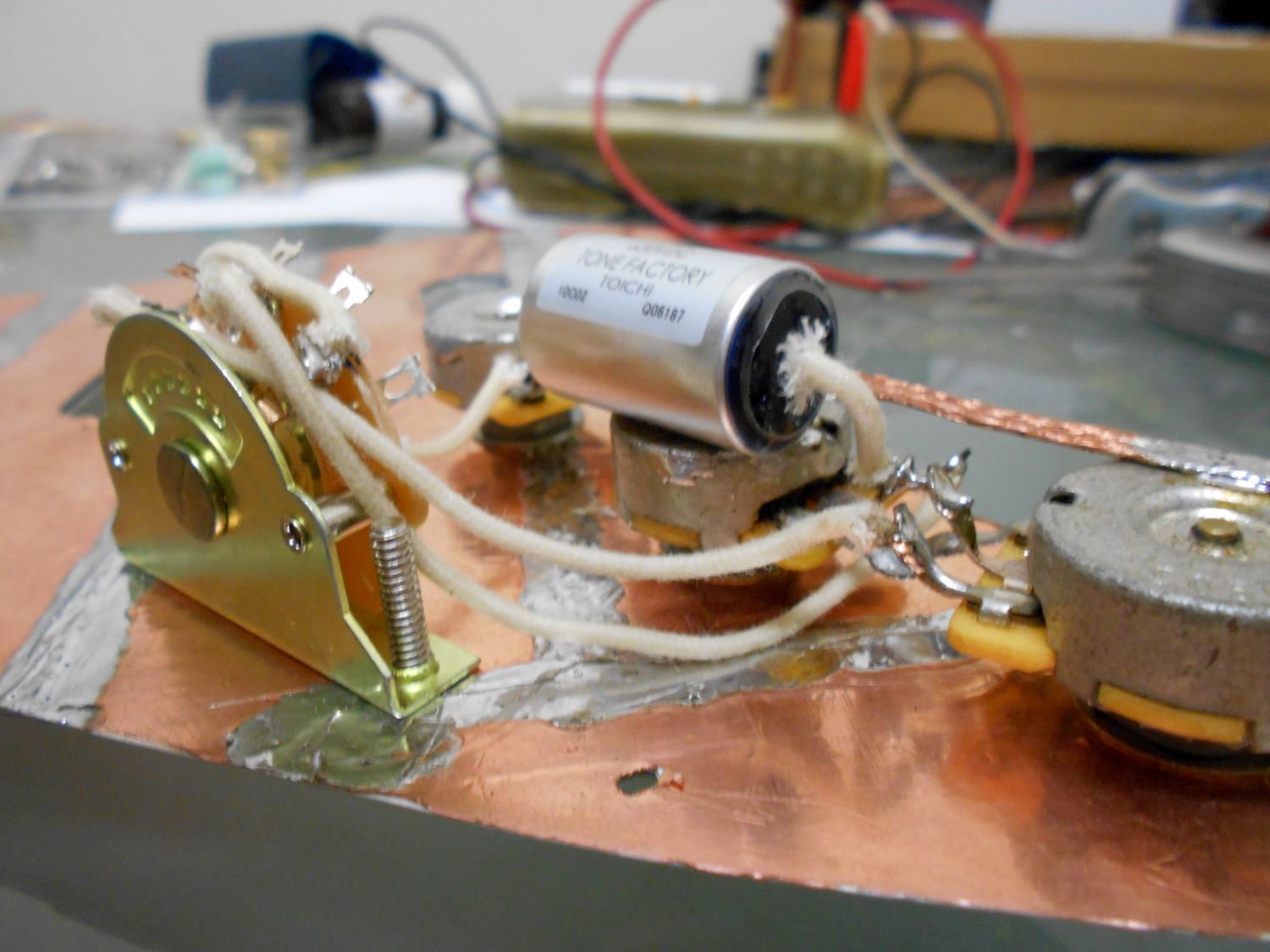

  6. #615
    So, as you can see in the pics, I put a lot of shielding on the Scratchplate to create a great big ground-plane, hopefully that'll make my guitar relatively noise-free, you can see where I have soldered the individual strips of copper-foil together where it's a silvery-colour, all over the Scratchplate I'm getting a reading of 0.02 Ohms which is good, I linked the three pots together with some copper-braiding I salvaged from some old microphone lead, this is to ensure that there is still a ground-path if the copper-foil wears through underneath where the pots mount on the Scratchplate, all I need to do now is wait for the new pickups to turn up in the post so i can install them, the output-jack is going to be attached to the Volume-control pot via some vintage-style shielded cloth-covered wire.
    You can also see the Vitamin Q .1uF/630V DC Tone Cap installed on the scratchplate, I had practically no issues with overheating while soldering the cap in place, you may also notice that I put a piece of cloth-wire insulation on both solder-tags of the cap, that's partly to prevent unintended short-circuits, and partly for aesthetics, hopefully everything is working correctly.
    Incidentally, I have wired-up the Scratchplate Eric Johnson style so that it follows this setup:
    Pickup Selector:
    1, Neck Pickup + Tone 1.
    2, Neck Pickup + Middle Pickup + Tone 1.
    3, Middle Pickup.
    4, Bridge Pickup + Middle Pickup + Tone 2.
    5, Bridge Pickup + Tone 2.
    Note that Tone 1 on a Strat is the one closest to the Volume control, and Tone 2 is the other Tone control next to Tone 1.

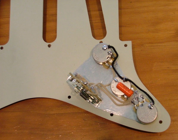

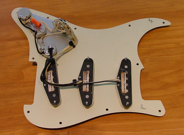

    Hey Doc i would cover that earth wire with some heat shrink.
    Heres how i vintage wire a strat, this is from one of my builds.

    Quote Originally Posted by tonyw View Post
    I'll give that a try, I think I have some black heat-shrink tubing that might be the right size to fit over the braiding I used, cheers for that.

  10. #619
    As per tonyw's suggestion, I've put some black heatshrink-tubing on the braided earth wire strung between the pots, here's what it looks like now:
    The heatshrink-tubing actually does serve a practical purpose, it stops the Tone1 pot from shorting out the Tone Cap against the earthing braid.
