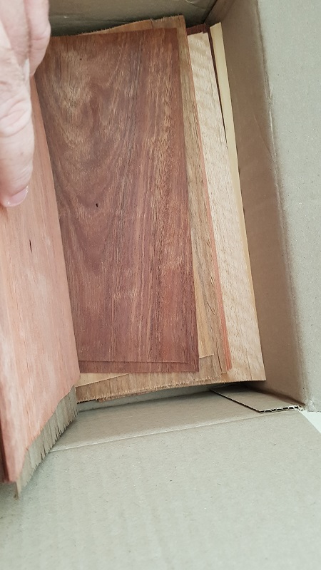

    Home after a day in the Uber car. TOPVENEER have been awesome with their postage and my veneers have arrived. I got heaps of them and the veneer tape. The light coloured veneer in one of the pics is the one to make tail feathers with I think. Looks great.
    https://www.topveneer.com.au/product...ry-mix-0-75kg/
    https://www.topveneer.com.au/product...e-20mm-x-200m/

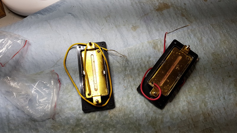

    Sad face moment.....dragged the pickups out and they are one cable with two cores.....bugger. So not really much electronic fun here for you Weirdy. Sorry. Unless you have some evil thoughts with a twist.
    Can I ask? Which is the neck pickup.....yellow or red wired one? Does anybody know?

    And higher impedance.
    The wiring diagram indicates red=bridge, yellow=neck. But it's worth checking the DC resistances with a multimeter just to make sure. As Waz says, the bridge should be higher resistance, indicating more turns of wire to compensate for a lower string vibration amplitude at the bridge, compared to the neck position.

    Great advice. Thanks guys...I shall drag the multi meter out this afternoon and see what we have.
    The wiring diagrams do have the yellow to neck and red to bridge....just checking in.
    Any idea what sort of resistance is the norm for Mini Humbuckers?

    I just measured the resistance on the pickups.
    The red wired one shows 8.28k ohms.
    The yellow wired one shows 8.65k ohms.
    Their does not appear to be much of a difference, but the neck pickup (yellow wire) does have a higher resistance.
    Interesting numbers though. I did some wandering around Seymour Duncan website....and the resistance numbers on some of theirs run to 16.7k...wow.
    But all of the have lower output neck pickup resistance....down to 6k.
