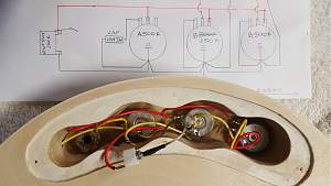

Like FW's mine also has the mini humbucker cutout a little too close to the end of neck. I think the answer will be to widen the recess on the bridge side of hole, comments please?

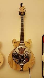

My cone appears to fit OK into body without any additional machining unlike FW's. It's 40mm from top face to bottom of recess. The bottom of recess is wafer thin and under it there's reasonable size air gap before the outer ply back.
