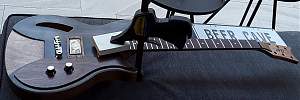

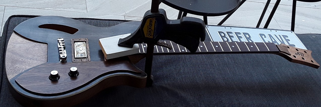

ID:	24692Click image for larger version.
ID:	24693Click image for larger version.
ID:	24694Click image for larger version.
ID:	24695Click image for larger version.

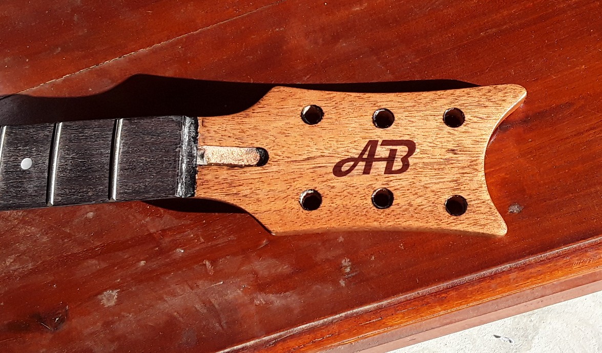

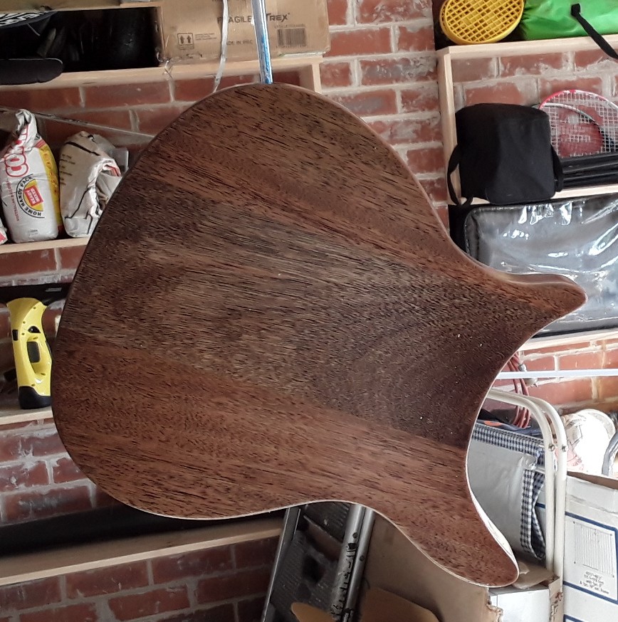

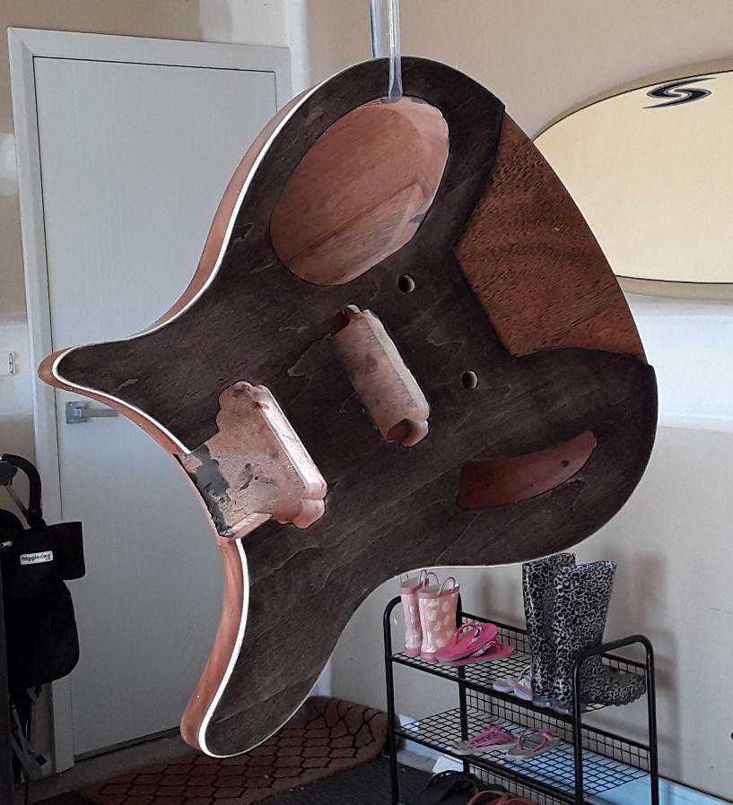

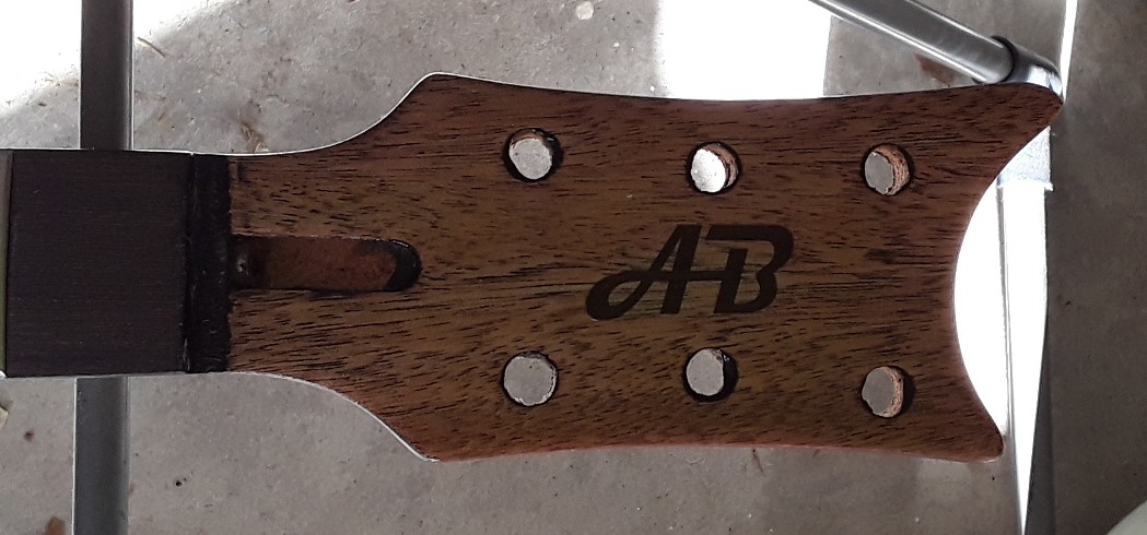

    Up to 5 coats of t/o and a water slide decal, starting to get a bit of shine about it

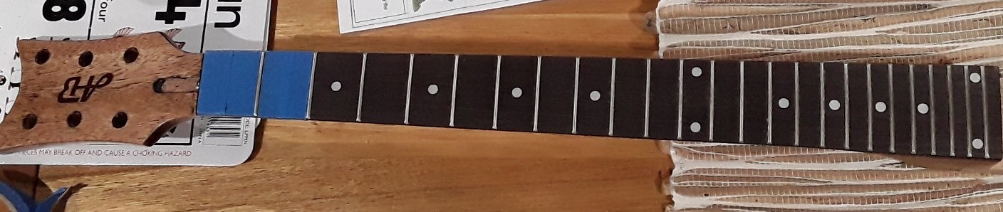

ID:	24769 while waiting for some more t/o to arive i decided to straighten the neck and top the frets, after seeing 1 pr 2 have issues with the composite wood pulling up with the tape i put some dingo wax on first and buffed it up before taping, it all worked a treat. I must say i wasn't really liking the feel of the plastic wood but after putting on the dingo wax it really came up nice and smooth and feels a lot nicer too touch

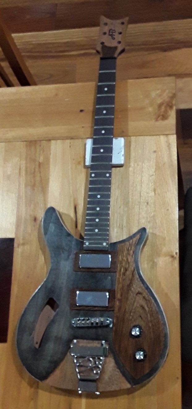

ID:	24820 with the neck set i couldn't resist a mock build, the roller bridge also turned up, i really like the feel of them in the grs and es1tl so thought id use one here as well. Ive dacided to use 2 volomes one for each pickup and no tone using a 250 pot for the neck and a 500 pot for the bridge, i can add a master tone later if needed.
    I'm really liking how its starting to look
