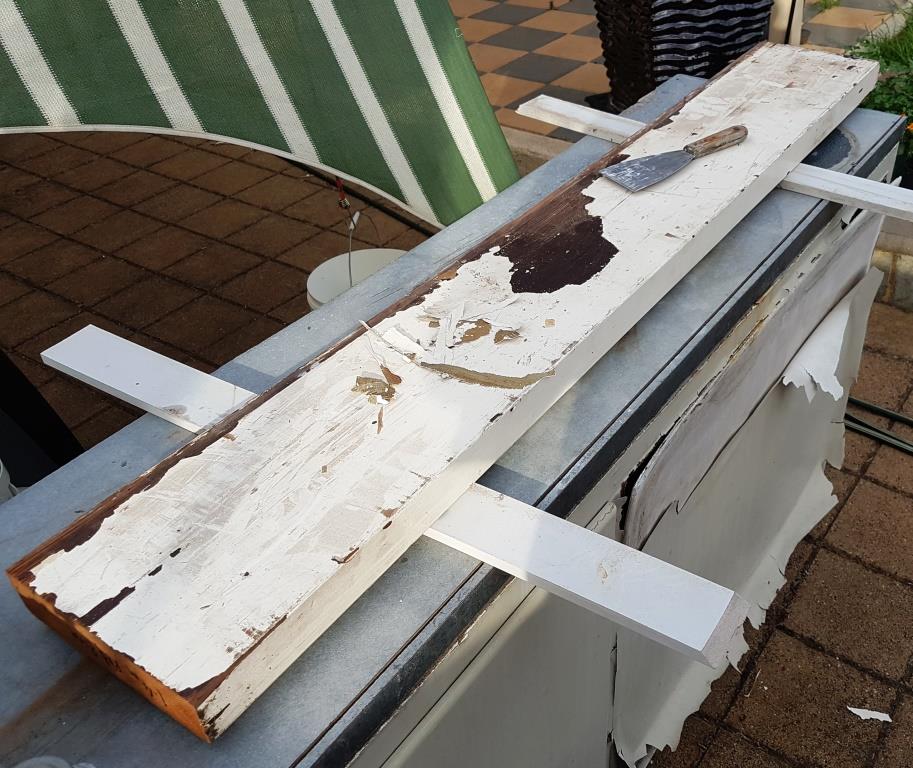

    heres what im talkin bout

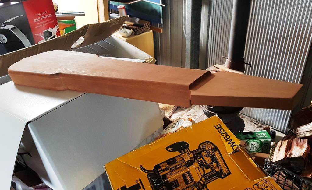

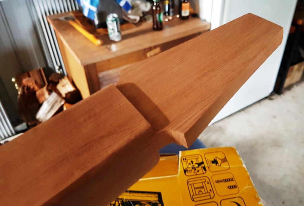

    progressing slowly

  10. #60
    looking good Guvna and good to see a few empty beers ! Is the first pic how the red pine looked at the start ?
    I routed tele control and pup cavities on Popeye's end grain axe yesterday so I'll measure the depths when I get home from work tonight. The control cavity needs to be deep enough for the pot shafts to fit through with some thread for the nut so there will only be 4-5mm of timber left. Bridge pup will be deeper than the neck pup. I'll post the depths about 7:30pm your time
