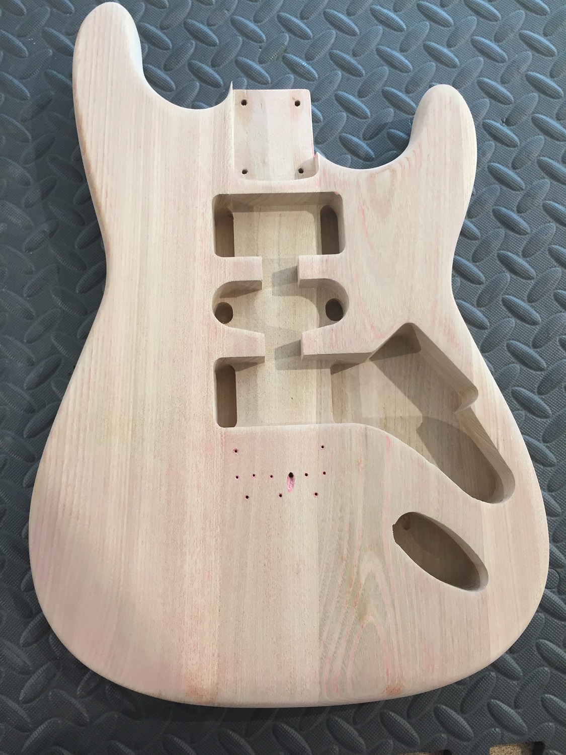

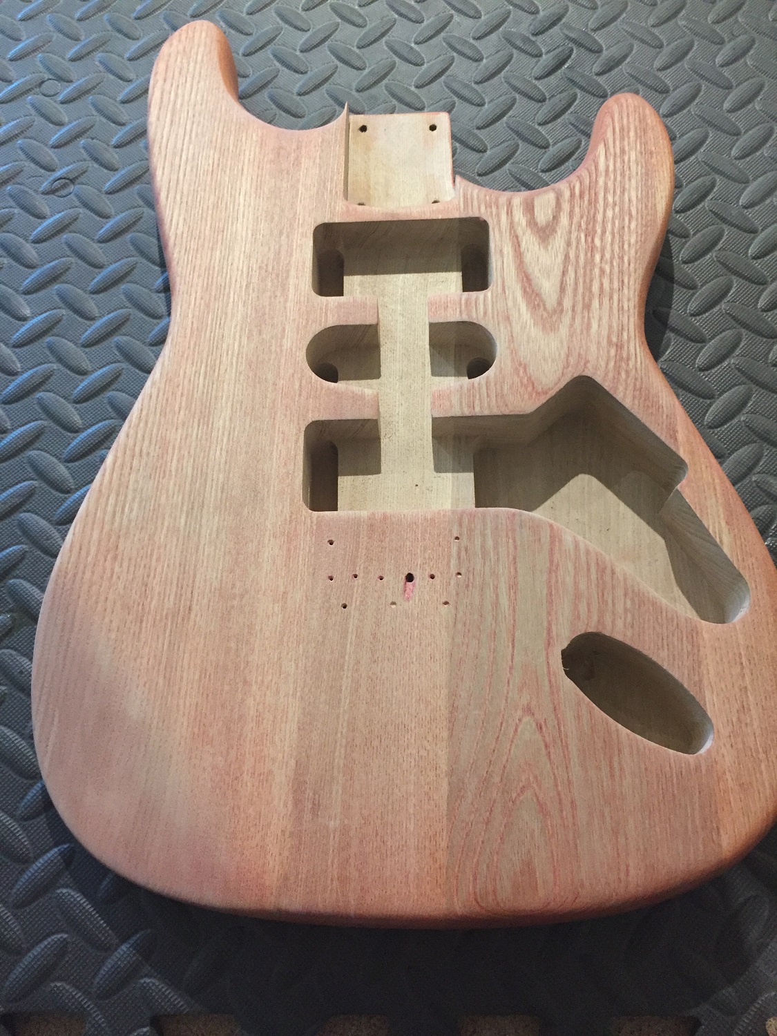

    Update...finally got around to posting some of my progress over the past month.
    After sanding a lot.....I've grain filled with neutral timbermate stained with Karajini red and sanded back. Yes I know it looks pink, but it will get there.
ID:	16539Click image for larger version.
    I then stained the whole body with one thin coat of Karajini red and then sanded back only the front and back to pop the grain for the burst.

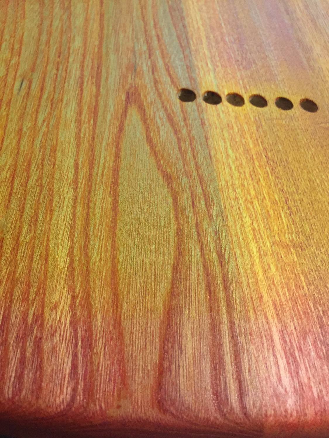

    First coat of the Coolangatta Gold/Karajini red burst with Karajini red grain pop

    Hi Andy, gorgeous piece of Ash you have to work with there and like the innovative red stained grain fill idea.
    Presume it will end up looking like the outer red part of the burst has bled into the middle gold colour once finished?
