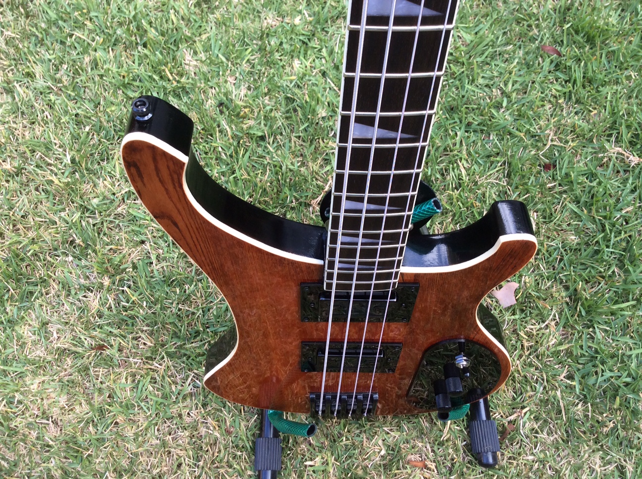

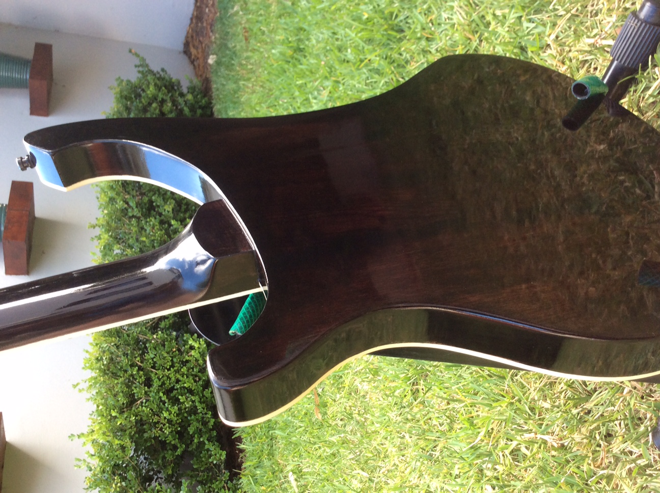

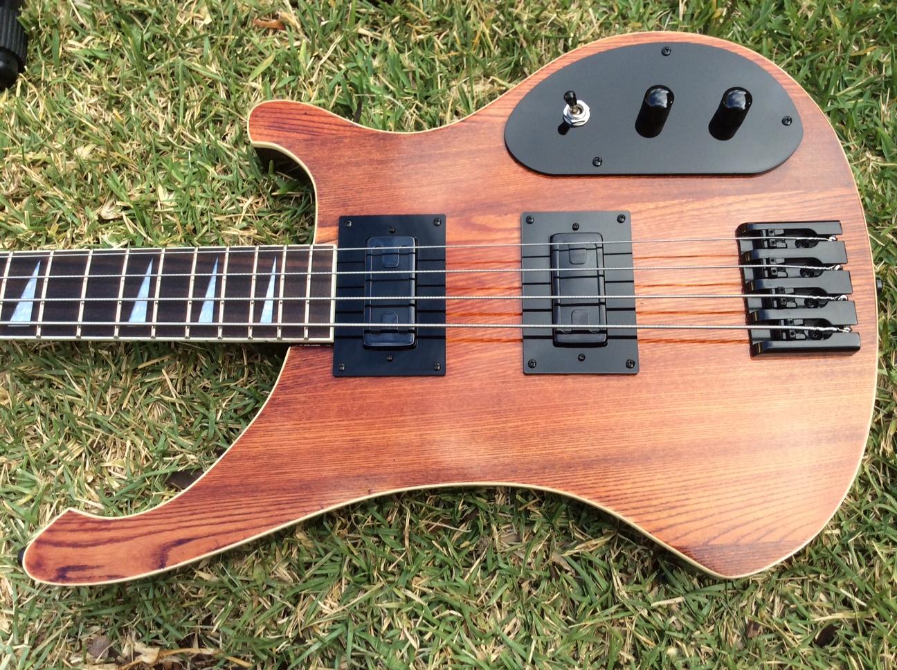

    It is done! Possibly a small argument to go with the bass side of the 5th fret, but otherwise ready to rock!
