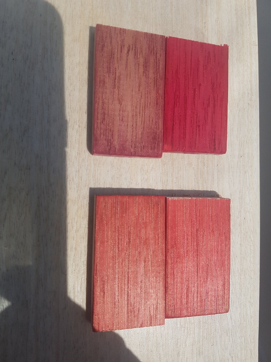

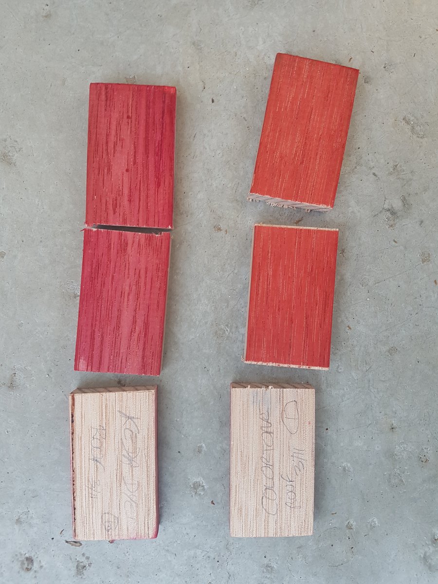

    So I prepared another test to compare Keda dyes with some Colortone to see if any dyes would have the same issue.
    Only leftover colortone I had is red, so I mixed a red Keda dyes mix and repeated the test, with Keda and Colortone.
    Not the same tint as I didn't really try to match them, but both pure red, and as before I kept a reference in the dark in my garage while I exposed the other part.
    Before (Keda on the left, colortone on the right):
    And after a month (Keda at the top, and colortone at the bottom):
    They both lost some colour, but the Colortone resisted a lot better than the Keda dyes...
    So Keda is out...

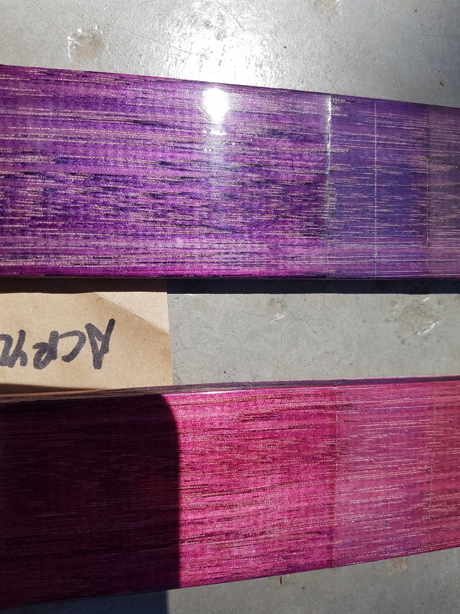

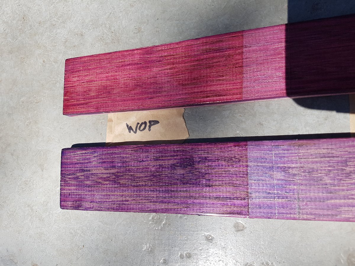

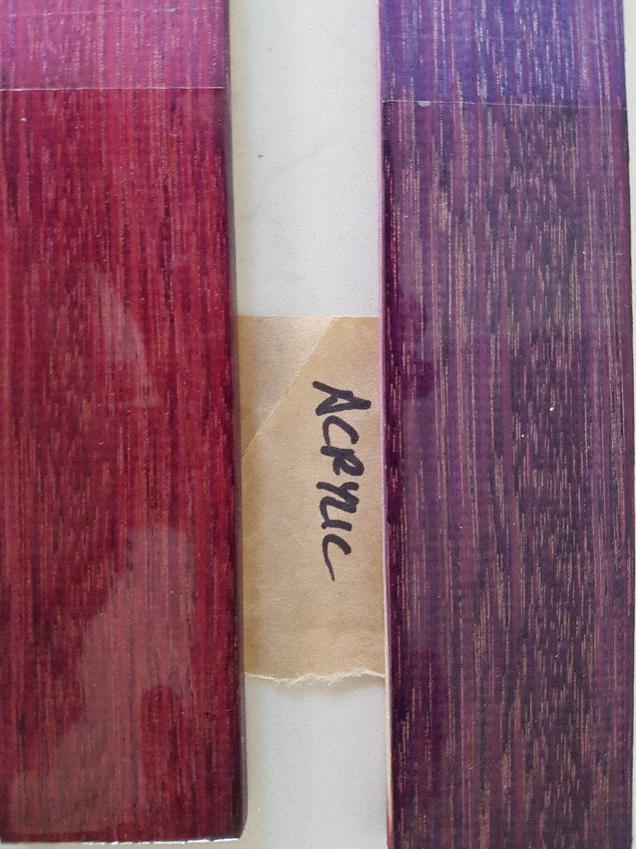

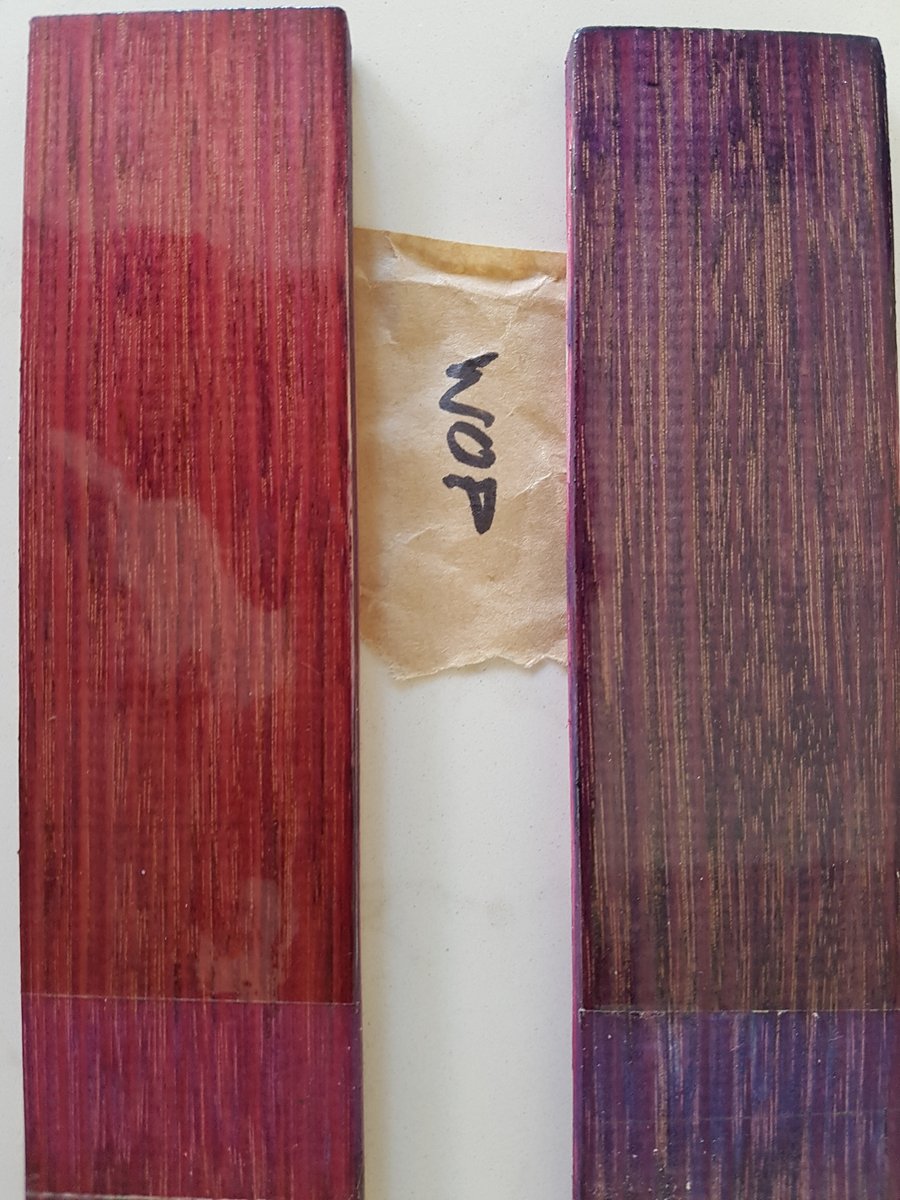

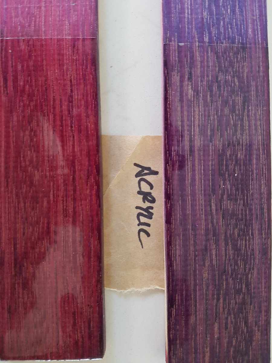

    I ran another test, checking how finish would affect the colour.
    I had spare tinted samples, a magenta and a purple one. So I finished a third of each with Feast & Watson Oil based wipe-on poly, another with leftover Dingotone top coat, and the last third with White Knight Clear gloss Acrylic.
    I then polished them and compared with s trip I had left bare of finish.
    Here's Wipe On Poly outside and inside:
ID:	15499 Click image for larger version.
    And Acrylic, same outside and inside:
ID:	15502 Click image for larger version.
    The wipe on poly being oil based did give it a bit of a yellow tint, but it's actually not too bad. The photo taken inside makes it look a lot worse than in real life.
    I much prefer Wipe on poly to the White Knight acrylic. It never got hard enough really on my first blue strat, while the WOP I used on the red strat is rock hard in comparison.
    So I'm going to go with Minwas water based wipe on poly. I'm hoping I'll get the benefits of the poly, but with a 'clearer' result than oil based.

    Now that the Star Wars strat is finished I'm getting really started on the SG.
    First here's a pic of my test comparing Keda dyes and Colortone.
    The top bits are the references, the bottom ones have been exposed to UV since 3/11 so a bit more than 2 months
    Looks like the colortone are a lot more lightfast!
    Anyway, that was only to close the experiment as I'm planning to use purple and magenta inks now.
