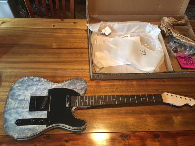

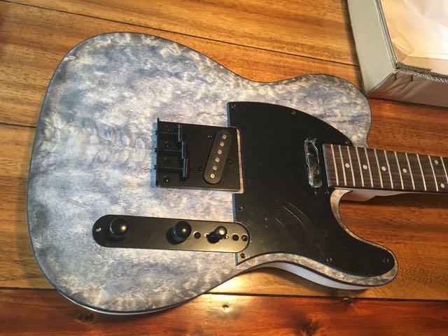

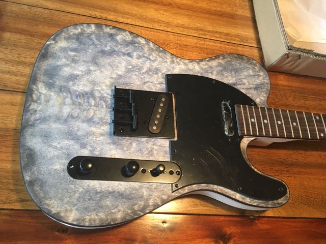

    This is as far as this kit got ... you will have to imagine the sides and neck in Dingotone Black Stump and the face of the headstock in Same blue as the body . R.I.P.
    Now it is winging its way back for a replacement.
    End of this thread.
