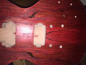

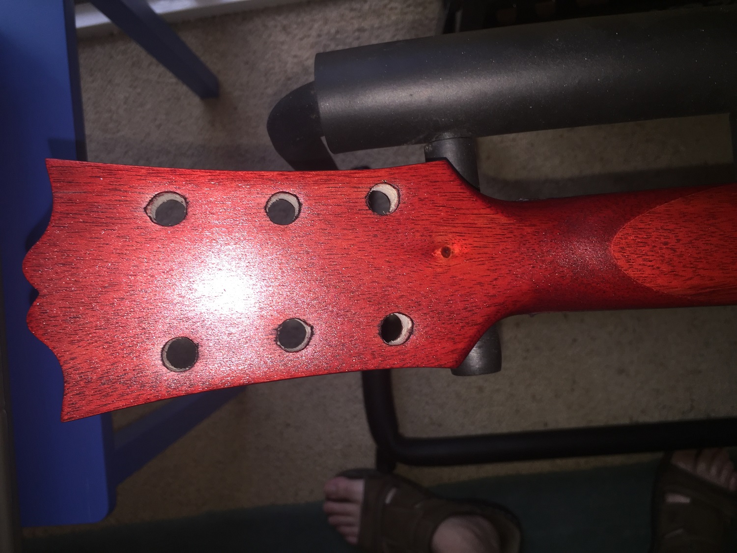

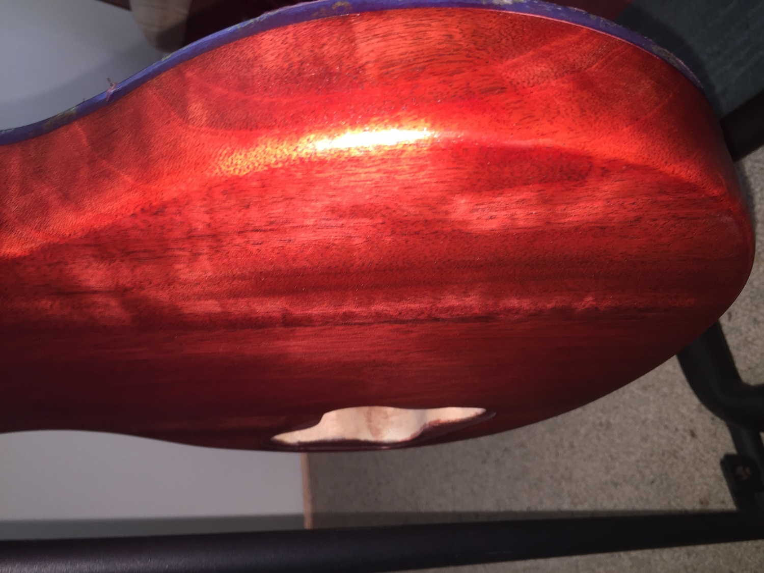

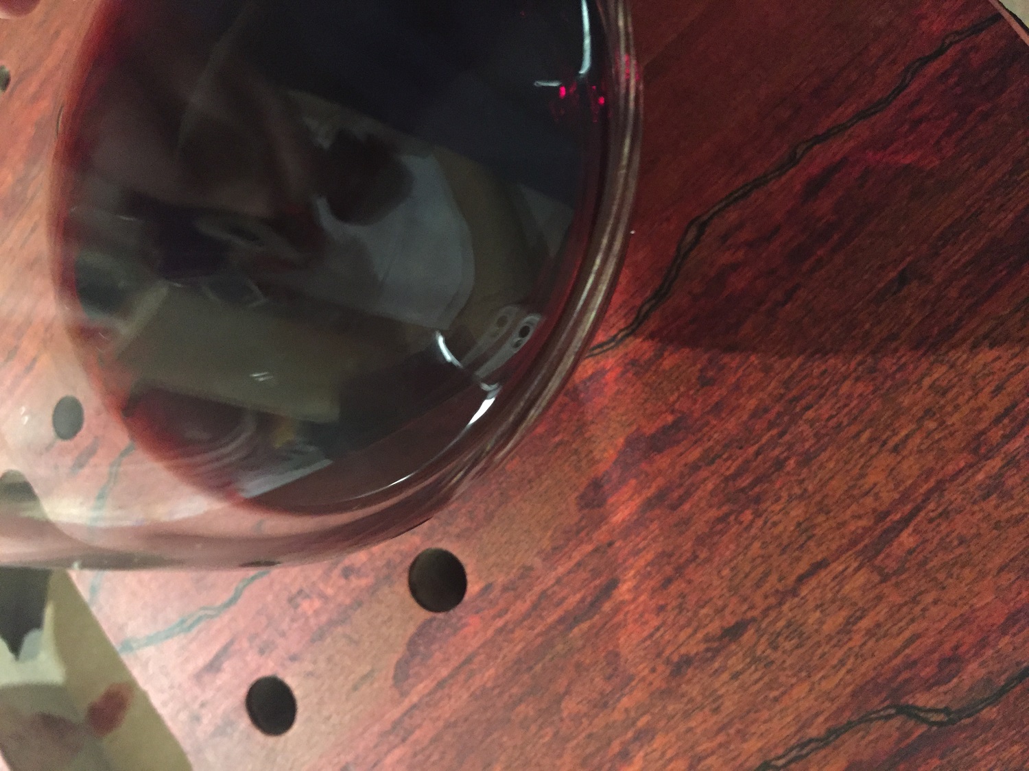

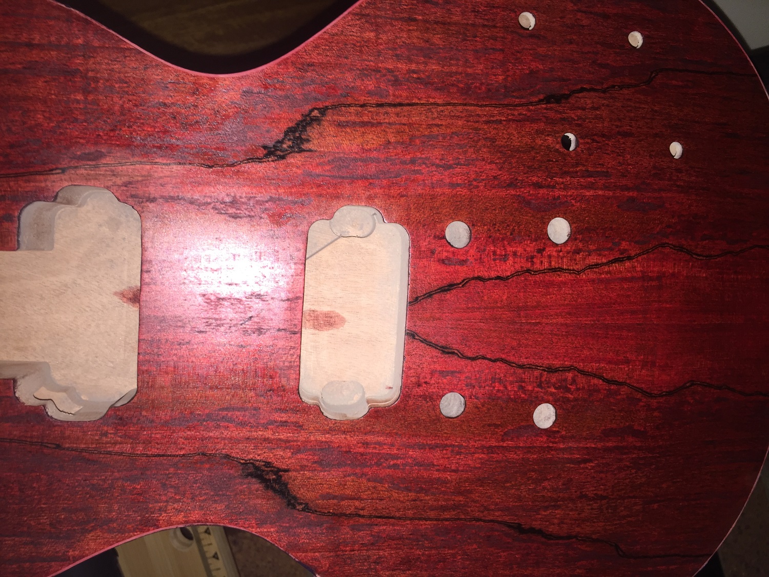

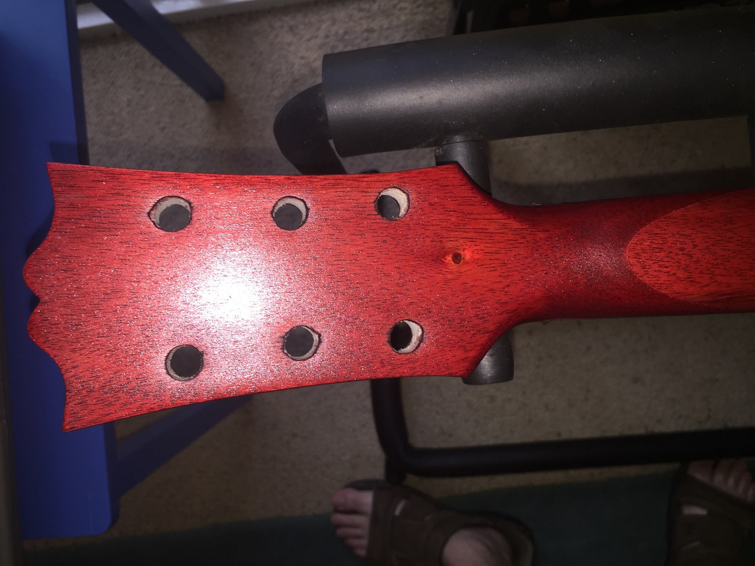

    Update
    Research
    First stain coat (3 clear days curing) - colour comparison only (no red wine was harmed during the research - I cannot not confirm or deny that any wine didn't perhaps become savored and/or consumed.
    Test results: further stain needed
    Action taken
    No steel wool or sanding - still looks like plenty of tooth there. One further coat of DT Karajini Red applied to entire body and neck all over. (I have enough left in the bottle for one more coat on mahogany only)
ID:	7117Click image for larger version.
ID:	7118Click image for larger version.
    Further Action needed
    See you in three days time

    looking excellent Andy, you must be happy with the colour now
  13. #60
    I agree, but one more stain on mahogany I reckon she'll be perfect.
