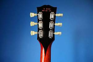

    Else what you could do is a "stinger" stain job, Click image for larger version.
    but you are still going to have to mask that off on the neck anyway.
    If you try the face first, if it doesn't work out, you can rough the headstock edges back to about 180 grit and try for the stinger.
